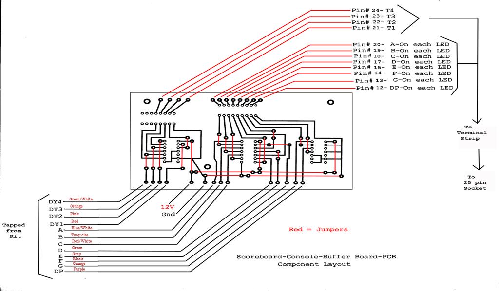

For the last year > I have been struggling to build a scoreboard for my son.
My son is a coach at a high school and he asked me if I could build him a scoreboard for his wrestling team.
I decided I'd try it, but fast got bogged down and went to the "other" forum first (All about Circuits), looking for help.
And, I did find help, mostly if not almost entirely from one person there. He's an amazingly informed individual and has practically hand fed me for more than a year now.
However, I know that I have become an absolute pest over there, especially to him. Now I suspect he has finally washed his hands of me, and, I guess I can't blame him.
I'm almost done with this scoreboard, just got to figure out what's wrong with the conversion from the console (small unit containing everything that works pretty much perfectly) through the 10ft cable to the big board.

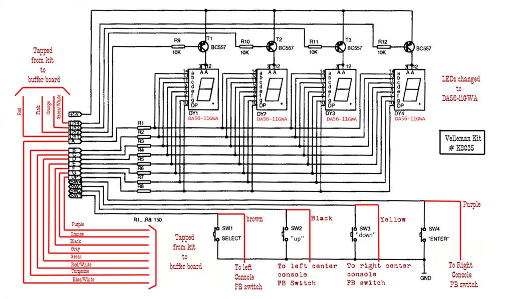

I found Mr Gibbs's aid (thread) to the fellow concerning the exact same kit that I was using (Velleman-K8035)."Multiplexed signals to drive large 7 segment LEDs"
And this person on the other forum helped me with the buffering to transit the 10ft cable.
I have just today gotten it all fabricated and wired up, turned it on and, is sorely not working properly, have troubleshot it to death and just can't see any reason it doesn't work properly, but, it doesn't.
I'm so embarrassed to have aggravated this individual for so long over there with my constant problems, and having him finally cross me off, I'm just at a loss to know what to do after investing so much time and money in this thing.
Am taking a chance reaching out to you guys for my final need, getting the big board LEDs acting correctly, I certainly don't desire to aggravate anyone else to death.
This thing is just so close to being finished, and I'm so lost....
If you happen to have the inclination to take a look at my drawings I'd certainly appreciate it, and would fully understand if you chose not to mess with it.

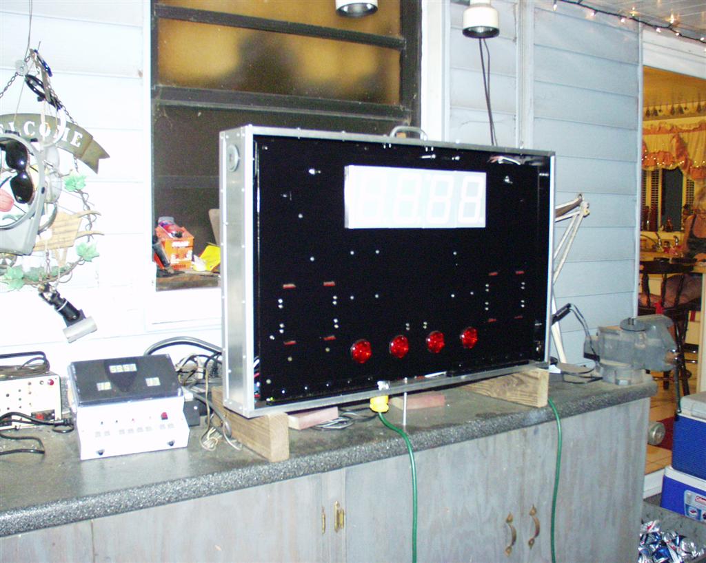

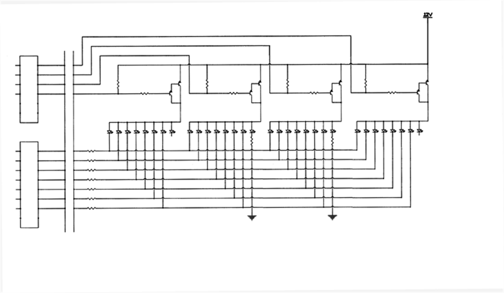

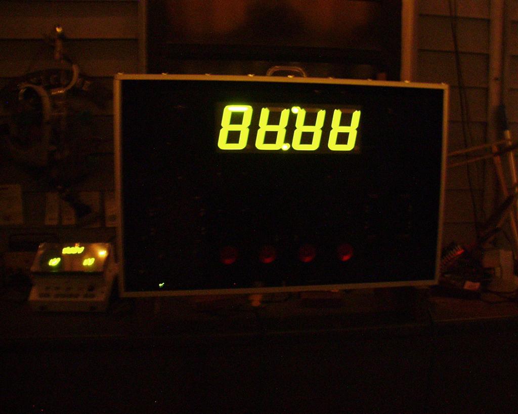

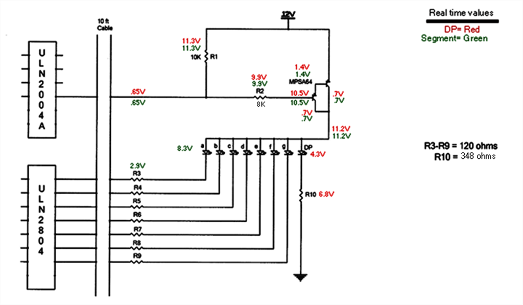

And here are a couple more Pics...
The drive transistors for T1-T4 are MPSA64 Darlington's.
The real time values were done breadboarding one LED segment and DP, etc.
And the problem is, the LEDS almost light, but are dim, and don't even try to follow the console clock LEDs.

Yep got voltages everywhere they're supposed to be.
I had at one point exchanged the one LED where the "a" segment was lit up with another, and it lit up in the other spot, suggesting that the other LEDs were burnt out, pulled all LEDs out and checked them, they all check out OK.
Then checked all the sockets, cleaned all the LED pins......
How about this -> I disconnect T1 (Thousands digit) power (the one with the "a" segment lit) and ALL the other "a" segments light up !!!!!
Actually the one "a" segment is running at 31ma, a little high, but I figure that's because the others are not pulling current.
The other segments look bright in the photo (in the dark), but are only running at 4ma, they're almost indistinguishable in the daylight.
And the main thing, I see no replication of the console clock LED operation at all.
They just almost work, but flat out don't change states to mimic a constantly changing clock operation.

hi oxbo,
Whats the specification of your power supply.?
Going thru the dwgs now.
EDIT:
I believe the Velleman kit output drive signals are TTL levels.???
On the buffer pcb you show 74C14 inverters using a 12V supply...??
Can you confirm this point.??
EDIT2:
Which end of the 10 ft cable is the buffer pcb.?

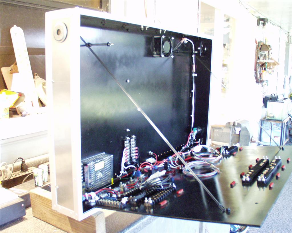

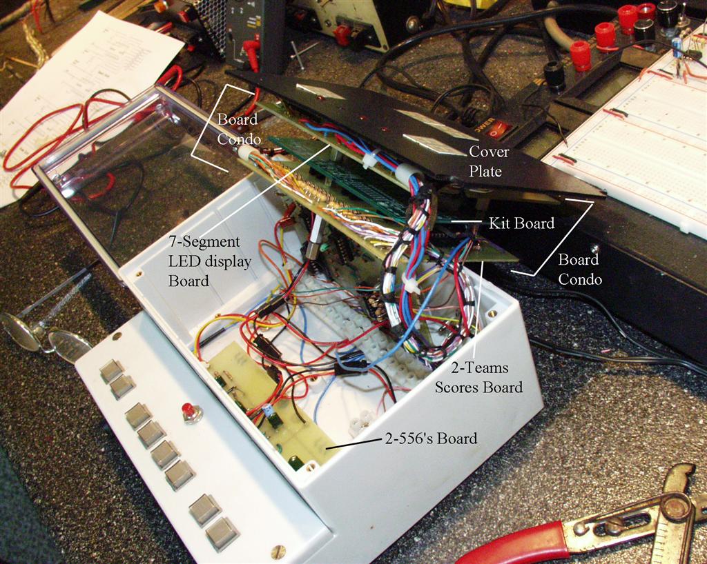

Buffer board is located two boards below the kit board in the console.
Attached is pic of inside of console, the Kit board, then the 2-teams scores board, and the next board would be the "Buffer" board, but I had not installed it when the pic was taken, etc

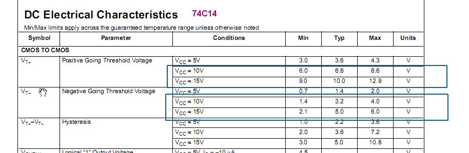

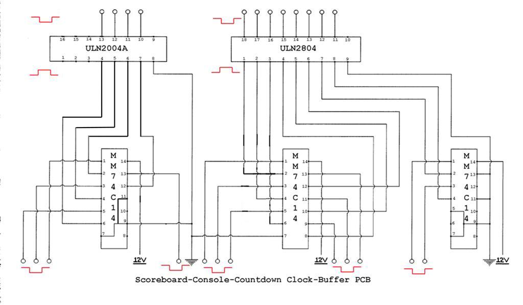

Look at this image, you can see the 74C14 input levels for a Vcc of +10V, for +12V they are even higher/
Power the 74C14 with +5V, not 12V,
The ULN 's are CMOS compatible so the 74C14 will drive OK.
Do you follow OK.?

As you are using 5V logic from the Velleman, the ULN2004 should have been ULN2003 and the ULN2804 should be ULN2803.
You cannot level shift the 5V logic levels to say 12V using the 74C14.
I will keep going thru your drawings, but I can already see why you are having problems.

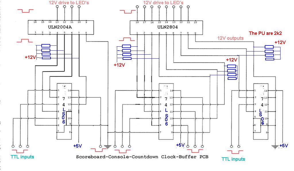

I think we can exchange the 74C14 for a 74LS07 and so keep the ULN's as they are now.
You will have to add a pullup resistor to +12V to each of the 74LS07 outputs and supply the 74LS07 with +5V, thats no big deal.
If you look at that link you PM'd me, you can see that we used the 74LS06 which is a non inverting version of the 74LS07.
I will post a drawing tomorrow showing how to rewire that section.
Us old guys have to help out you young Uns.!:rolleyes:

For the two 74LS06 the existing 5V should be OK.
BTW: I assume you have a Velleman 0V line connection to the 12V buffer pcb 0V.

hi D,
The output from the Velleman pins are active low [0v], so the low on the 74LS06 input will set the output high, this high when connected to the ULN's input will set the ULN's output low.
So the LED Anode driver will be enabled, connecting the anode to +12V.
Also the for the Segments, when the segment is pulled low it will light, providing the LED's anode is enabled.
The basic problem with the existing 74C14 is that its powered from 12V, so the input required to enable to turn on is approx 7V, which the Velleman cannot deliver as its a 5V system.
I suspect someone had the the idea of using the 74C14 as a level shifter 5V to 12V, but it will not work correctly.
The 74LS06 even though its TTL level inputs has a high voltage o/c output which is going to be connected to +12V, so its a level shifter.
Are you now unconfused.?:)
