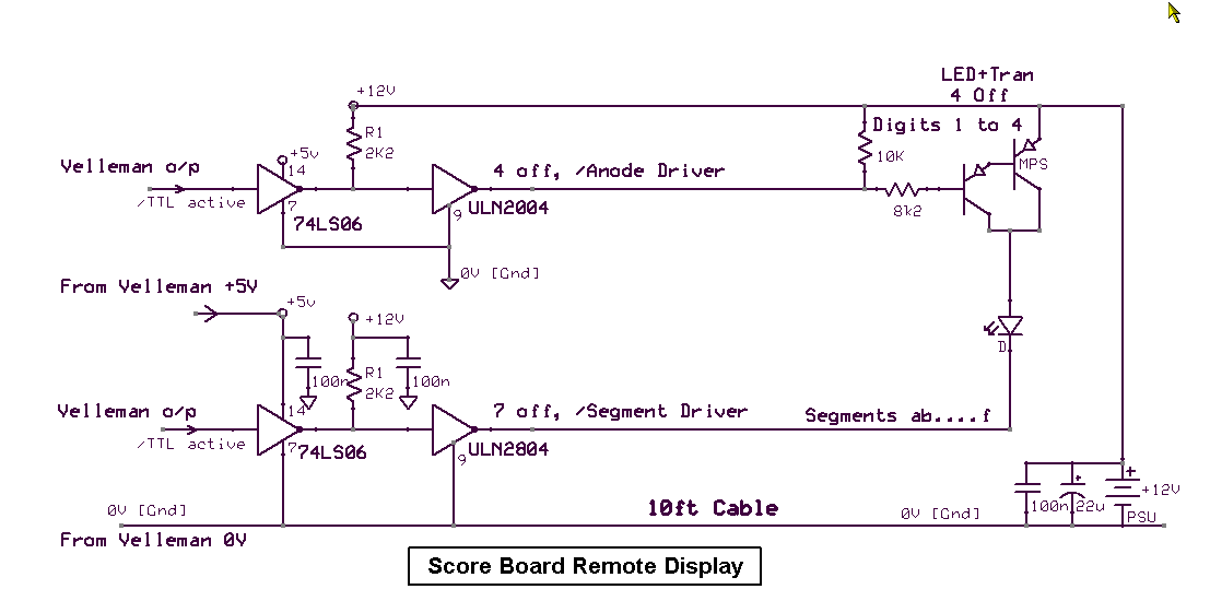

hi oxbo,
Can you follow this circuit OK.?

Yes sir I understand your drawing.
Yes, all 0V/gnd's are common/tied to everything proper.
Will take me a few days to get the new configuration put together.
Got to find some 74LS06's.
We have a wonderful Electronics Surplus store in Orlando (Fl), might have to run over there and see if they have any.
So, will get back with you when I get it going again........
I think what I'm going to do is modify the existing buffer PCB to where I isolate the 74LS06's pwr,
then make a new PCB to contain all the caps and resistors, and just solder the new lines in onto the existing 74LS06's outputs...

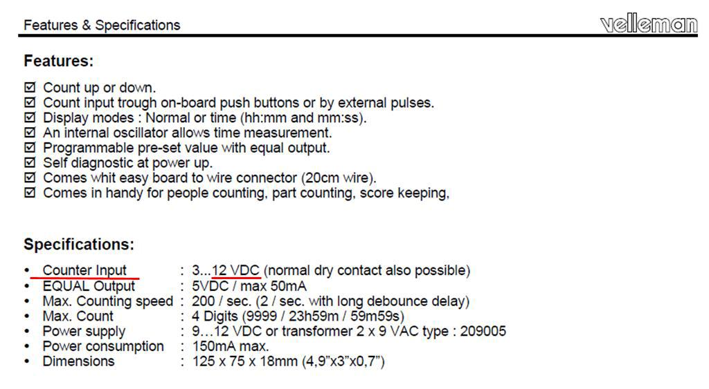

MrDEB see attached....

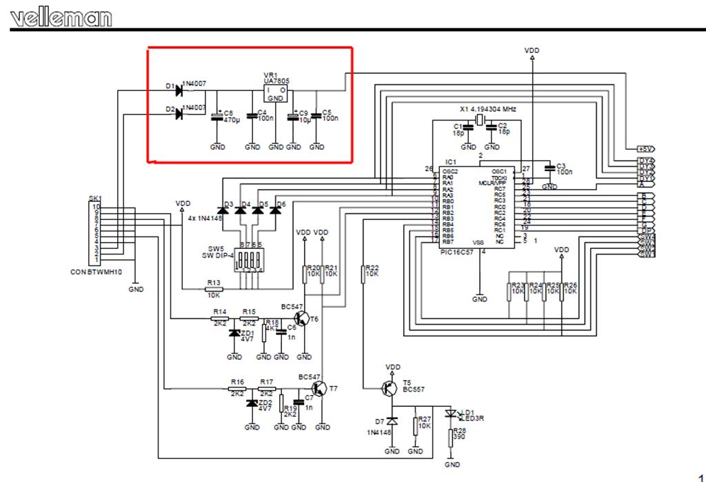

you said the drive board is working fine, hope you tested it with the 7segment supplied by the kit maker.
if that part is right then what you are stuggling with, is to interface your large display.
5V may not excite enough voltage for the large display LEDs.
out puts A,B,...G , DP, DY1..DY4 are current sink, your buffer must be able to handle it,
if you have seriesly connected the LED in your display, then use a paropper voltage source only for the display and change all resistorsR1-R8 to limit the current (30mA), i beleive no need to use a buffer circuit, if i have understood it correctly.

Am using 12V to drive the big LEDs via MPSA64 Darlington transistors (see previously attached pic), kit works great.
Big LEDs require 8.8V @20ma (DP = 4.4V @ 20ma)

The 74LS are lower power than the standard 74 series of IC.
I would try the 7406's in the circuit, if they load the PIC pins too much it will be necessary use 74LS06.
If you have any 14pin IC pcb style sockets I would fit them on the buffer, if you do have to change over the 06's it will be easier.

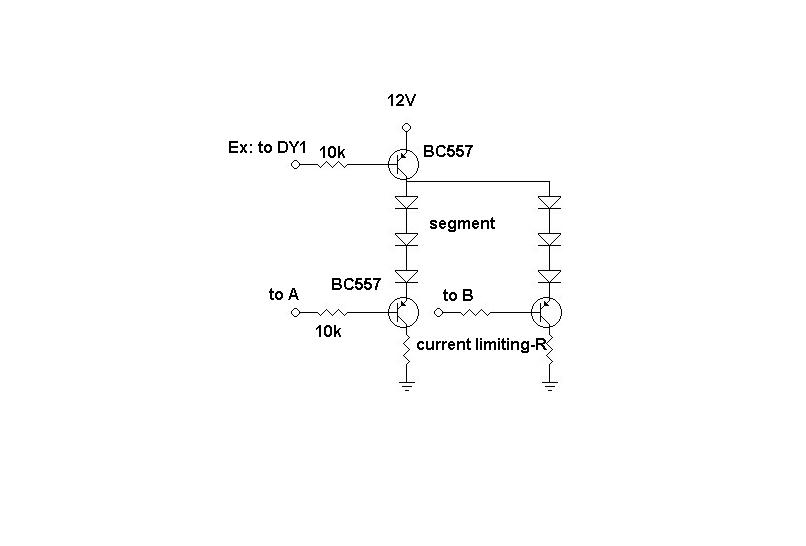

i think you can go for simple transistor buffering and get it done, i have just drawn an example how it can be, hope it might work. just see the attached.
As the PIC outputs are 0V and +5V levels, the transistors cannot be switched off.:)

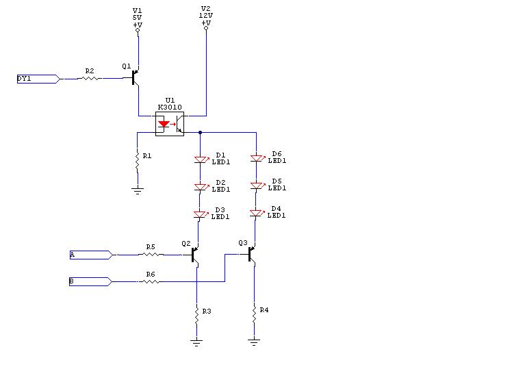

i missed that point :p, so what about using a photo coupler like K3010? the transistor output can be like a switch. DY1...3 and A,B... all can be wired to each photocoupler input. it can drive 20mA directly.
If you connected the opt coupler emitter from the PIC pin to 0v, via a resistor then when the PIC pin went low [active] the opto detector would switch off, so the signal would be 'inverted'.
I think the choice of ULN's was a good idea when you consider the ULN is driving a 10 foot long cable.
If the remote display had been close to the Velleman pcb I would have used a 74LS07 as per the previous thread.

I believe the easiest way is by switching the inverter chips and their 12V pwr to 5v pwr.
Then adding in the resistors/caps (on a little separate board that I fabed up yesterday).
inverting it before driving the photo coupler is not a big deal. any how lets see what OP ends up with.

only four opto couplers can be used as shown with an inverter at the input, it can be one of the option for you incase if you couldnt solve the problem you have

The problem with 'mbarazeen's circuit, is that you cannot turn OFF the lower transistors.!
