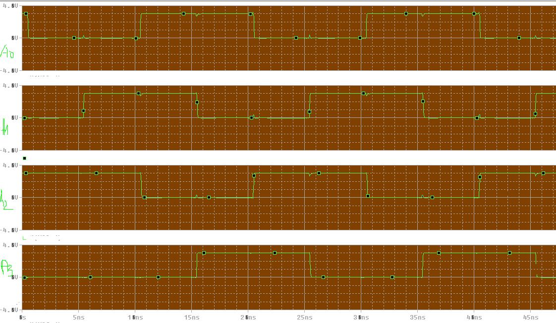

Help with non-overlapping clock generator
I tried everything you said,but I always get overlapped clocks.
I don't where is my mistake.I am desperate.
I can't get non-overlapping clocks.
Can you help me with that,I need that for tomorrow?
I'm out of ideas.
I'm out of ideas.

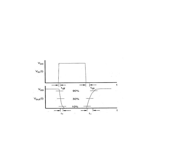

Who told you that? Can you provide a link?
Propagation delays are separate from output transition times, and may or may not match the equation you posted. It all depends on the internal circuitry and the complexity of the gate.
I agree with Ron. Rise and fall times may contribute to delay, but a circuit can certainly have a much larger delay time then the rise and fall times, it depends largely upon the amount of circuitry been the input and output. Look at the difference been an inverter delay and a flip-flop delay, for example.
tpdr : rising propagation delay
– From input to rising output
crossing VDD/2
tpdf: falling propagation delay
– From input to falling output
crossing VDD/2
tpd: average propagation delay
– tpd = (tpdr + tpdf)/2
tr: rise time
– From output crossing 0.1 VDD to 0.9 VDD
tf: fall time
– From output crossing 0.9 VDD to 0.1 VDD
tpdr=1/2*tr
tpdf=1/2*tf
Simple CMOS logic gates and inverters can approach the performance of your diagrams. More complex gates, like 8-input gates, e.g. CD4068, exclusive ORs, etc. have internal circuitry that contributes to delay. Even NANDs and NORs have internal buffering that contribute to delay.
TTL gates have delay that is due to storage time, which is totally independent of transition times.
Your drawing is much too simplistic.

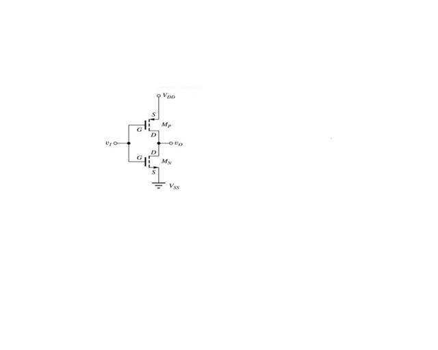

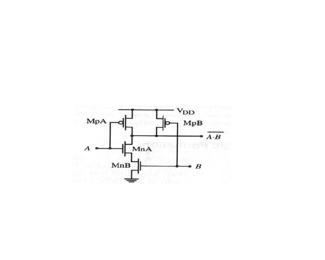

I tell you that I don't know type number of cmos logic gates,
and I don't need that.
I 've done simulation in ORCAD PSpice.
I draw CMOS inverter with 1 p-channel MOSFET and 1 n-channel MOSFET.
CMOS nand gate is consist of two serial n-channel MOSFETs,and two parallel p-chanell MOSFETs.
Certainly a simple two transistor inverter has very little delay time as compared to the rise and fall times. But delay times can be much larger than rise and fall times in complex circuits. They are not the same parameter.

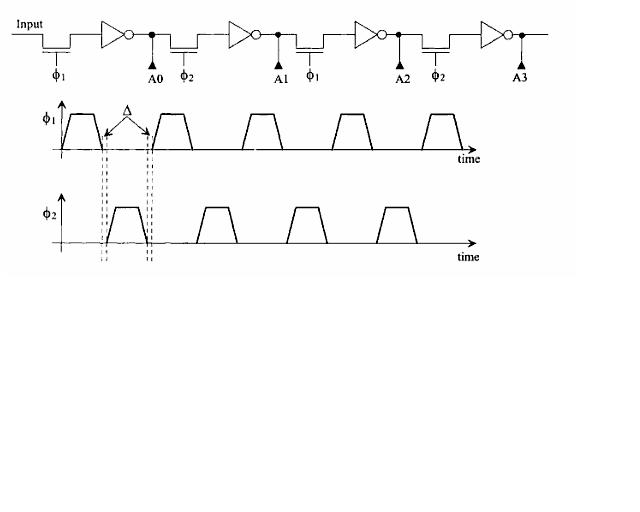

Do yo know why in dynamic shift register non-overlapping clocks are used?
Or why this circuit doesn't work with overlapped clocks?
There are parasitic capacitors at the gate inputs that act as hold capacitors. Each clock samples the output of the previous gate. If the clocks overlapped, data could shoot through all the inverters during the overlap time, or at least degrade the logic levels held on the capacitors to the point where errors would occur.

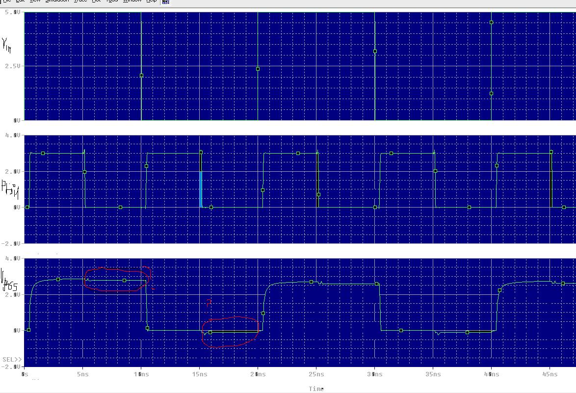

Do you have any literature about pass transistors?
These are my diagrams.The third diagrams is at the output of pass transiastor.
Why is happening when Phi1=0,Vin=Vdd and Phi1=0 and Vin=0?
That is the result of the clock coupling through the parasitic capacitance of the pass transistor, transferring a little charge to the hold capacitor. It's a capacitive voltage divider.
