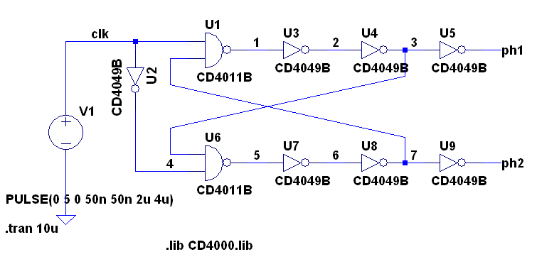

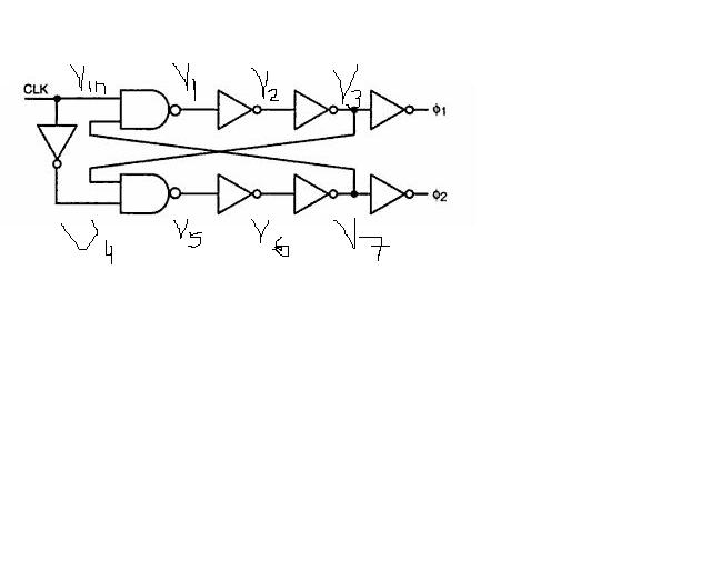

Hi everyone!
Does anyone know to help me with non overlapping clock generator?
I need to draw how non-overelapping clcks are made?
I tried that but I can't get non-overlapping clocks.
I need to draw signals at the output of each logic gate in this circuit
Actually I need timing diagrams for Vin,V1,V2,V3,V4,V5,V6,V7?
Logic gates are realised in CMOS technology and all logic gates have some delay.

Thank you but I need to draw this circuit on the paper,actaully
I need to explain how non-overlapping clocks are made,so I must
draw that without LTSpice,Pspice...?
What I ment I don't know how much is delay for each logic gate.

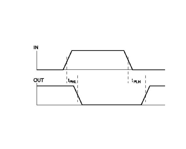

Gate delay is a function of the logic family, or if you are designing an IC, the process. For commercially available gates, look up gate delays in datasheets.
I think that you don't understand me.I need an explanation why
these clocks are non-overlapped? I don't know what device are used (by type number),
I only know that all logic gates are realised in CMOS technology.
So I don't know how to draw signal at the output of first NAND gate,actually why on the diagram
you were posted rise time and fall time (tphl i tplh are diffrent) of signal V1 are diffrent,but
rise time and fall time at the output of the inverter are the same?

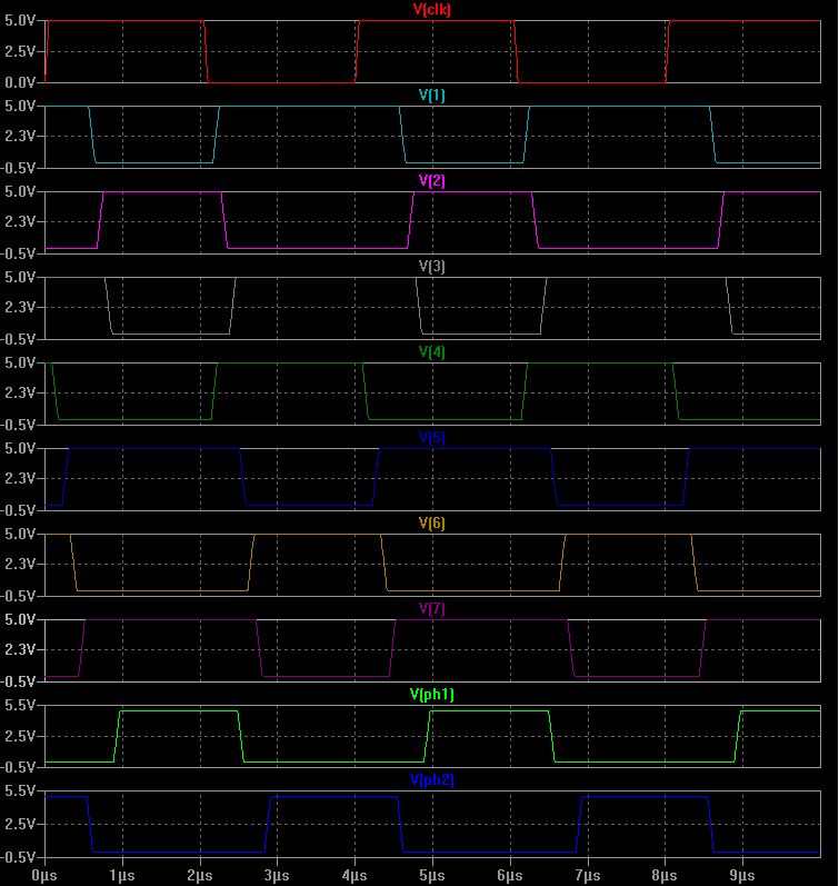

NAND gate rise and fall times in this simulation differ by less than a nanosecond. Exact transition times are not very important when analyzing this circuit. Propagation delays are the relevant numbers. The ones shown in the simulation are from models, and may not accurately reflect the datasheet values.
If you were not given part numbers, I would think you could assign arbitrary propagation delay specs, and then analyze the circuit based on these specs. Alternately, pick a logic family, like CD4000, or 74HC, or whatever, and use those specs to analyze the circuit.
My schematic has part numbers. The datasheets of these parts have propagation delay and transition time specs. What else do you need in order to analyze the circuit? Do you know how to analyze the circuit?

Start the analysis when the clock goes low. Why? Because this will force node 1 low, independent of the other input to U1 (node 7).
Plot nodes 2, 3, and 4.
Calculate node 5.
Plot nodes 5, 6, and 7.
Calculate node 1.
Repeat the process.

In your simulations pulse width logic 1 of signal V2 is less then pulse width logic 1 of input clock V(clk)?

First, let's agree that Tpd is the value of the propagation delay.
When the clock goes low, node 1 will go high Tpd later. Node 2 will go low Tpd later. Node 3 will go high Tpd later, etc. Just proceed through node 7, which goes back to Q1. You will find that node 7 goes low. This means that node 1 will not change immediately when clk goes high. Q6 WILL be immediately affected when clk goes high. Trace that transition through nodes 5, 6, 7, etc.
