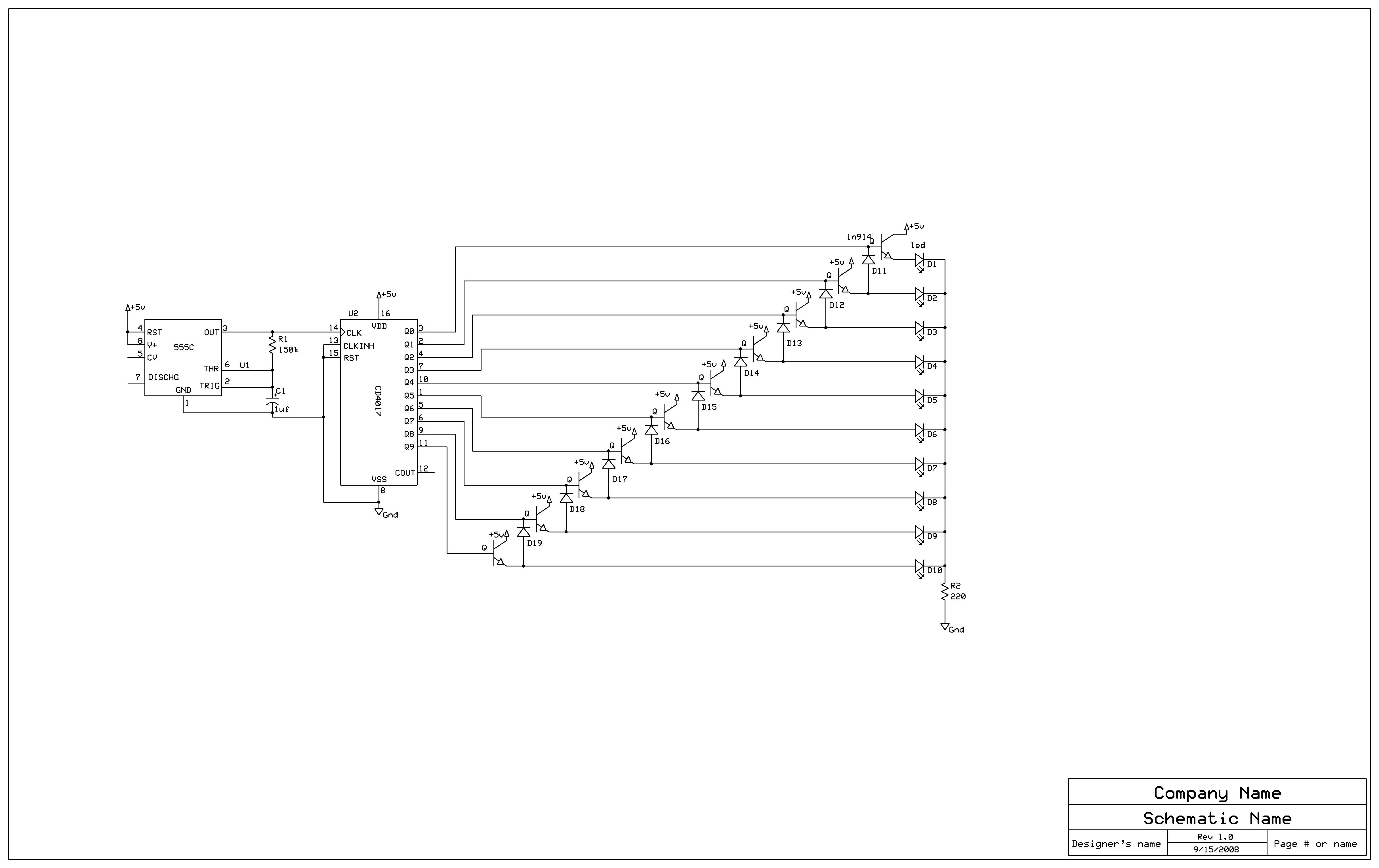

Mazikowski,
I forgot about the voltage drop on the diodes, sorry. I would suggest then to install the diodes in a staggered between each transistor. same amount of parts just a change in the schematic I am at work I will redraw it when I have time and repost it.
Mazikowski,
Here try this its has the same amout of parts the original had but allows for the voltage drop on the diodes.

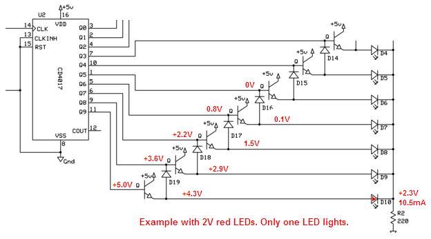

Your circuit has too many diode voltage drops.
Emitter-followers don'r switch, they follow so when 10 LEDs are supposed to be lighted then the 10th gets 4.3V from its transistor, then each LED gets less voltage.
The 9th LED gets 3.6V, the 8th LED gets 2.9V, the 7th LED gets 2.2V and the 6th LED gets only 1.5V. LEDs 1 to 5 get less voltage.
The voltage to the LEDs is also reduced by the voltage across the 220 ohm resistor so this circuit won't work.
It might work a little better if the transistors were switches instead of followers.
So what if you took the diodes and put them between the bases on the transistors (like the first diagram, but on the other side from where they originally were)? I'm liking the shift register idea...
My circuit rases the voltage back up to 5 volts each time it switches the next transistor down the line so each LED gets 5 volts. voltage goes through the diode turns on the upper transistor the 5 volts gets dropped to about 4.3 volts but stills is enough to turn on the upper transistor.

no it doesn't... voltage followers cannot "raise the voltage back up to five volts" as you claim in a later post.
No.
Your transistors do not switch because they are emitter-followers. The emitter voltage is 0.7V less than the base voltage.
Each diode reduces the base voltage of the next transistor by 0.7V.
With the 10th LED lighted then none of the other LEDs will light.

So would it work with the diodes between the bases on the transistors? This circuit is going to be powered by 12v, if that makes any difference.

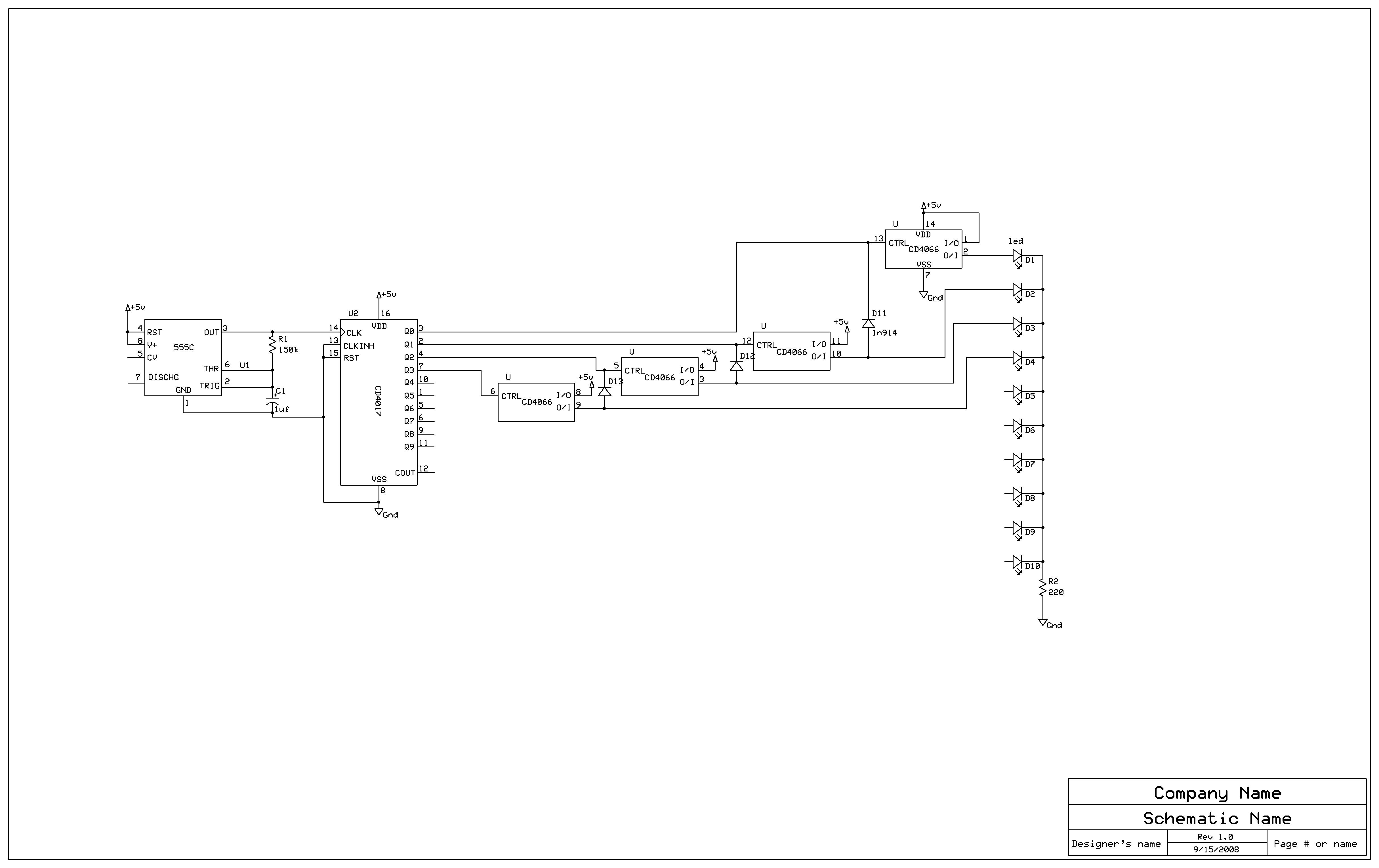

If I used 2 8bit shift registers as previously suggested, would I be able to use something like this:
where U1 is a CD4011 NAND gate. Only, instead of using the 4017 Decade Counter, use the 2 shift registers connected together...
That works accept you want a resistor for each LED and the last output to the reset.
Then the last LED will never light.
The CD4017 counts to 10 then automatically returns to 1.
You forgot what he is trying to do: keep the lower lights lit until the cycle restarts.
he was also looking at two shift registers to do it, the single was just an example of the idea for commentary
