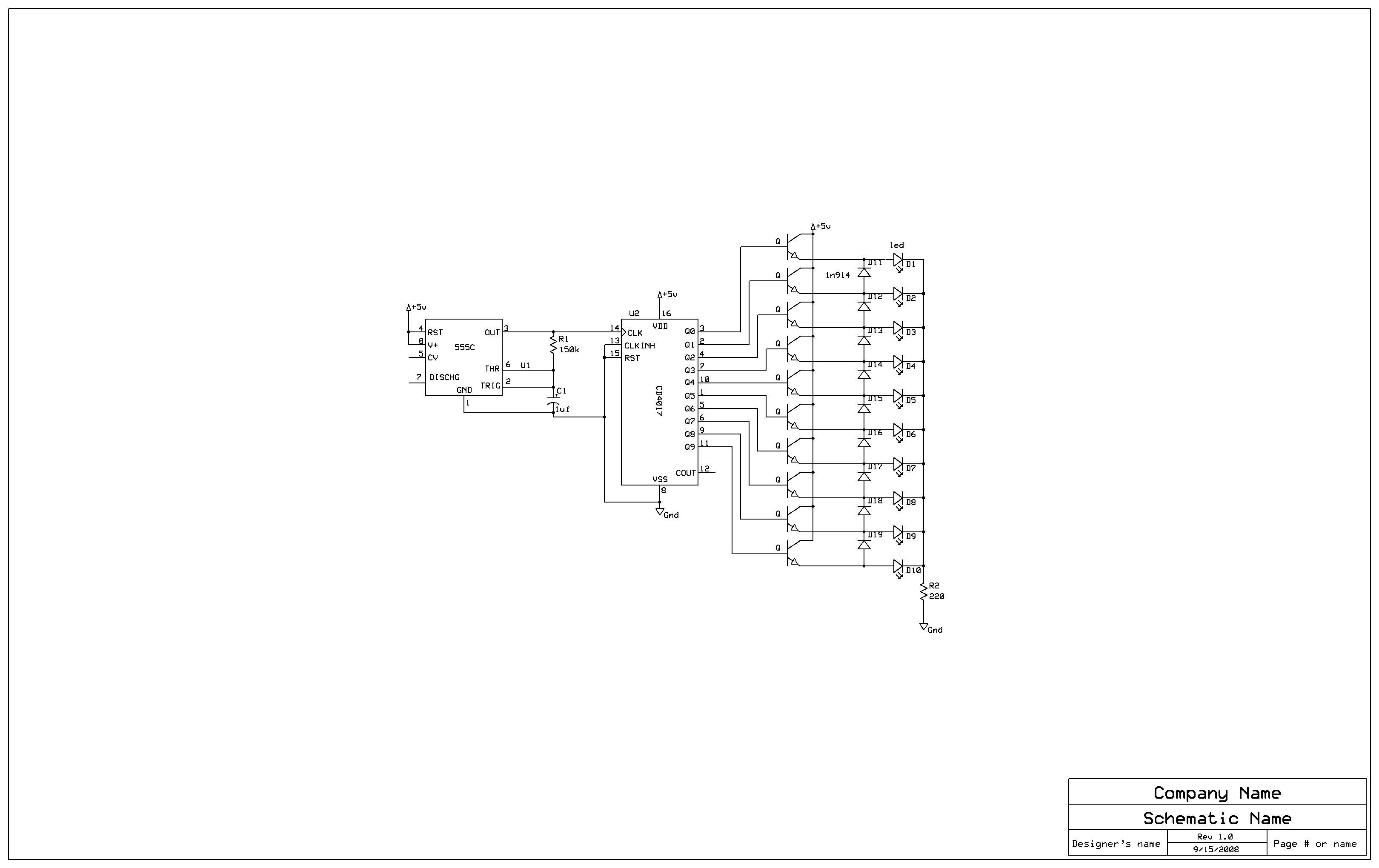

Hello Mazikowski,
I basically used the circuit you describe and added diodes to feed the prior LEDs as it pulses along and the 555 should give you the 2 second ramp you are asking for. If you want to change the speed use 1.44/2RC .

It won't work, when the first transistor drives the led it will light.
When the second transistor is driven, the second led will light
but the first one will be off . . . the same goes for all other
transistors. :p
on1aag.
Wouldn't the diodes allow current to flow back to the other LEDs? So when the transistor for 1 was active 1 came on, but when the transistor for 2 was active, power would go to 2, but also in one direction via the diode to 1?
Hi Mazikowski,
The diodes have also a voltage drop, it's possible that the
previous led will light a bit and the driven led will light a bit
less but if the number of diodes increases . . .
And even if you would use "ideal" diodes the current through
the leds would be divided evenly and the more leds light, the
dimmer they will be.
on1aag.
Ah, I forgot about that... Well, would that circuit work if I had it driving relays or other transistors? This is going into a car, by the way. It will be driving an undetermined number of LEDs per channel as well, so I will have to change things around. Each channel would have it's own resistor(s) according to how many LEDs are present.
I primarily need a circuit to trigger the banks of LEDs.
