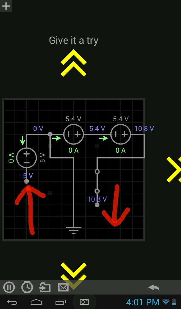

I needed to make a supercap battery bank circuitc with >>5V input connected to, two 5.4V supercapacitors connected in series , and output from supercapacitors with on/off switch.<< Its harder the way I did it
also will i be able to get 10V Vout after fully charging the supercapacitors
Is the switching done manually or automatically?
Is the input voltage for charging the caps always >>5.4V?
Have you considered how you will protect the caps to ensure they aren't over-charged?
Switching is done manually
Input voltageto charge the super caps is 5V (charging it via data cable)
Plus I'm using a resistor on the terminals from datacable for protection
So that the super capacitors will only. Charged up to 5v
But I don't know how to connect the negatives

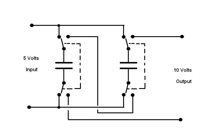

If you're charging from a 5V and want 10V out, you either need a converter to generate the 10V, or use a DPDT switch to change the configuration of the capacitors between parallel (for charging both to 5V) and series (for providing 10V output)
Try connecting it as shown here:
I have used two switches so that the capacitors may be charged individually and then connected in series.

The switch is a "double pole double throw" switch, and it has six terminals.
Have a look at the picture in this link:
https://uk.rs-online.com/web/p/toggle-switches/7346805/
That switch also has a centre-off position, which may or may not be useful, but that type of switch with two sets of changeover contacts.
You will need two of these switches, one for each capacitor.

No, those are two dual switches in there - DPDT aka double pole double throw. You see that dashed line that connects the pair of switches? That is one DPDT switch.
What strikes me here is how you can disagree with something that you clearly don´t understand.
Thank you solo much kubeek and jimb the circuit worked

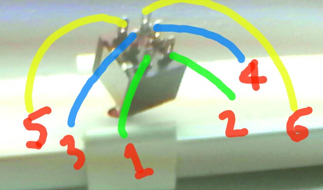

Hey JimB I need you're help ... I'm stuck ... I am not able to connect that double blabla switch with the super capacitors as you mentioned .
The switch has 6 terminals and how should I connect them with super capacitors
Can you please provide a numbered layer diagram
