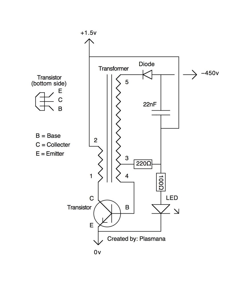

I found this homemade prank shocker with this circuitry and i'm trying to understand how it works.
What is the resistors for? I think the transistor is there to work as a switch to make a variation in current and make the transformer work, but how does it do that? and the capacitor, what's for?

The resistor limits the current through the LED to a suitable value (a few mA). The transistor is indeed a switch, controlled by the voltage generated by the smaller winding on the transformer. The cap stores charge to build up a high voltage from the individual pulses generated by the larger transformer winding.
Thanks for answering. But how will a current flow through the transistor base, to close the transistor switch, since the switch is open from the start? How does the transistor works in this circuit?
Also, what would be the difference in the output without the capacitor? Wouldn't the voltage be the same?

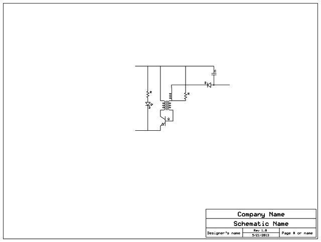

The circuit redrawn should make it easier to understand its working.
The transistor base gets its drive thru the 220 Ω resistor.
The increase in collector current drives the transistor even more thru' the transformer action and continues till the transistor saturates.
At the same time, the voltage at the other end of the transformer is -ve, the diode conducts and charges the 22 πF capacitor with a negative potential.
Once the transistor saturates, the base drive due to transformer action reduces, reducing the collector current and so on till the transistor cuts off.
The process starts all over again.
The grounding of the 22 πF capacitor can be to 0 V instead of +1.5 V; the diode can be reversed for a +ve High Voltage instead of -ve., unless there is some other reason.

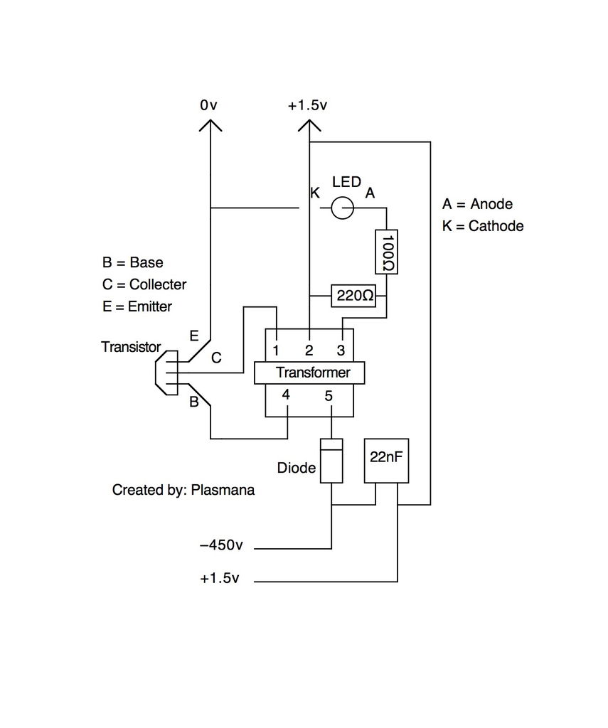

Yes it is the same 5 pin transformer. The pins are 1,2,3 for the 3 pins windings and 4,5 for the two pins windings while in the image the pins are 1,2 for the two pins windings and 3,4,5 for the 4 pins. So, should the transistor base be soldered into the first pin from the left of the 2 pins side, like the guy did, or into the first pin in the 3 pin side, like the image with electric components symbols? Got it?

I'm not sure I understand. Are you saying the pins have numbers next to them on your transformer? If so, I would disregard them and wire your circuit like the photos show. In the photo of the upside-down transformer, the upper two pins on the left side are the primary winding terminals (That is also evident from the heavier wire on those pins). The upper pin on the right side is supposedly the tap on the secondary winding (though I can't see the end of the tap wire soldered to the pin like I can see on the other pins --maybe it's hidden by the pin). The bottom pin on the leftmost side is one end of the secondary winding, and the bottom pin one the right is the other end of the secondary winding. You can use an ohmmeter to see which end of the secondary winding the tap is closest to, as a check (more turns=higher resistance on the ohmmeter). You can also use an ohmmeter to check that the primary terminals (upper two pins toward the left) are not connected to any of the other pins.
Once it is all connected, if it still doesn't work try swapping the connections to the pins of the primary winding.

The pins numbers and connections in the two pictures do match, however. Three pins located externally (physically) on one side the transformer does not necessarily mean that they are all associated with the same winding inside the transformer. Trust the schematic and try to determine which pins on your particular transformer match the schematic, using an ohmmeter. The size of the wire of a particular winding soldered to the pins on the transformer is the same at each end of that winding, however, and that offers a clue. The secondary winding from one end to the other end will have a higher resistance than the primary winding because it has more turns and thinner wire.
BUT, considering that what the guy showed in his photos is the right circuit, mine still doesn't works. I'm getting ~1V output even without resistors (tryied with an open circuit).
The phasing of the windings could be different from that guy's transformer, even if everything else looks the same and ohmmeter checks, and visual check of the wire size of the windings, verify correct transformer connections. If that all check out, try swapping the connections to the primary winding terminals of the transformer (indicated as pins 1 and 2 in the schematic.) if ohmmeter checks verify the transformer connections.
