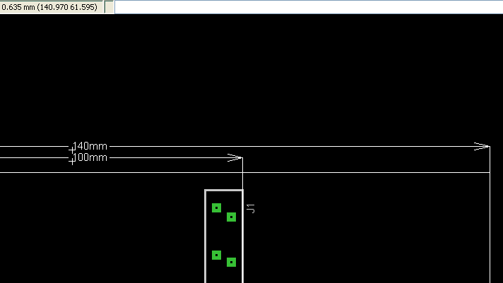

Another cause might be the fact that your PCB length is beyond the limitations of Eagle light.
The PCB size limitation is 100X80mm.
A PCB length of 4 inches equals 101.6mm, which is beyond the allowed size. The PCB width of 3 inches (76.2mm) should be OK.
Try to shrink the size a bit and retry printing using scale factor 1.
Boncuk
I think the size limitation is built into Eagle lite. One simply cannot place a component outside the limited area.
For changing pad size for a component, I believe you should copy the library component to a new device/package, then modify it. You might be able to simply make the large-pad version as an alternative in the standard library, but I would advise against that. When updating, you probably want the complete new library to be installed. That might cause you to lose the alternative packages (I haven't tried that, so I can't be completely sure).
I suggest you make your own personal library, name it 1<name>. The 1 will make it appear as the first library for convenience. Then add all the things you make or modify to it. When it is update time, all you have to do is copy that personal library to the new version.
If you can tell us what component you want to change and how big you want the pads to be, someone here might do it for you to get you started. Frankly, I have not had a problem with component pads being too small. Maybe your drill is too large?
John
Change component pad size with "restring". Requires some playing to get the results you want.
Change scale on Eagle's print options dialog box.
John
Hi John,
your statement is completely correct. I haven't tried yet to draw an oversized dimension layer, but it works on screen.
I made a frame of 140mm length without problems. The component placed within the 100mm allowable length is not to be moved further east.
The destorted print probably means Eagle shrinks the actual board size to the allowed when printing.

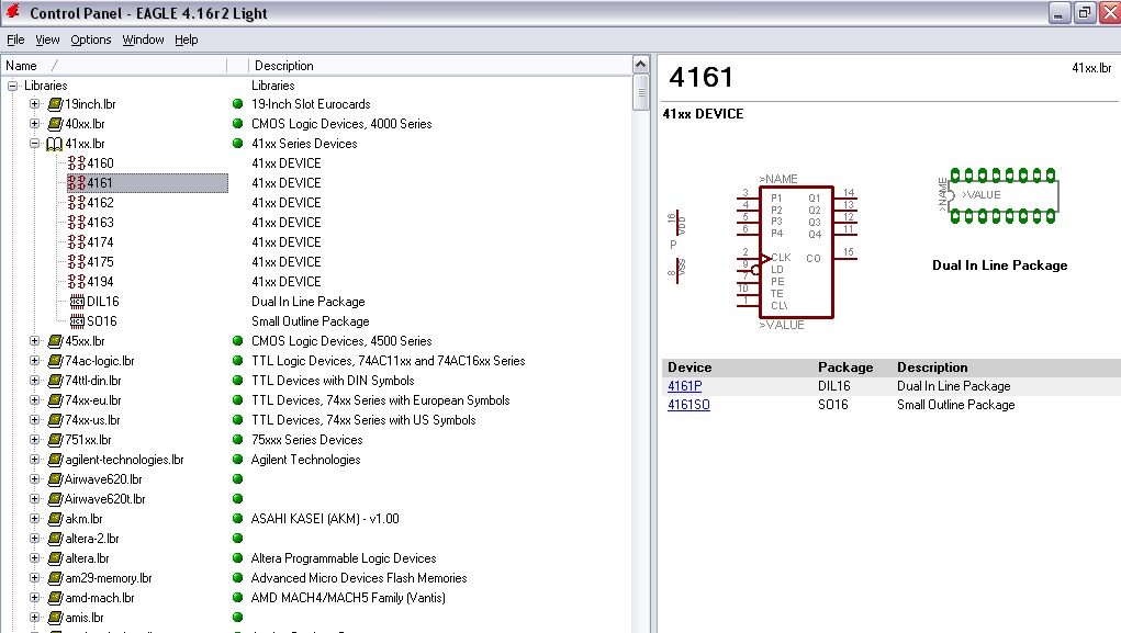

Thanks Mr. Blueteeth for your kind help. I have tried a lot but could not get the pads modified. Would you please guide me further? Under step 1 you have asked to open library in Eagle main window. By Eagle main window did you mean the window that opens by clicking the Eagle 5.6.0 short cut on the desktop?
Swapan
Hey.
Yes, by 'main window' I mean the window that pops up first, when you double click the shortcut.
You can open a Library either by, expanding the 'libraries' on the left pane, then right clicking on a library and choosing 'open', or..
An easier way is just to go to file->open-> library. It should be in the right directory.
The only reason I suggested using the left pane in the 'main window' is because....once you expand 'libraries'...you can expand each library to see what components it has inside.
I have attached a picture...just because pictures are always helpful.

The window opening is named "control panel" (also main window).
Select "OPEN" --> "LIBRARY" and open the library you decided to change and from there open the package of your choice to either copy or alter it.
If you do not copy you can renumber pads, change shape, diameter and drill. You cannot remove or add pads.
I do not recommend to alter pad sizes of ICs. The pads have an outer diameter of 1.6002mm. Enlarging the pads you can't route a trace of 0.4mm width between pads anymore.
You might want to change the drill size to 0.6mm (from 0.8) for more copper after etching, but then you must use machined IC sockets.
The standard pad sizes in Eagle are made for direct IC insertion with a maximum possible free space between pads.
