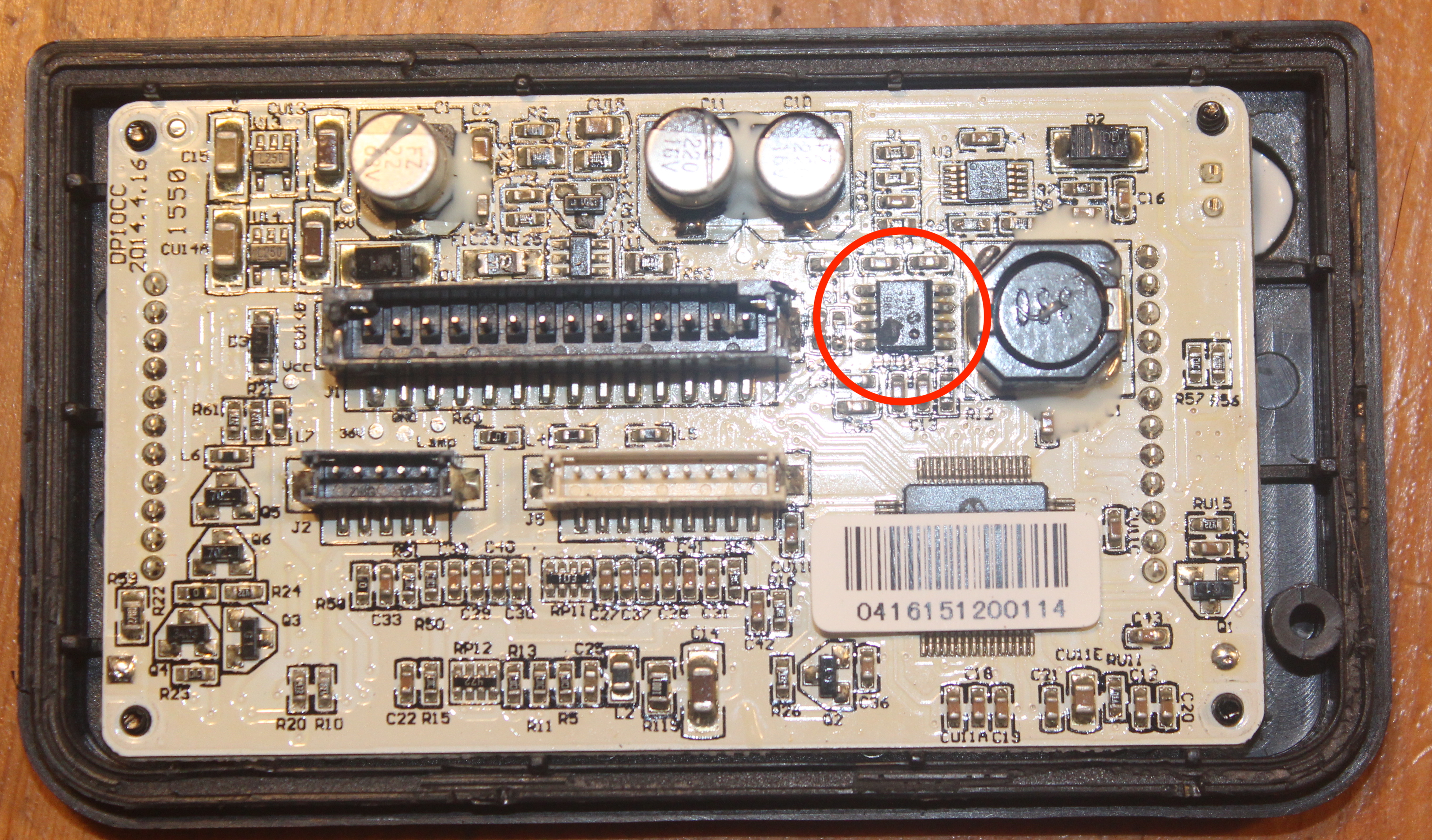

I have a problem with my eBike. Its electrical system contains these parts:
  • 48V mid-drive motor
  • 48V battery
  • display connected to the motor
  • remote connected to the display
  • speed sensor connected to the motor
The system boots, the display reads and update the data from the speed sensor. While riding, everything works fine as long as I leave the speed set to 0, meaning the motor won't engage to assist me pedalling. If I set the speed at 1-2-3 or 4, the display will shut off instantly. I don't hear or feel the motor at all. This quick diagnostic led me to believe that the display was faulty. I noticed a component that seams burnt on its PCB, but I'm having trouble identifying what it is and what it does.
What I can read so far is:
08BJ
91424
(Motorola logo) M6P
Anyone can help me identify this IC?
Also looking for a replacement if possible.
Thank you!

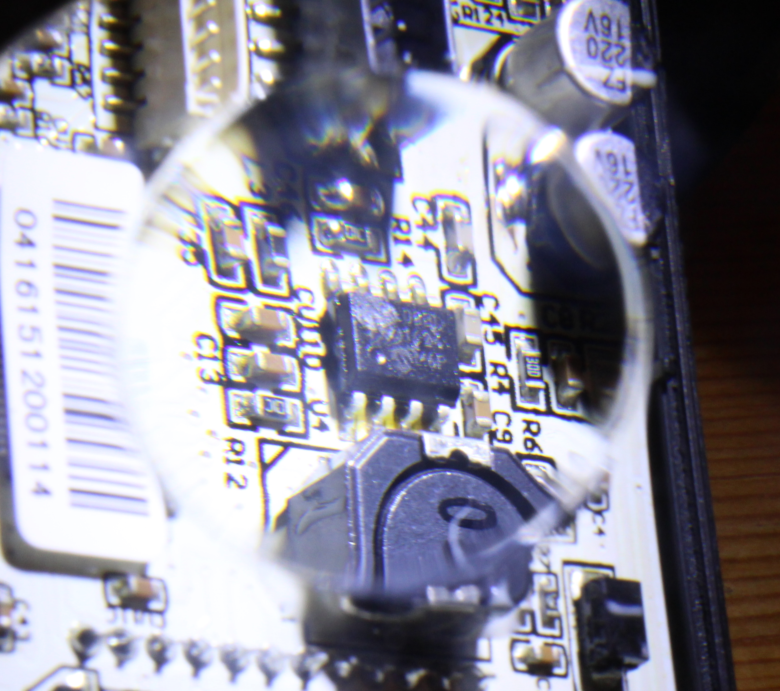

That does not look like a Motorola logo, more like a Microchip "M".
Here is my logic. That definitely looks like the Microchip logo. There is also a large inductor next to the package, so I suspect it is a power supply part ( a step down or step up regulator to regulate the voltage). The part is in an 8 pin SO package.
Most of Microchip's parts are made by Micrel and Microchip bought Micrel back in 2015. I suspect your design is much older than this, so I suspect the part is one of the original Microchip power supply parts (as opposed to a Micrel power supply part). Also, once Microchip bought Micrel, they would have continued manufacturing Micrel parts with the Micrel logo on the top (in the Micrel fabs). I cannot imagine they would have changed the logo immediately. So it is probably one of the original Microchip power supply parts. This narrows it down considerably.
There is destruction around pin 8 of the device. When power supply parts blow up, it is normally the switch pin (SW) that blows up since this experiences the high voltage. So I imagine you are looking for a Microchip part (the part number looks like it has '162' in the part number, but I am not sure) in an 8 pin SO with the switch pin near to pin 8 (not sure about this either). In contrast to that, the inductor is placed alongside pins 1-4 of the part, so this indicates that the switch pin will be along pins 1-4, although the PCB designer could have routed the switch pin from pin 8 over to the left hand side of the device (pins 1-4). This is indicative of bad board layout if he has!
That should help.
Now, the Microchip website is very slow this morning, so I will leave it with you to look deeper...
Simon
The board has a 2014.4.16 date on the silkscreen. The chip has a week 24/2014 date stamp (1424 in the middle line).
It's difficult to be sure from the photos, but is there actually any pitting or missing material from the body of that IC?
The whole PCB has obviously been lacquered or conformal coated after assembly to help with weatherproofing.
The corner of that IC looks rather like the lacquer may just have been flaked off, leaving the original body material exposed.
I'm not saying there is definitely not damage, but the photos do not appear to show the usual cratering or cracking type effects that leave visible evidence of a failure.
The original symptoms make the fault more likely to be in the power control unit rather than the display, to my interpretation?
Indeed that very much more look like a Microchip logo.
There is no hole on the chip nor any frying part that most chip failures usually show.
That would be the motor then and in that case, it shall be torn down!
