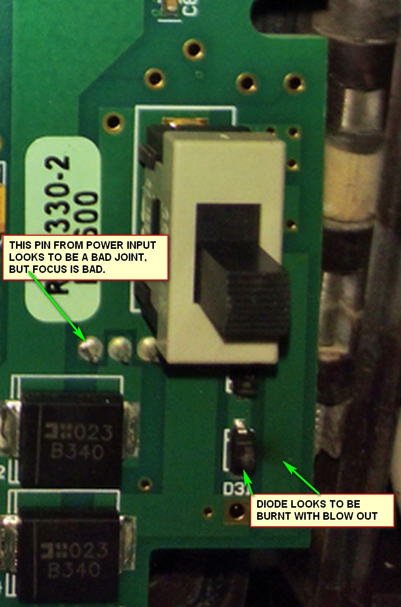

1. The particular two cameras pictured above are not powering on. More specifically, it seems that the boards are not drawing any power. The boards are powered by 12 NiMH AA batteries. The power cable is able to power other boards, so the problem must lie with some component on the boards themselves. Which components could be causing the problem and do you think it is fixable? Can I visually inspect for defects are test anything with my multimeter?

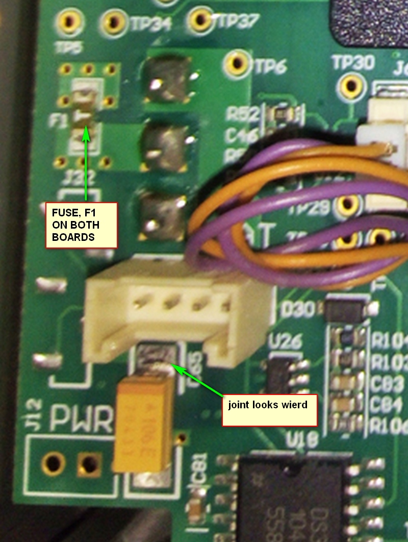

To get you started, The boards that do not power up, check the fuse.
Set your meter on lowest resistance setting, ohms or Ω symbol.
should be low resistance. less than 5 ohms depending on amp rating.
One board appears to show damage to diode but focus is not sharp so cannot be sure and power pin seems to be bad.

Thank you very much pfofit, you have been very helpful and have a good eye. The diode is definitely blown but the fuse is okay on that board. On the other board the fuse seems to be blown. I don't know about the joints, may just be light reflection but I will have a better look at them. Below is the diode. Do you think this by itself can be the cause of the power failure on this board?

The diode is most defiantly toast. It appears that these boards can have to power sources. There is a BATT connector for a battery and a PWR connector (or space for one) on Bd #2. (most likely for a wallwort type alternate source.) Bd #1 has a connector for both.
Assume the board is multilayered.
So, I surmise the Batt+ (red line in my pic, dotted line i think is thru another layer or other side ) follows the track down to the blown diode, thru it and then down thru the board to somewhere. Probably the yellowish cap with the weird solder joint.
If you had a PWR then it would go(green line in my pic) from the+ to the diode D5 thru it and to meet D31 and go thru the board to somewhere thru those two little pin holes fr4om your mag pic..
The + lines also go to the other bigger diodes D32 and D4 and meet together on their cathodes, and go somewhere, probably everywhere as it is the main power.
The diodes are there to prevent reverse polarity and to protect the 2 supplies from mixing. Now you do not have the PWR plug so i would think D5 would be still good. The big diodes are rated at 3 amps and 40 volts. The little guys i couldn't yet find anything. but would be less than 1amp and equal or lesser voltage the the biggins.
What took out the diode could be a defect elsewhere on the board or a mix up with a wrong, gerry rigged or backwards battery.

Measure the diode that is blown, is it open or shorted. Measure both ways by reversing leads.
Measure resistance between anode of d31 and d32. Is it a short or zero ohms?.
Also measure resistance from where cathodes of d5 and d31 meet with red lead and black lead to ground or batt-. with the on/off switch in both positions. The yellow line is where i think ground is .
If the main board is not shorted?.
