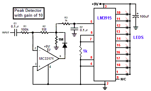

this circuit is working absolutly fine with proper brightness
the problem is that the first led never blinks in dot mode when we lower the volume, the 2nd led remains on low volume,but when i raise the volume leds from 3-10 works totally good.
in bar mode led 1 nd 2 remain on...
i even checked wires,connections replaced leds but not success

The circuit has pin 8 of the LM3915 at 0V so pin 6 and pin 7 are at +1.25V which will be the peak input voltage to light the 10th LED.
The first LED lights when the peak input is +0.052V and the second LED lights when the peak input is +0.0578V.
There is nothing in my circuit to turn on the first and second LEDs when there is no signal. If you built the circuit on a breadboard then the opamp might be oscillating or the wiring picks up mains hum.
I used an MC33171 opamp that has inputs that work at 0V and an output that goes down very close to 0V in this circuit that has a single polarity supply. You probably used an ordinary opamp that needs a dual polarity supply in this circuit.

sir i also used opamp which works on single polarity , i used AP 358.......but i think i am using breadboard thats y there must be noise...what alternate op amp would you suggest as MC33171 is not available here nearby..
and one more question, when i use in dot mode the leds goes up and down at very fast speed, is there any way which could decrease the response time or delay in microseconds?
and i used tl074 for filters, is that a good op amp for audio filter circuits, what alternative would you suggest?
sorry but one more question :) , how can i cascade two of lm3915 so that i can increase the range ??any circuit u have would be helpful to me..

i used AP 358.......but i think i am using breadboard thats y there must be noise...what alternate op amp would you suggest as MC33171 is not available here nearby?
An LM358 has trouble above 2kHz. The MC33171 opamp I use is also low power and works from a single supply but works well up to 35kHz so it covers the entire audio band of frequencies.
Mine has a fast attack and a fairly slow decay. Increase the value of the 0.1uf filter capacitor to make both slower.
The TL074 is a good audio opamp if its is biased properly or if it uses a dual polarity supply.
how can i cascade two of lm3915 so that i can increase the range? any circuit u have would be helpful to me.
The circuit is on page 9 of the datasheet. I made it about 33 years ago with 20 LEDs.
