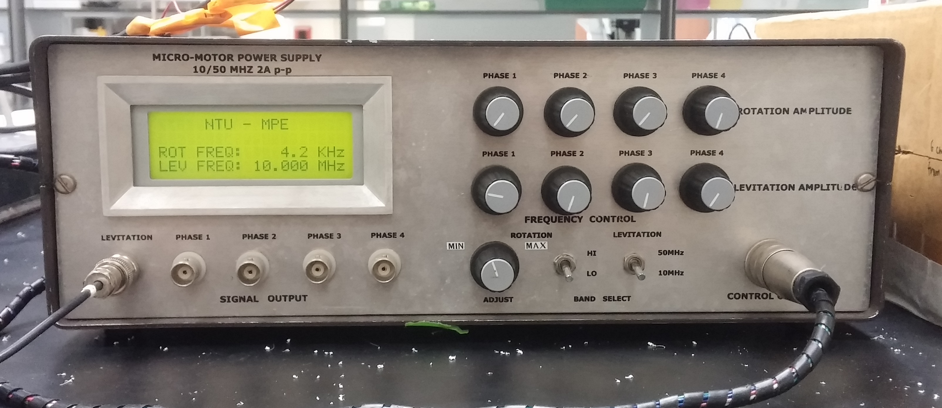

I have a micro-motor power supply that give 10/50Mhz,
Can you give a link to information about that power supply, in my experience "motor" and "MHz" are not words which go together.

I have a micro-motor power supply that give 10/50Mhz, 2A p-p
zexclo,
Please send a picture of the power supply. Or write down all the information on the power supply. Are there meters, what do they measure? Or model number. MORE information.

A quick google search indicates that micro motor power supplies are adjustable frequency power supplies for powering dental equipment (dental drills etc.) in a range from 10000 RPM to 50000 RPM. As Jim says "motor" and "MHz" don't go together. I'd like to see where the power supply specs actually say MHz. I suspect we're really talking kHz.

I believe the power supply is custom made by my supervisor, 20151020_174135.jpg
hence is an image of the power supply.

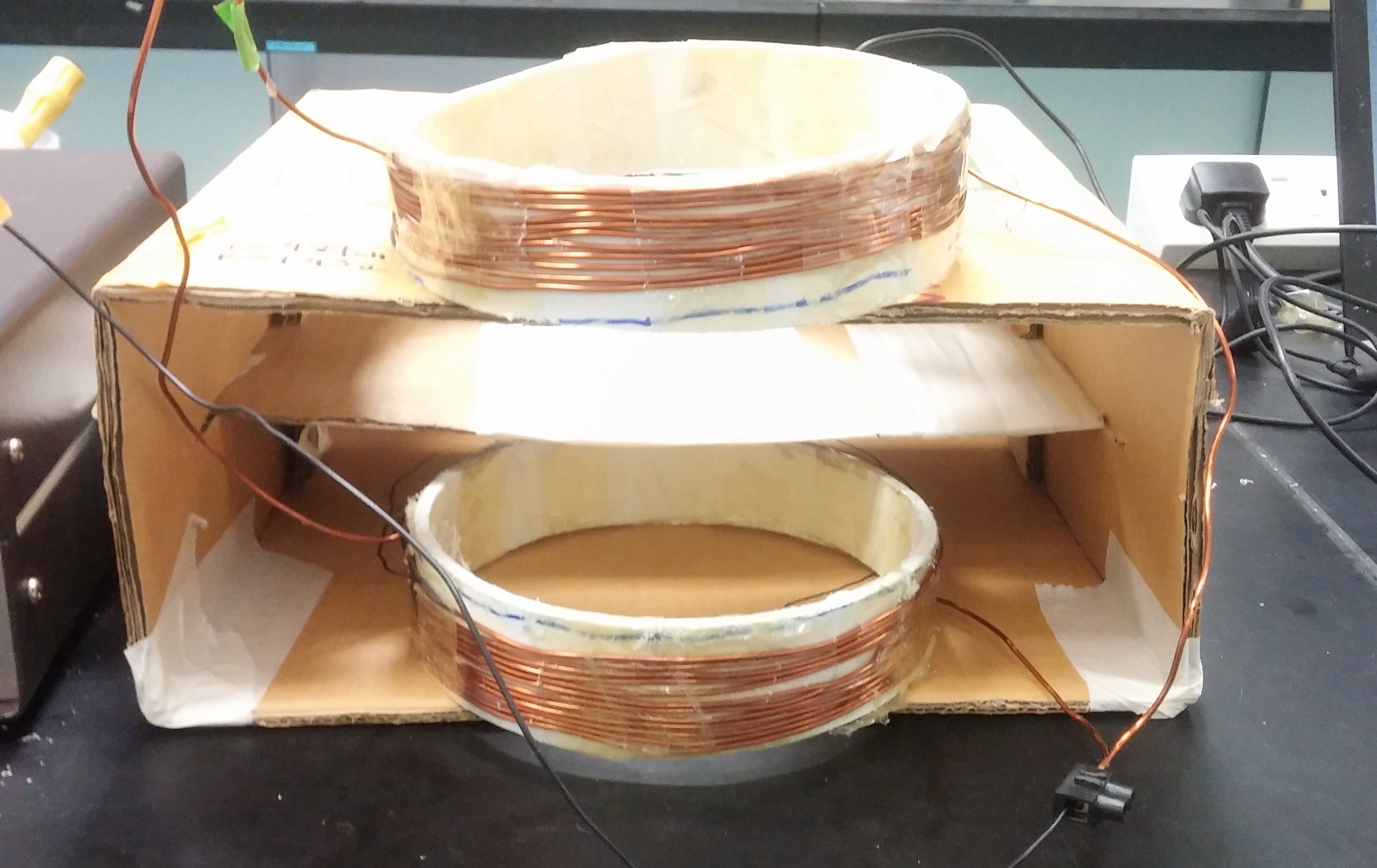

Currently, this is the image of my Helmholtz Coil which I have constructed. Its actually much smaller than the coils ronsimpson has constructed.

Sorry for the miscommunication, may I know the words? I will try to explain.

From my experience of handling the power source, the lev feed of 10/50mhz will respond to the leviation switch of 50/10mhz. It will not be affected by other inputs.
For the Rot Freq, it will control the current/voltage to the coil.
Fair enough. If you note the "rot" frequency shown on the LCD display, the units are in kHz. So, I think it's fair to assume that the frequency of the power that you are feeding to the coils is kHz and not MHz.
One other question: What kind of insulation does your coil wire have? It doesn't appear to have any, unless it's clear enamel.
Yea, we are working with the "rot" frequency. Believe that clears up alot, and not the MHz
