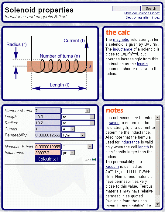

Currently, a side of the coil has 74 turns, diameter of 20.5, total length is 48.82m.
Is there any other ways which I can prevent the self-resonance frequency? What will happen if I add capacitor to the circuit?

Dont know how accurate this calc is for such a large coil.
Here is the resonance of the coil with four different capacitors, namely 10pF,100pF,1000pF and 10nF. Note that the self-resonance of the coil with no added capacitance is likely to be ~100kHz.
Adding capacitance won't help. It will lower the frequency where it resonates, making things worse. You want the self-resonant frequency to be as high as possible. At resonance, the the coil no longer acts like a simple inductor. It becomes a transmission line resonating at a frequency corresponding to a wavelength equal to twice the length of wire in the coil. That is, the coil becomes a halfwave resonator, and will have zero current flowing at the ends (current nodes) and maximum current flowing in the centre of the wire. Since the magnetic field is proportional to the current flow, you'll get an uneven field. There are no external components that you can add that will change what is going on in the coil.

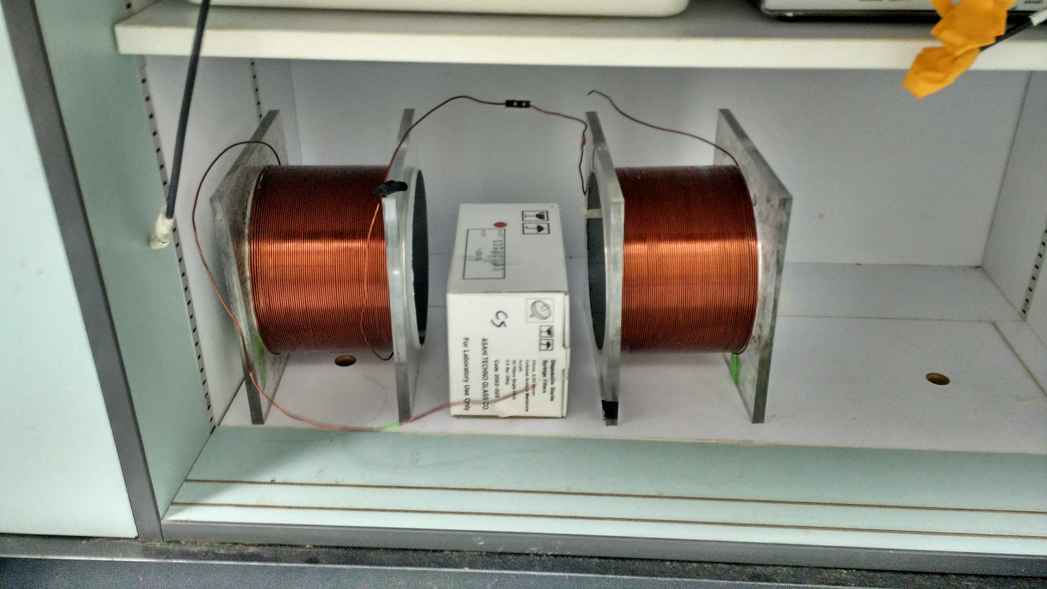

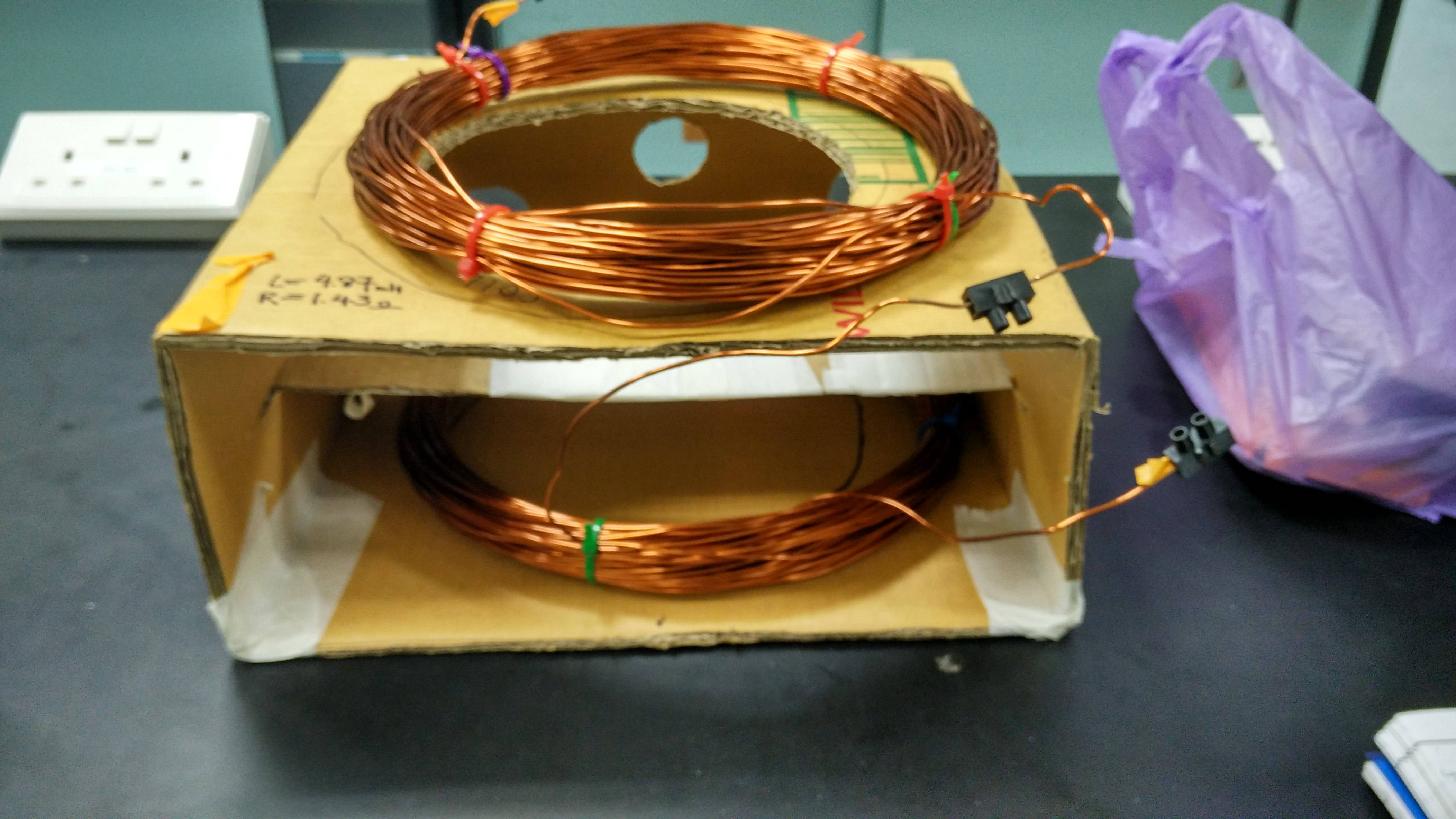

I am trying to make a magnetic coil, to generate a field strength where the maximum strength is at the centre of the coil.
The input frequency is 50Mhz and 2 Ampere.
The length of my coil currently is 97.64m, which is adjustable (buy more or cut)
Currently, this is my coil, the distance between the two coils are 10.5cm (half the Diameter of the coil).
I admit I am newbie in electronics. From my peers, they are saying that adding of capacitors will help "remove" the inductance and help generate the strongest field strength at the centre of the coil.

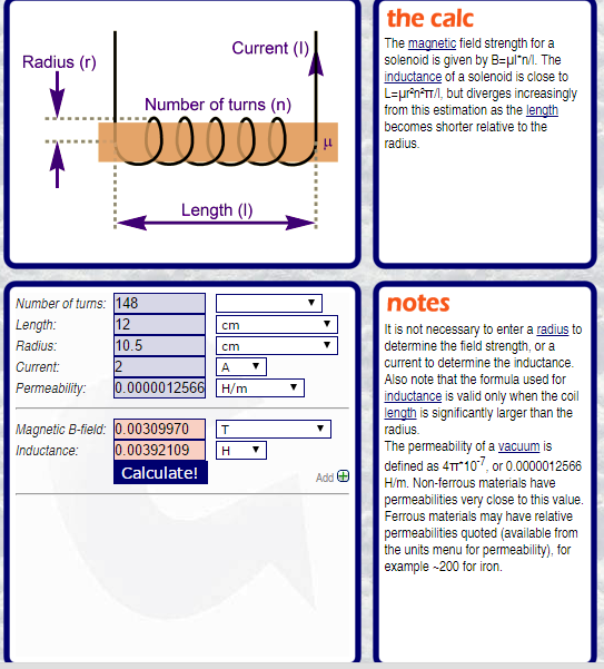

Thank Mike for the useful site and link, have updated the information.
The coil is actually not that big as from the updated pic. LOL
Not sure if I am righ, as the design of my coil and the image seems different.
there is two coils, arranged in series,
with 74 turns in each coils,
the length of the coil is about 12 cm, and we are putting in around 2A.
The inductance is about 3mH.
That is partly true. If you add capacitance in series it has a negative reactance which will cancel out the positive reactance of the coil, reducing the overall impedance of the circuit, and allowing more current to flow. However, your coil has too much wire in it as I explained earlier. And in addition, the coil will have very high self-capacitance, which at 50 MHz will mean that most of the current will bypass the coil anyway. I recommend that you replace your coils with single turn loops.

my bad, I meant that if its alright if the coils have large turns, 140 turns in total with 70 turns per side. But you seems to have answer the question where,if its single coil by the inductance should be low, hence the adding of the capacitance should help.
Hence, if I understand you correctly, if I manage to single coil like the image. and if the measured inductance is 1.34mh, I should be able to use a capacitor to cancel the positive reactance of the coil?
Your latest image still shows multi turn coils, not single turn loops. And 1.34mH is still much too high by a factor of about 1000. You don't want millihenries; you want microhenries.

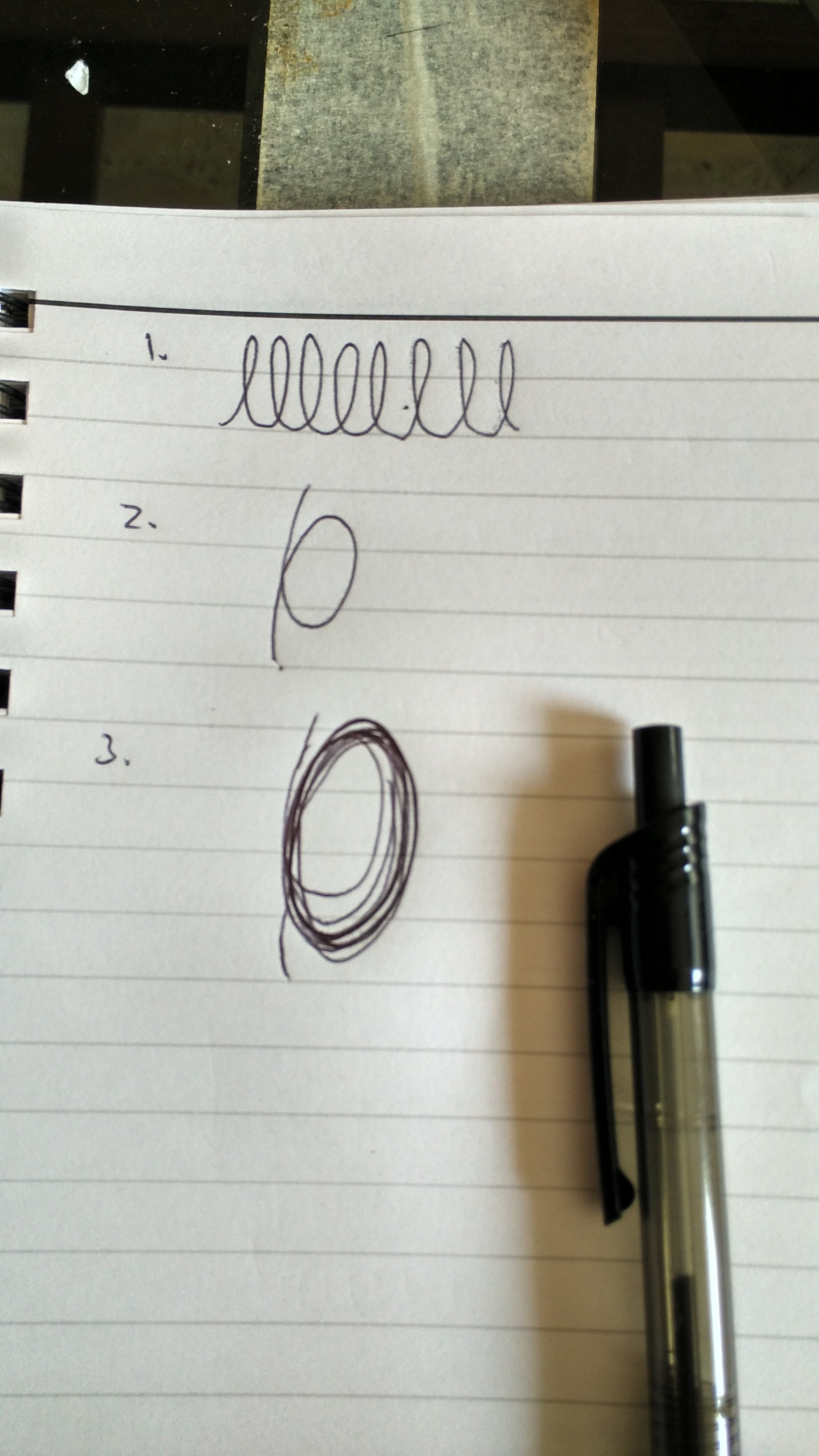

I am kinda confused. Hence, I drew this image.
By single turn loops, do you meant by number 1 or number 2? For the second picture, the coils are arrange in number 1, just that the coils are more closely packed together. I am assuming that single turn loops are actually number 1, and multi-turn loops are number 3.
Number 2.
At 50 MHz, 1 and 3 will have so much inductance and self capacitance that you won't be able to get any significant amount of current to pass through the wire, and therefore won't be able to generate any significant magnetic field.
