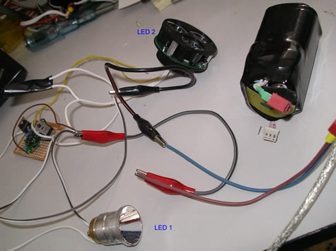

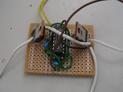

Hi Boncuk,
I finally got round to building a test bed with all components of your original circuit (without the 1uF capacitor you recommended recently).
I'm using 2 LED modules, similar to what I will be using in the finished torch.
On applying the battery pack both LEDs immediately come on.
Then LED 1 only (pin 2 from the flip flop)
Then LED 2 only (pin 14 flip flop)
Then both on again
There is no 'both-off' in the switching sequence
This 3-part sequence continues with each momentary switch
I then introduced a 2u2 tantalum capacitor (I don't have a 1uF on hand) as in your ammended suggestion and nothing worked
No damage, as when I removed it was back to the 3-part sequence again.
Obviously we need to be able to have a both-off as there's only one momentary piezo switch on the torch
Can you advise please?

Listen, if you can provide someadvice on this earlier circuit diagram Boncuk sent would be most appreciated. just looking for someone to explain to a neandathal like me why there is no 'off' setting in the sequence with my rendering of his 4027 flip flop diagram.
