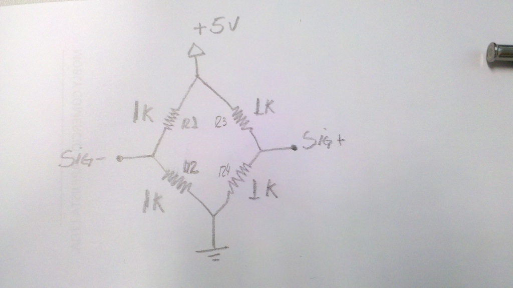

The first step in my project, is know the load cell that I'm using. For that i use a multimeter, to measure the resistance between connectors, and the voltage in load and unload:
Resistance in terminals:
"Excitation+" to "Excitation-" = 1K
"Signal+ " to "Signal -" = 1K
"Signal+ " to "Excitation-" = 750R
"Signal-" to "Excitation+" = 750R
Voltage (using a 5.45v power source) in terminals SIG+ and SIG-:
Without load: 0,001v
At full load 10kg: 0,055v
To confirm the measuring scale voltage, i repeat the test using a 9.4v power source, an result was:
At full load 10kg: 0,094v
So after this tests, the conclusive schematic for my load cell is:

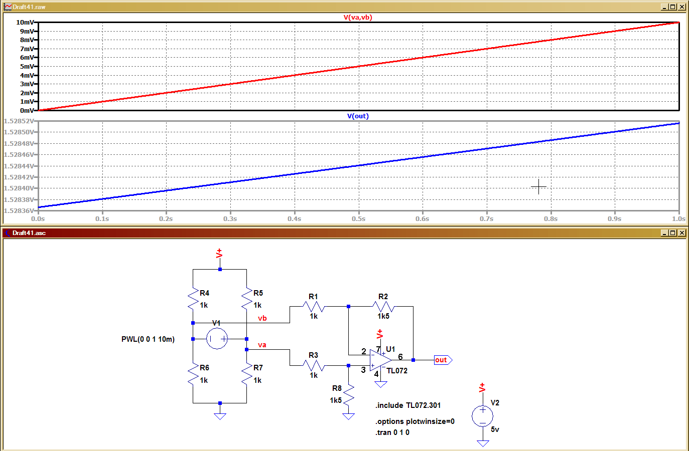

Please, can someone tell if this schematic is correct ?. And presume the scale of 1mv/V ?.

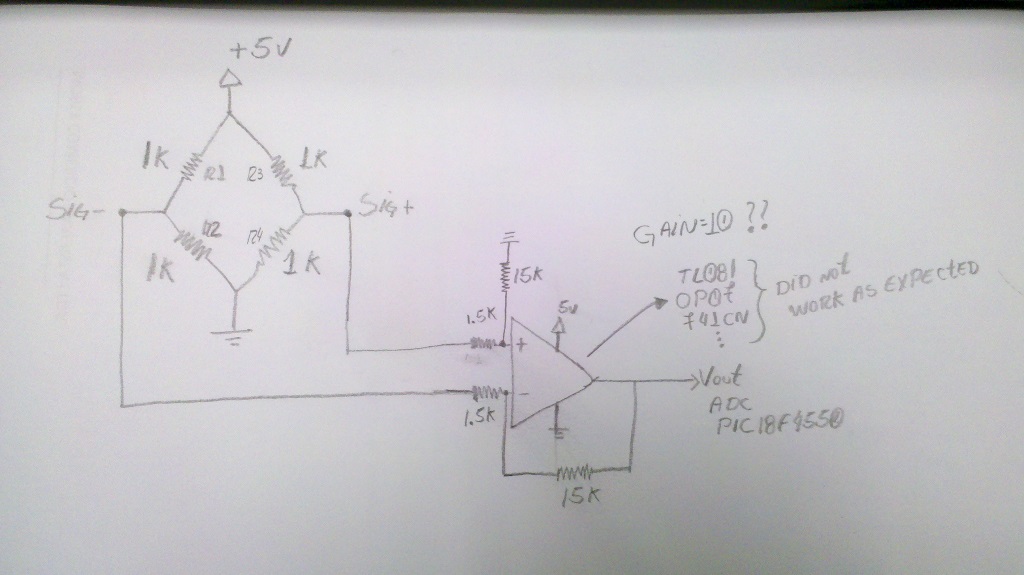

The second step, was try to use a Op Amp in "Differential" to amplify the voltage between SIG and SIG- for the PIC18F4550 ADC module .
Now is the problem...I try a LOT of schemas, formulas, Inverting, Non-inverting, Differential, Differential Instrumental, etc... and have nothing.

Tried Schematics:
Diferential Op Amp ("SIG+" - "SIG-"), Gain Vo/Vi = 10:
Similar project from this link: https://www.galant-e.ru/images/upload/1875/ru/an_651x_011%20-%20rev%201-3.pdf
hi Daniel,
Looking at your circuit diagram you are showing the OPA 0V power pin as Not Connected N/C...??? is this correct?
So which OPA type is being used in the circuit diagram.??
Eric

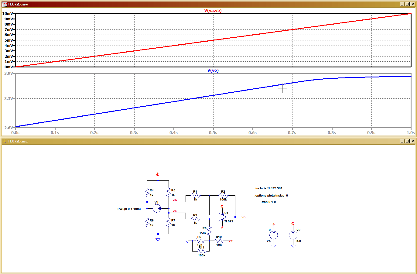

hi dt,
This is a LTSpice simulation of your circuit.
Vsig = 0mV thru +10mV

hi Daniel,
Eric
Sorry ericgibbs, the unconnected pins are: 1, 8 and 5.
The correct diagram are:
Tks;
Daniel
hi D,
I do not see a diagram.??
Have you tried your original circuit using dual supplies to the OPA.?? +5V and -5V.?
The OPA's require dual supplies.
E
Better with dual supplies, but if using a single supply as shown then try it without the 1k5 at pin 3.

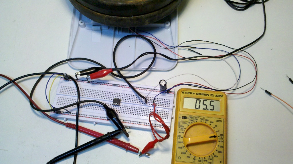

Hi friends!,
This morning i set new prototype, following the instructions, on article: Bridge Circuits, USING A SINGLE OP AMP AS A BRIDGE AMPLIFIER FOR A SINGLE-ELEMENT VARYING BRIDGE.
". The key redeeming feature of the circuit is that it is capable of single supply operation and requires a single op amp.
Note that the RF resistor connected to the non-inverting input is returned to VS/2
(rather than ground) so that both positive and negative values of DR can be
accommodated, and the op amp output is referenced to VS/2."
Now i got better results !!!, at last the Vo is not satured.
To get a gain (Vo/Vi) about 100x, i use 1K(considering 500R from load cell) and 150k resistor.
Placed a 1uf poliester capacitor on OPA power source, and 100nf capacitor on SIG+ and SIG-.

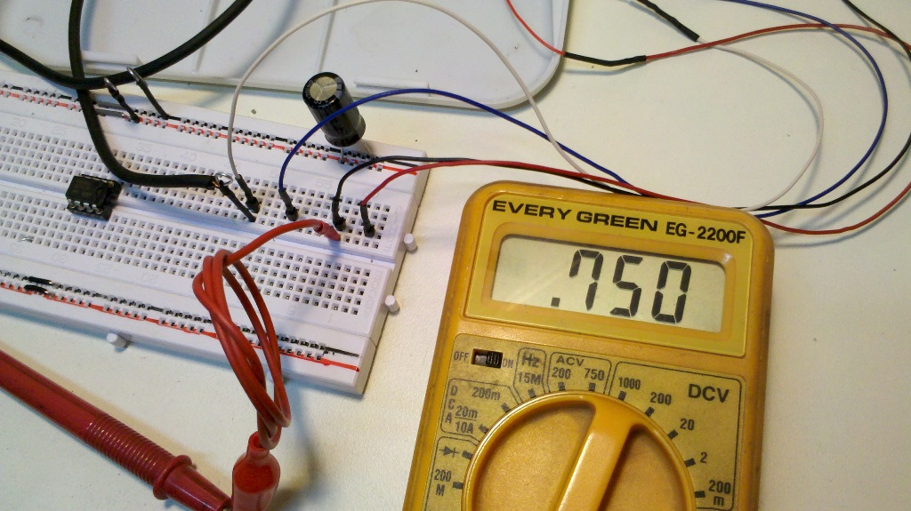

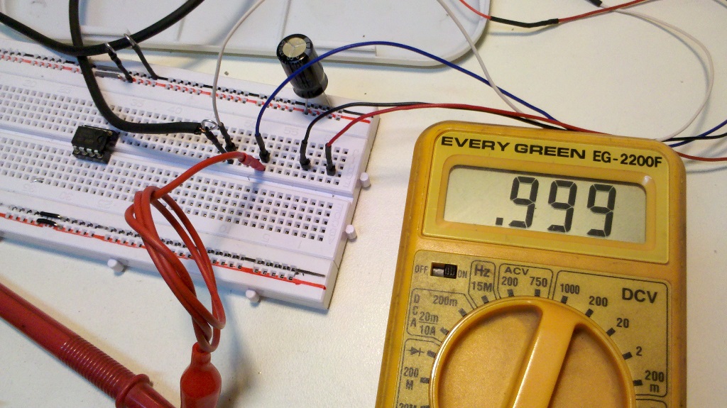

Tested Schematic:
New board with much less wires:
Test results from OPA Vo (in volts):
CI_________No Load____2Kg________10Kg_______Diference 0-10Kg
OP07_______2.61_______2,94_______4,94 _______1,63
TL081______1,509______1,512______1,533______0,024
LM301______3,43_______3,68_______4,52_______1,09
LM318______2,34*______2,67_______3,56_______1,22
UA741______2,19_______2,51_______3,81 _______1,62
* this case is very strange, if i aproximate my hand of CI, the voltage variables from 2,34 to 2,64. Just aproximate at 1 or 2 centimeters.
Now i must understand why the Gain is not linear. But so was told to me, the single op amp configuration has poor gain accuracy.
Thank´s
Daniel

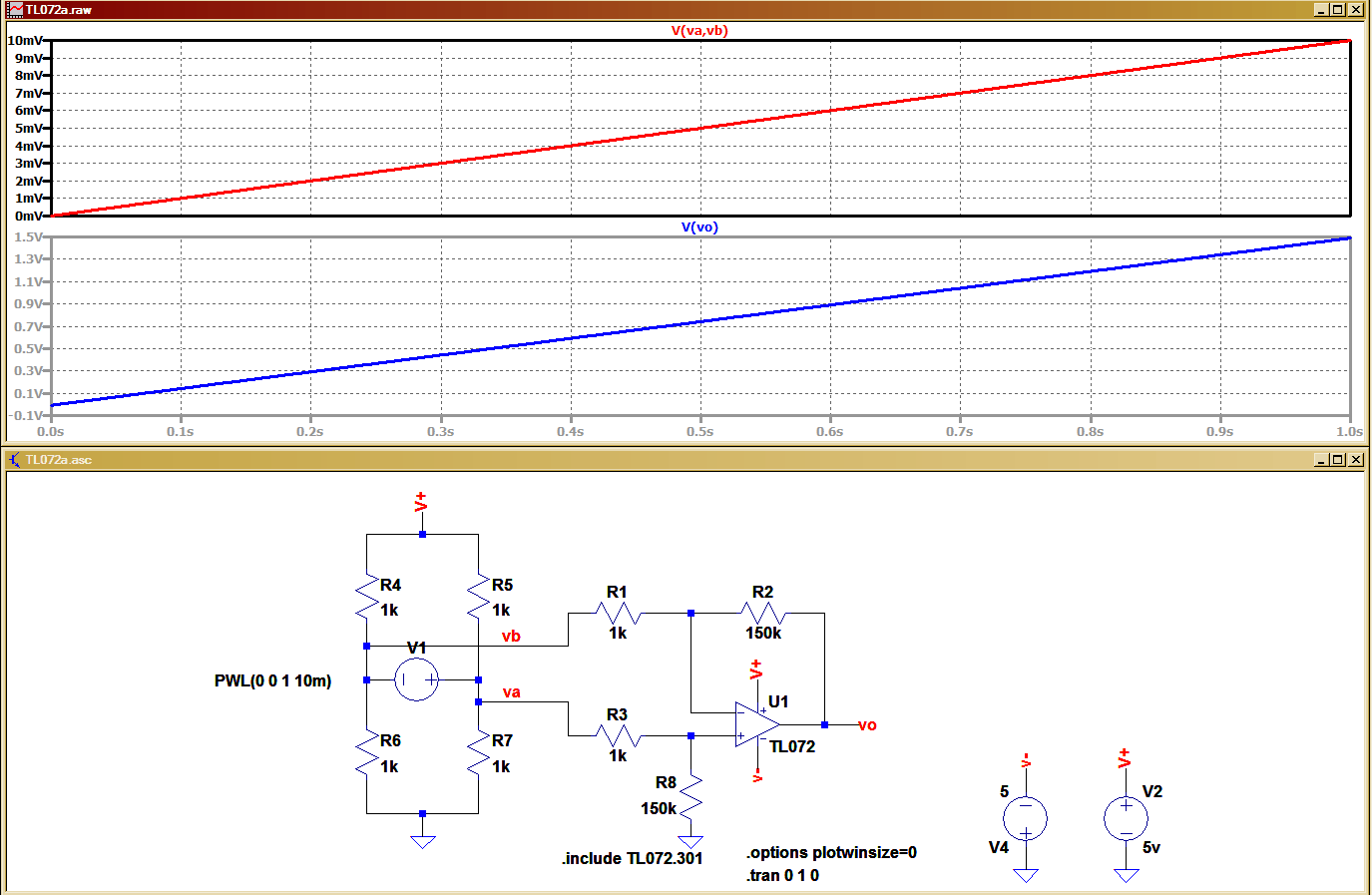

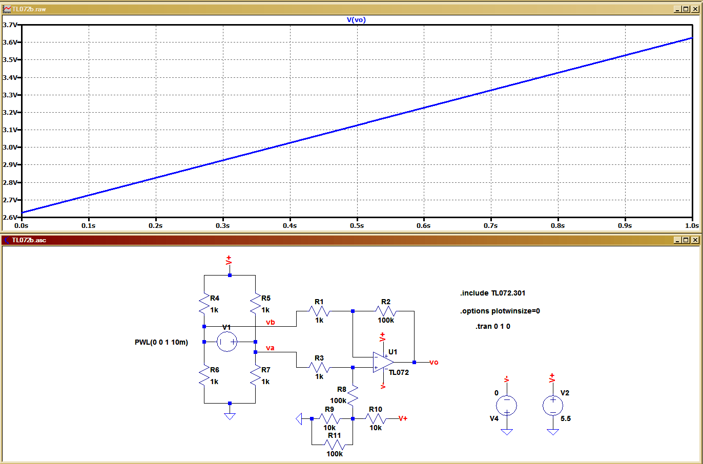

hi D,
With a 150K, the gain is too high, the OPA is saturating, see image3.
With 100K, see image4, the gain is 'linear'
Most common OPA types will not give a Vout close to +Vsupply,, often its at least 1V to 1.5V lower.
ie: Vout max= 3.5V to 4V max

Humm, curious i'm a bit confused now...
When I use a 1K resistor, it´s expected the included 500R from load cell (westone bridge model), to result in 1.5K from SIG+ and SIG-.
Using a 150K resistor, the gain should be 100x. Using a 100K resistor, the gain will be 66.667x ?, that is correct ?.
Assuming:
R2 = 150K
R1 = 1.5K
V2 = SIG+
V1 = SIG-
Vo = ( R2 / R1 ) * ( V2 - V1)
Vo = ( 150000 / 1500 ) * ( 2,50 - 2,49)
Vo = 100 * 0,01
Vo = 1v
Each 1mv results in 1v, in this case you are right !!!, is too high. I could use a 15K for R2, to get just 10x gain ??.

hi D,
E

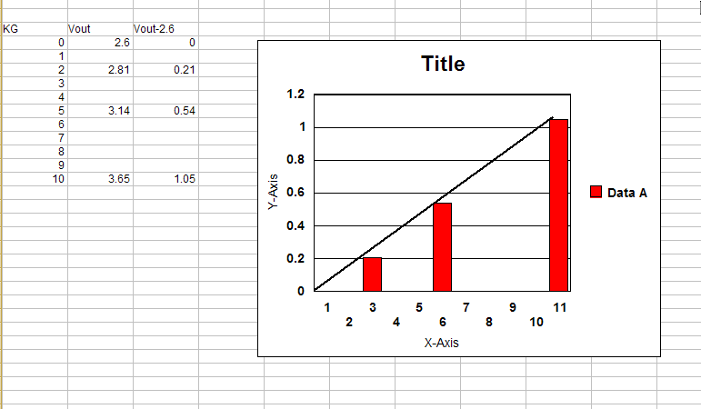

Using OP07, and 100K resistor:
@0kg - 2,60v
@2Kg - 2,81v
@5kg - 3,14v
@10kg - 3,65v

hi D,
This is a spread sheet plot of your [100k] values.
It looks OK to me.:rolleyes:
E
