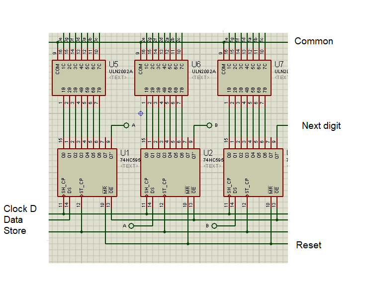

Hello all,
I am trying to build a custom, large scale, three seven segment displays which should has a LED (maybe two LEDs) for each of the segments and intended to drive through Arduino. How should I build a driver circuit for this three seven segment displays and do you have a circuit diagram for this? As I am a newbie in electronics, I'm quite not sure how to build a driver circuit for the display.
Thank you very much.
I use a shift register 74HC595 and a ULN2002A.. The reason is each digit is permanent ( not multiplexed ) and the ULN2002A can take LARGE displays
Without more information, neither are we.
What voltage(s) are available to power the display?
What voltage is available to power the electronics?
What is the desired current through each 2-LED string?
Is the Arduino driving each segment individually (21 output lines), multiplexing the digits (10 output lines), or some form of serial interface (shift registers, I2C, SPI, etc.) (3-4 output lines)?
This allows many displays to be cascaded... 74hc595 hard to get now....

What is mentioned as "A, B, C" in each of the shift register ICs and can I use 500mA from each of the outputs of ULN2002A for driving LEDs?
Thank You.
The datasheet says yes. It also says you can parallel the drivers.
Drivers made for LED's might actually be better because it's generally easier to control brightness and you get current control.
Thank You.
These are just connected together to allow data throughput.. A goes to A etc...
Can I use ULN2003A instead of ULN2002A?
You must... My first schematic was wrong.. 2002 do not work as intended... BUT!! as Mike pointed out.. ULN2803 is even better..
