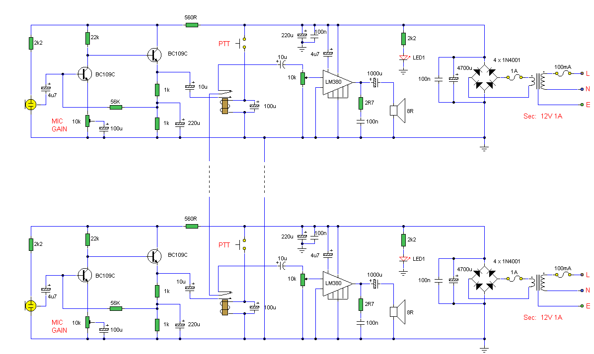

Sorry Guys!
Here is the schematic that I prefered best!
The intercom a wired one!
What I need is a general representation of a 2 way intercom in block diagram
and perhaps some explanations of the schematic.

It is obvious that the simple intercom has two identical sections and two identical power supplies.
Each section has an electret microphone, a preamplifier, a power amplifier and a speaker.
Press-To-Talk pushbuttons activate a relay that switches the communication direction.
There is no such thing as "intercom design".
You need to learn about how transistors work so you can design a simple microphone preamp circuit.
You need to learn about microphones, power amplifier ICs and speakers.

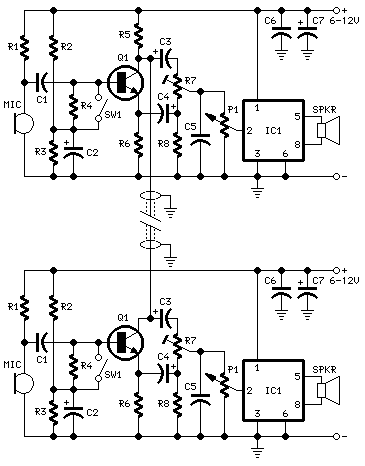

I need the circuit diagram of a two way intercom (not wireless) with its working and component specification.cud u give it?
A simple intercom is half-duplex. You must press a button while you speak which cuts off sounds from the other end.
A much better intercom is full-duplex. Then you and the other end can talk and listen at the same time.
A full duplex intercom project is at www.redcircuits.com .
It is also at Electronics Lab - Home . The full-duplex intercom uses a shielded audio cable to connect them together:
