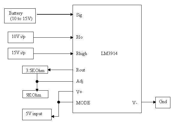

i am having LED bar which will monitor the LED status from 10V to 15V below 10V all LEDs in BAR are turned off , then i need to blink an LED which will indicate battery needs charging immediately.how we can achieve this with LM3914 IC.

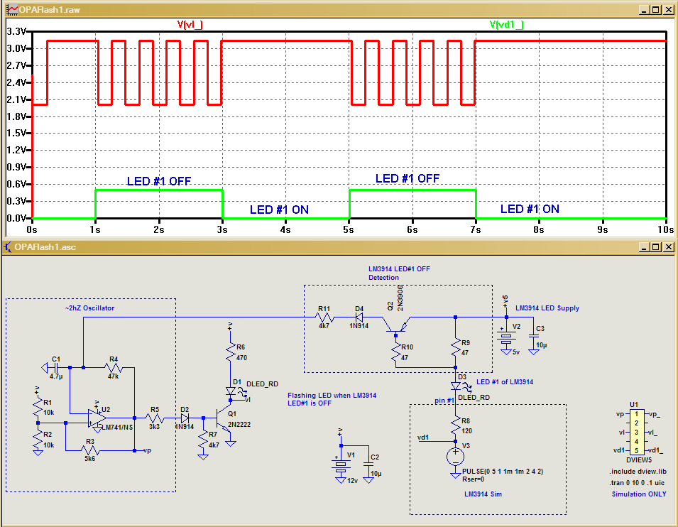

I will post a led flasher circuit using one of those opa's
EDIT:
This option is using a 741 opa.
The remote LED will flash at approx 2 hZ, when LED#1 [pin1 of the LM3914] is OFF, ie: not LIT.
If you want the flash to occur at different LM3914 LED off, move the detection circuit to the required LM3914 LED.

thank you sir, but i have one doubt in the circuit LM741 7 pin is connected to +v pin and 4 pin is grounded but in real time when i am grounding the 4 pin in LM741 is not giving the required result for any circuit.
What results do you get.???

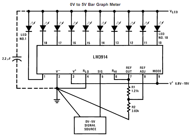

The LM3914 does not have anything to program. R2 and R3 are simply calculated to make a DC reference voltage so that the 10th LED lights when the peak input voltage reaches this voltage and also determine the current in the LEDs for brightness. Just copy the circuit and build it.
The rectifier D2 and the filter capacitor C3 are not needed.

If you read the datasheet for the LM3914 then you will see that it is simply a voltmeter and has nothing to program and does not use coding.
Its block diagram shows that it is completely linear and has no digital logic, no microcontroller and no memory.

But the LM3914 is so simple that a simulation is not needed since it is just a voltmeter.

sorry sir my proteus is not properly installed thats why i am unable to post the circuit, i have drawn the circuit in word, please see this and tell me where i am doing wrong

I got a correct drawin - straight from the datasheet. You can compare and make any corrections:
lm3914_pinout-png.46701
