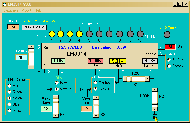

To monitor a 24V battery, its possible to make a resistive potential divider to reduce the 24V to 12V.
This 12V is connected to the input of the LM3914
The LM3914 is set up to display from say 10V thru 15V in 0.5V increments, so the 24V is displayed as 20V thru 30V.
Do you follow OK.?
Look here: https://www.electro-tech-online.com/blogs/ericgibbs/136-single-dual-lm3914-v3-0-calculator.html

Thank you for your quick reply i have few more doubts here when i change the signal input then only led status is changing(observed in the link given by you) when i see the data sheet of LM3914 the signal input range is only 0-5V but i need to monitor 12V so can you explain me some datails how this will operate thanks in advance.
Consider the battery is at 24V, so if I have a resistor divider of two, 10K's and I connect this divider across the 24V battery I will have 12V at the junction of the two 10K resistors.
So if the 24V battery voltage falls to 22V, at the divider I will have 11V.
If the junction of the divider is connected to a LM3914 input and the Vlow of the LM3914 is set to 10V and the Vhi is set to 15V, then the LM3914 LED's will show voltages from 10V thru 15V, which corresponds to a battery voltage of 20V thru 30V, in 1Volt steps/LED.
Do you follow OK.?

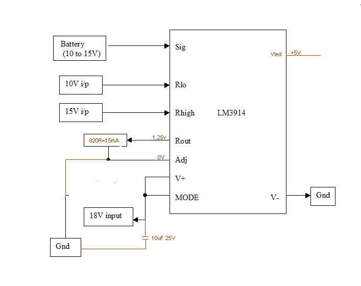

sorry sir my proteus is not properly installed thats why i am unable to post the circuit, i have drawn the circuit in word, please see this and tell me where i am doing wrong
  • LM3914.doc
i have drawn the circuit in word because my proteus is not working properly below is my circuit
and LEDs positive is connected to 5V and negative is connected to remaining pins in LM3914. when the 9KOhm shown in fig is grounded the circuit is not working properly when it is floating then the circuit working fine. please clarify these doubts

ok, I see it now.
You should have the +V & Mode to LM3914 at 15v, keep the Vled at +5V
Try that and let me know what you get, I do not use Proteus so I cannot tell you if what you are getting is accurate.
ya now i am connected V+ and mode pins to +15V , same result is coming if i am connect 9K ohm resistor to Gnd nothing is coming(No led is glowing) and when the 9K is left without any connection(floating) then the result is coming as expected

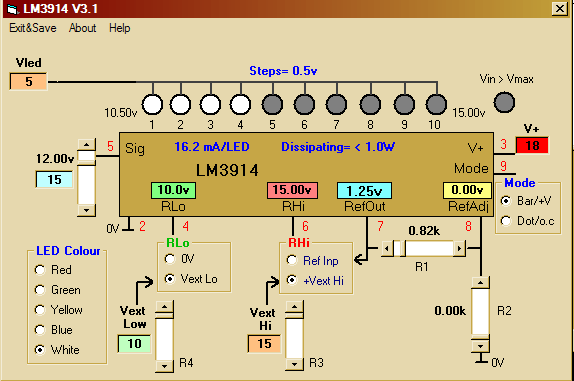

what is the purpose of Refout and Refadj in LM3914 circuit
The Reference Voltage Out is the voltage which is used internally for the 10 comparators, the Reference Voltage Adjust is used to SET the Reference Voltage out, also the current flowing in the resistor between RefOut and RefAdj sets the LED current.
The LED current is approx 10 times greater than the resistor current.

Completed the hardware test of the LM3914, the +V to the LM3914 MUST be at least 2 volts higher than the RefHi volts of +15V, so I have use +18V for the +V.
Keep the Vled at +5V, if you are using only one LED per pin.
It works OK, from +10.5V thru 15V [battery voltage displayed OK]
Do you follow OK.?
k but we are giving 18V to V+ which is maximum value to that pin can't it will effect the IC for longterm purposes? ,so as per your suggestions below one is the final circuit or if you make any changes can you please post that circuit diagram.

A supply of 18V is not the maximum supply voltage allowed, the absolute Vmax is 25V, I have used LM3914 with +20V for a number of projects, with no problems.
I will look thru your circuit.
Look at these images.
This circuit has been built on a project board and is working as expected.
