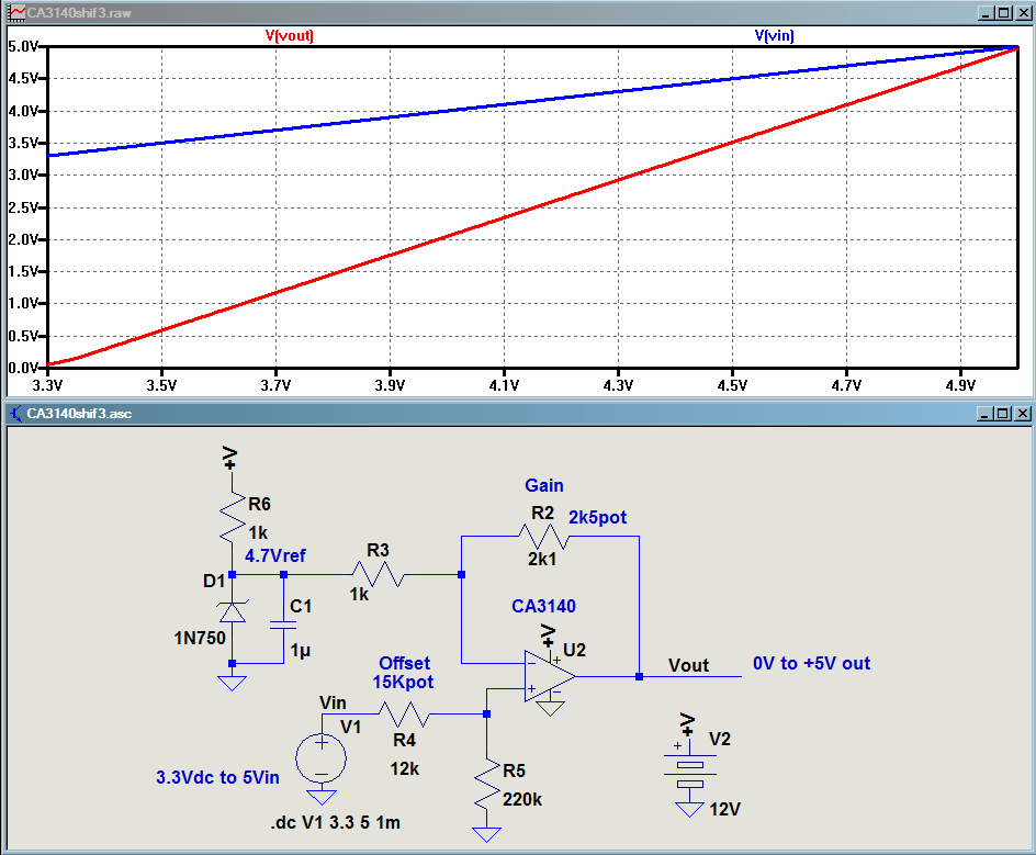

My input signal is 3.3V to 5 volts.
I need to amplify and offset this to 0 to 5 volts.
3.3V to 5V should be converted to 0 to 5V for ADC.
Is it possible to implement using Opamp(s) with +12V supply. No negative rail.

Its possible to get within about 10mV close to 0V, using a TLC358 or CA3140 OPA.

It will be helpfull defenitly, The values I can correct by simulation and trial, But needs an idea How to do this offsetting. The opamp offset voltages I can manage.

Have a look at this option, with a CA3140 or TC358 it will get within 10mV or so of 0V , using a single +12V supply.
Note: using a 12v supply means that the output could go higher than +5V while setting up.
To protect the ADC input connect the OPA output to the ADC input via 470R resistor, this will not affect the performance of the ADC.

Thanks a lot for the circuit.
btw Why you use this 4.7V Reference? I have +5V on board. Any consequence if I change by changing resistors suitably. I will try in simulator.

I am using Proteus for simulation. There CA3140 is not showing correct values, but when I replaced op amp with LM358 it gives almost acceptable values in simulation.
