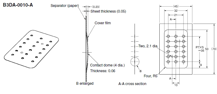

Hey guys i have this:
Digi-Key - SW1019-ND (Manufacturer - B3DA-0010-A)
Here is relevant image from PDF with info needed to help...
pad-jpg.39859
From TOP MOST LEFT HAND SIDE BUTTON... how many MM is it to center of next button?
If it says 3 buttons is 21MM then i just divide by 3 right? I get 7...
So each should be 7mm apart from left to right correct? How come it seems to be 7mm apart from top to bottom not left to right
heh i tried the distance between 2 holes on sheet which is 10mm and seems perfect... so 10 from LEFT TO RIGHT and 7 FROM TOP to BOTTOM
hi atom,
Its the old case of how many gaps between 3 telegraph poles.
Count the gaps, not the poles.:)
