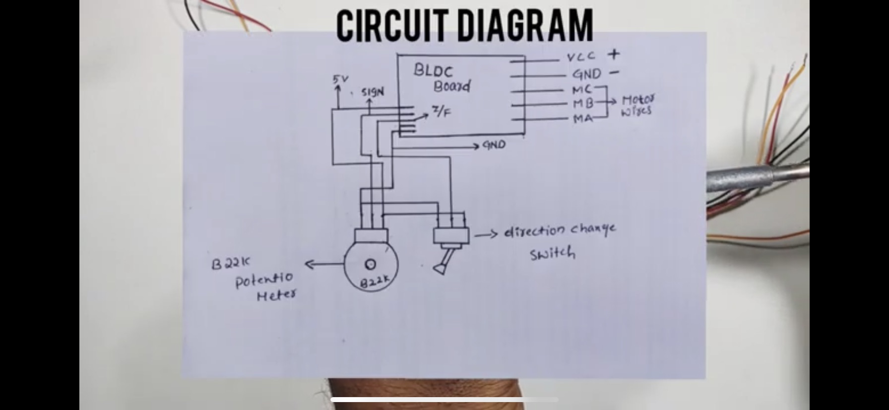

Help me to start 24V BLDC (Star winding)

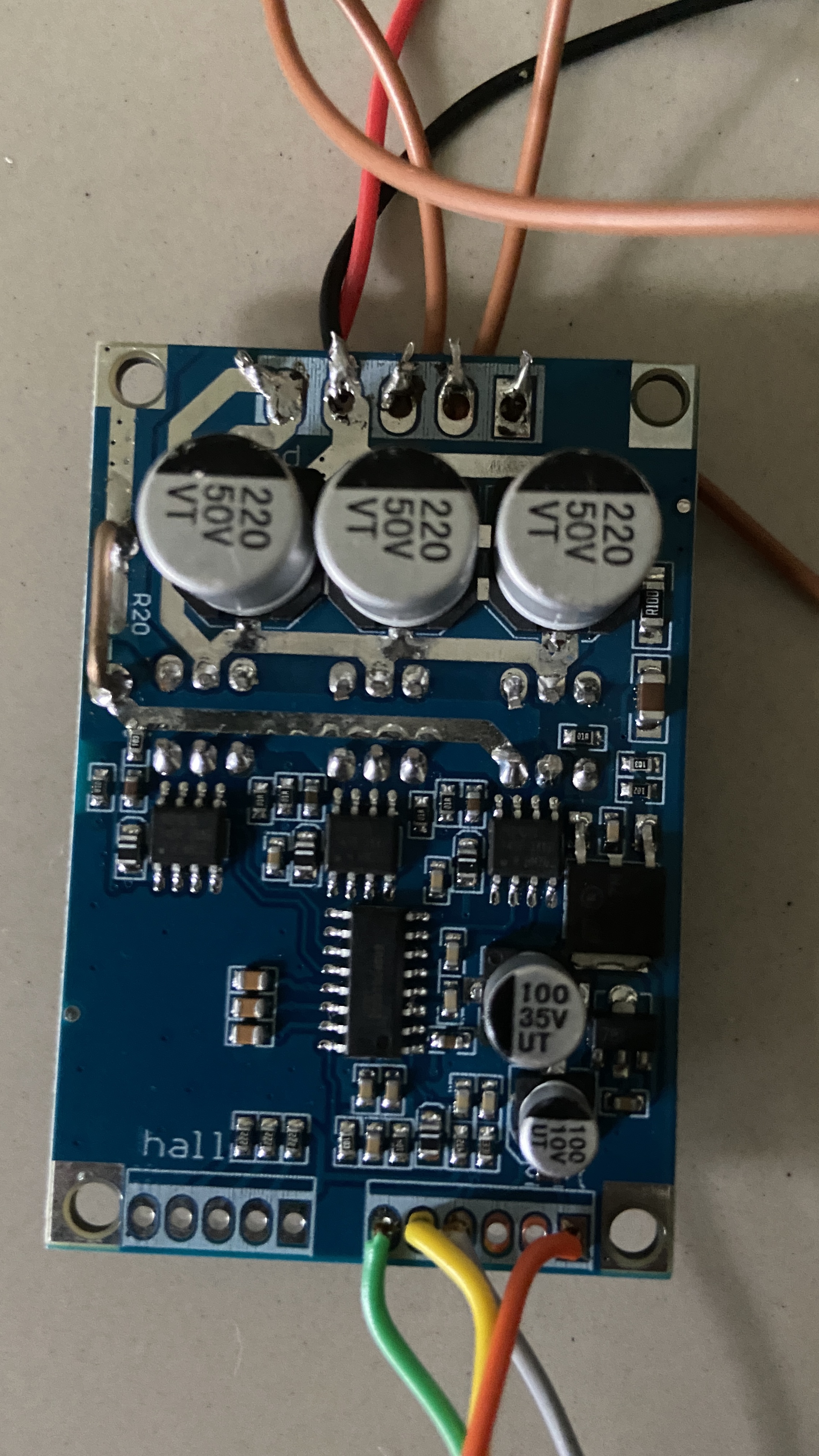

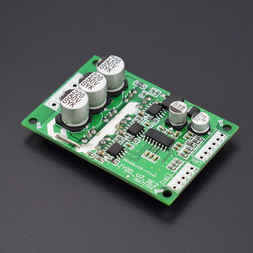

After lots of research, I brought the below BLDC driver to run my BLDC motor.
I had an order with no hall sensor but unfortunately, it came with a Hall sensor.
Now is there any way to start my BLDC with this driver???

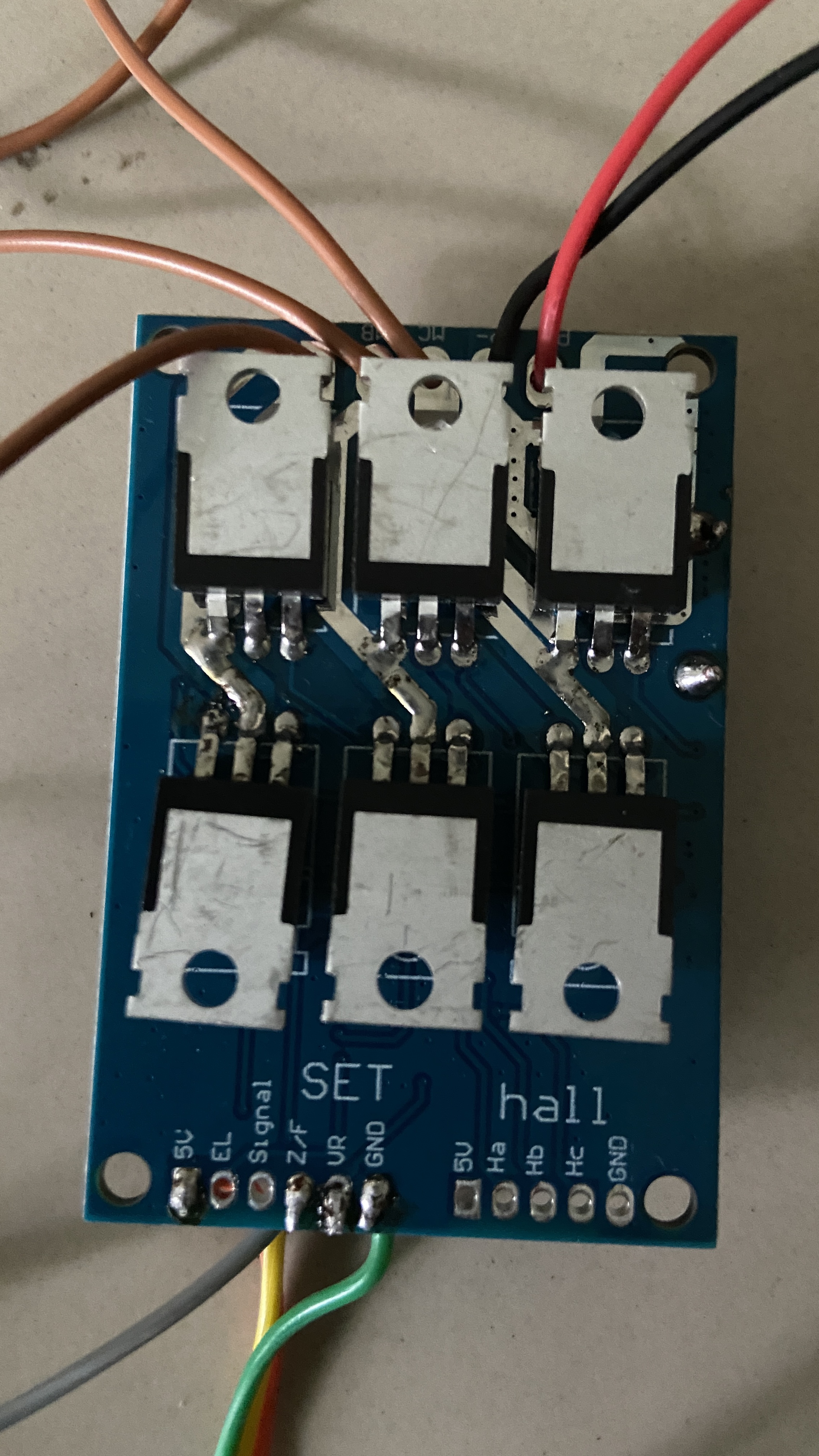

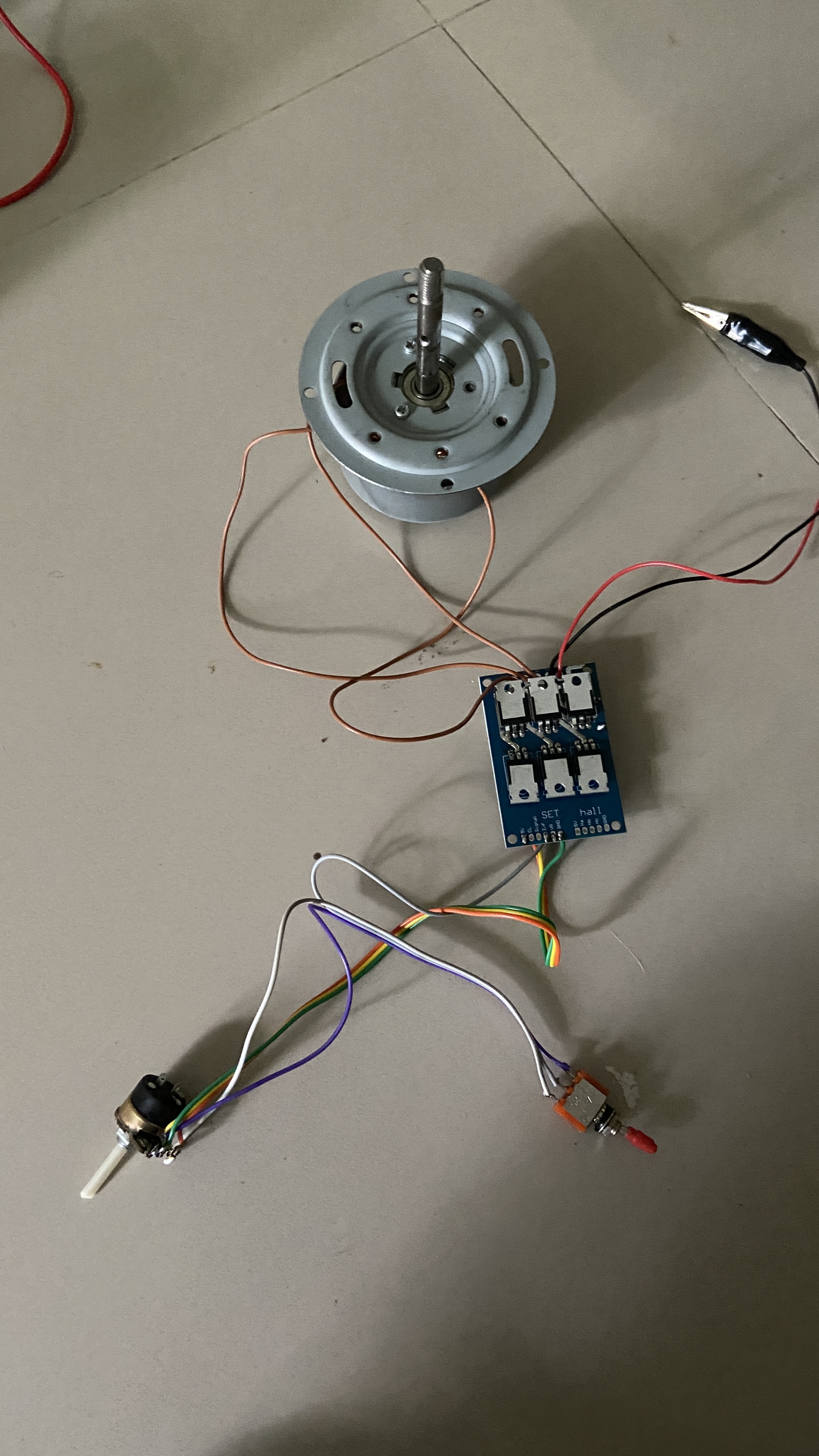

I have connected all the connections as below schematic.

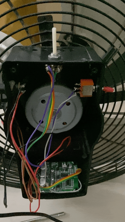

My Actual circuit
From backside
If the drive is intended to use Commutation sensors, with no other options in order to switch, then you may not have success with running the motor with this drive.
If that is the same motor from your other thread, it had/has an internal ESC or drive. That drive would also need to be disabled. But like Max said, a Hall sensor driver needs Hall sensors to work.
