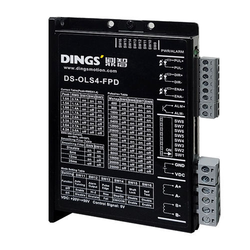

My first thought would be to use a high resolution pulse generator on the main winding shaft, eg. a slotted disc and optical sensor, then a TTL/CMOS programmable divider to generate step pulses at any needed frequency.
Use mechanical or optical limit switches to toggle a bistable / S-R latch at each end of the feed system travel and use the output from that to control the stepper driver Direction input.
That would allow you to use such as an L297 + L298 stepper driver module.

It's neither overkill, nor impractical - and by far the most obvious solution.
It would be simpler, cheaper, and far more versatile - the days of crude fixed logic system are long gone.
Here's a simple example, with everything done for you:
Interestingly it uses a servo to spread the winding across the bobbin.
I thought the OP was referring to this type of thing, "intelligent" stepper drivers - rather than possibly using a microcontroller generally?
I have no direct experience of them, but look for "electronic lead screw" for lathes.
They use stepper motors to drive the lathe leadscrew to enable the lathe to cut threads of any pitch without having to change the gearing between the lathe spindle and the leadscrew.
