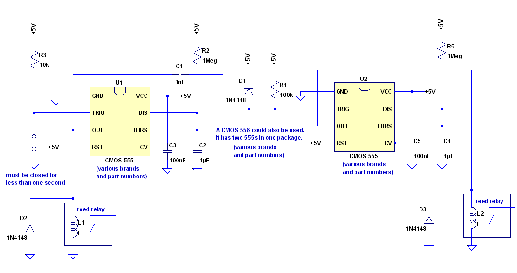

Here is a circuit for you to try. The values will have to be adjusted:
You should add a 1N4148 diode across each relay coil, anode to ground.
I think a bipolar 555 running on 5V is marginal for a 5V relay, due to the high level not reaching the positive rail. A CMOS part might be better for low-current coils, such as reed relays.
He could also use a CMOS 556, which is basically a dual 555.
Here is the circuit with protection diodes across the coil of each relay.
You will need a 12v supply as the 555's only produce about 10v on output pin 3 when HIGH.
You can use a dual 555 (556)
He said he was talking about a 5 volt circuit. I don't know if he meant that only the relay contacts will be switching a 5 volt circuit, or if he meant he intends to power the oneshots with 5V.
There is nothing left on the output of a 555 if you use a 5v circuit.
I assumes the simulator would be 12v. Like all training aircraft.
I suggested CMOS 555s in a previous post. If you use relays with low-current coils, they should be fine. The contact loading is apparently minimal.
I don't know nuttin' about no training aircraft.:D

I simulated it (my version) in LTspice, and it worked fine.
The circuit you posted is driven differently. When used as a monostable (oneshot), the 555 goes high when triggered.

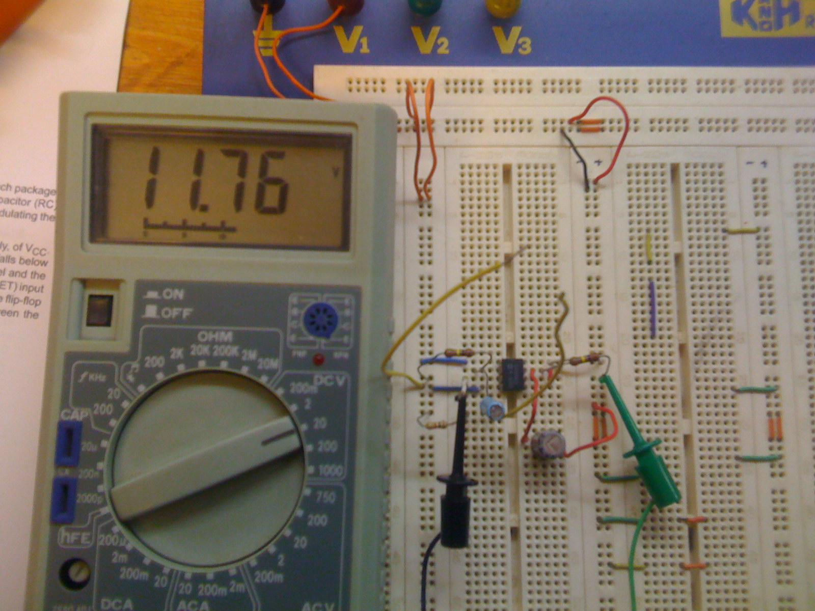

I breadboarded the 1st 555 to check what happens.
When I connect the power (12V), the OUT pin of the 555 rises immediately to 12 V. When I join the two long yellow wires, simulating the pushbutton action, the voltage drops to zero, for about 1 second. This would be exactly the opposite of what I wanted to happen.
I'm measuring the OUT voltage by connecting the (+) probe of the voltmeter to the (+) of the power supply and (-) probe to the OUT pin of the 555. If I connect the probes the other way around, I get the same readings but with the polarity reversed.
What am I doing wrong here...???
You need to measure across where the relay would go. Negative probe to ground (negative side of power supply), positive probe to pin 3 on the 555.
You have to let the 555 settle down.
This involves it going through its first cycle when the power is first applied. This is one of the problems of a 555.
After that, it operates as required.
If this is not acceptable in a real-life situation, the circuit will have to be re-designed around a hex Schmitt Trigger.

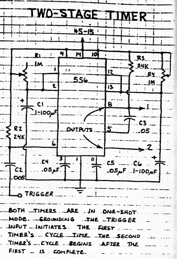

I found this schematic on a book called "Engineer's Notebook II" by Forrest M. Mims, III.
Do you think this will do the trick?
The other schematics that were proposed here all start with the OUTPUT on a high level. Even after letting the 555 setle it will always start high and go low when i press the pushbutton.
All the 555 circuits start by going through the sequence of producing a HIGH on the output.
As I said beore, if you don't want to have this happen. you will need to have a circuit designed around a hex Schmitt Trigger.
