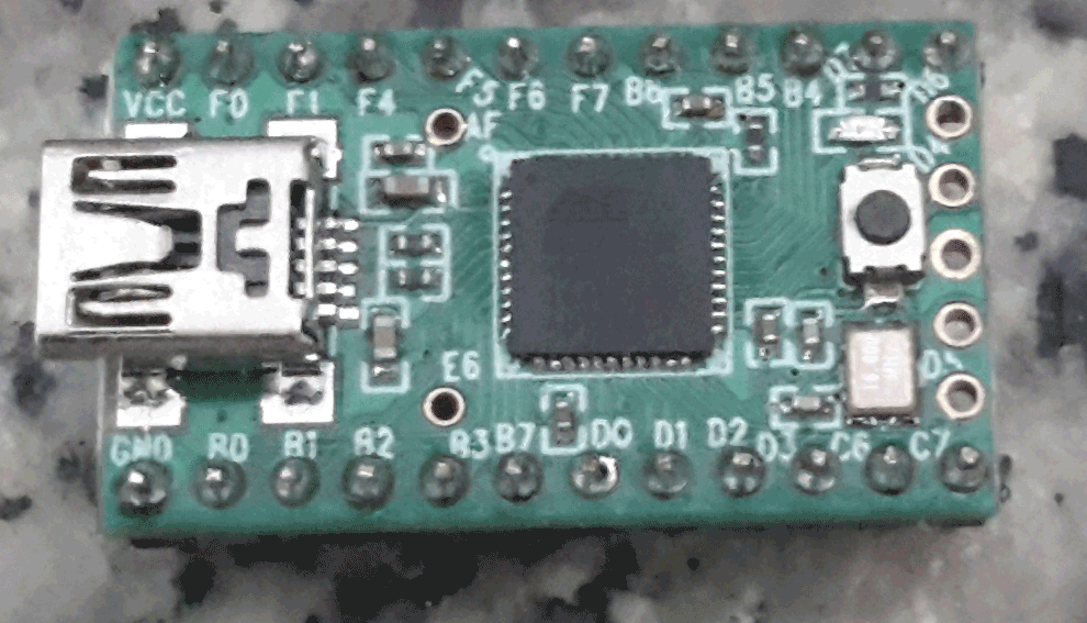

Hi all,
I bought this board a few years ago and can't remember anything about it or find it anywhere on the internet.
The processor is an ATMEGA32U4 and the USB connector is mini. Note the extra holes opposite the USB connector (RHS of the board). The upper pins are labeled F0 to F7 and the others B, C and D. As this appears to be obsolete, I want to use it as a IR receiver to control the old laptop I use as a media center as described in Jon's thread.
Thanks,
Found it. When I plugged it in it announced itself as a Teensy. Found on ebay. Now to work out how to install it in board manager.

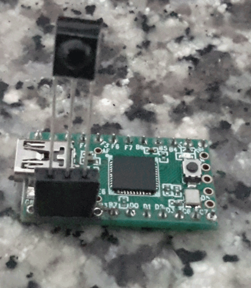

I've had to mess with the Teensy a few times. Only way, I've found, to get into bootloader appears to require a reset of the PC. A real pain in .. Anyway, complete now and all working. My TV remote has the media keys (play etc.) for playing files from USB which are ignored if no USB drive. So, I remapped those to the keyboard equivalent. Works brilliantly. Thanks for the pointer Jon.
This was so easy to do I have to tell someone.
The hardware, I soldered a 3 pin female header to 3 I/O pins (easier than trying to get power from power pins) and stuck a TSOP IR receiver in it.
Selecting "Serial + Keyboard + Mouse + Joystick" for USB mode made short work of the HID part.
The code was then simply,
