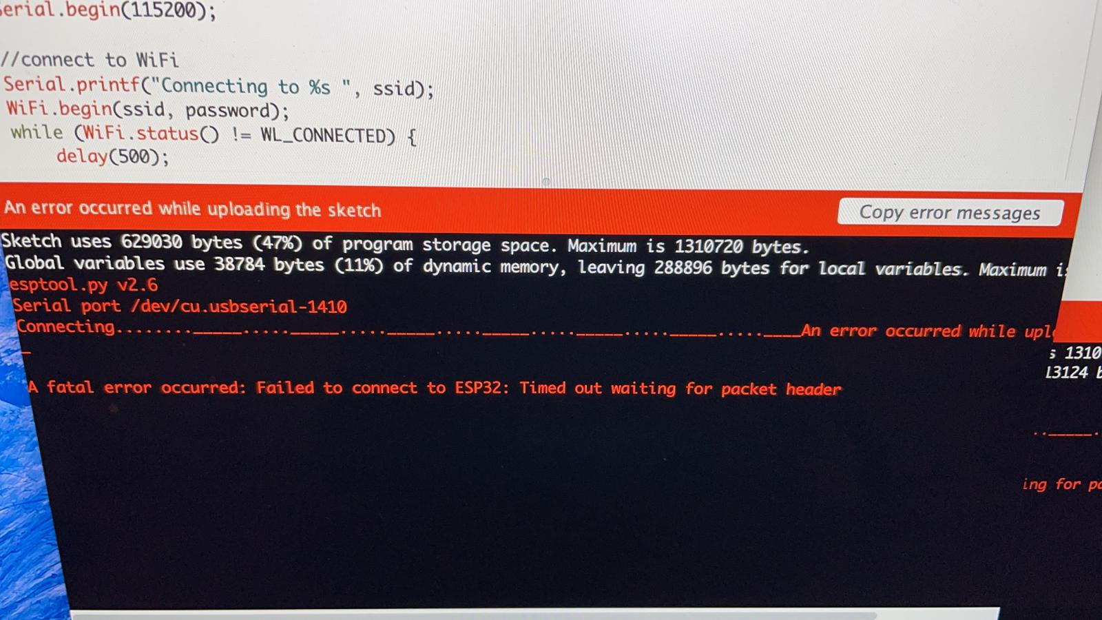

I have made a custom esp32 board. For schematic, i have used sparkfun link-https://www.sparkfun.com/products/15006
The problem is- the arduino code is not uploading on the custom esp32 board. So, how i can upload the code on esp32?
Is arduino bootloader is required first for bootloading the blank esp32? If yes, then what is the procedure for uploading the arduino bootloader on esp32?

did u select board settings and port#, ?
u made? did u solder tx/rx bkwrds?
can you see the new serial port on device manager?

There are two buttons on the board. One with a zero, one with RST. After you power up, before you compile and program...
- press and hold the "0" button
- press and release the RST button
- release the "0" button.
- then compile and let the IDE upload the code.
The code will reset the ESP32 when it is done programming.
