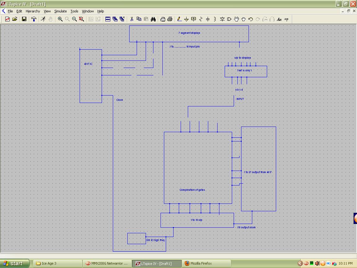

Hi, i want to connect output of of my AND gates to 7447 ic for scrolling led, please tell which buffer ic should be prefer for less distortion with some gain??
Either a 74LS341 or 74LS344 Octal non inverting buffer IC's would work.
There are a nunber of different types of Octal non inverting buffer IC's available.

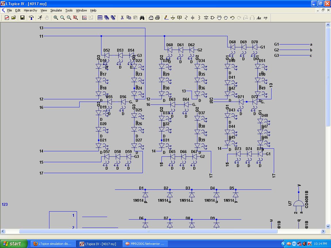

Hi, i want to change the position of glowing led, for better understanding i have posted pics. as i am transmitting my signal from AND gates to displays by 4017 ic, as the freq. is very high due to which the position of displays changes.
eg: when i want to switch on display 1, display 5 on due to which whole process (or signal) mix up.

It sounds as though your gating logic is not complete.?
I would advise that for debugging/testing, you slow down the 555 oscillator, say to 1Hz frequency.
In that way you should see the led pattern of 'dots' [lit] more clearly, checking for any incorrect logic states.

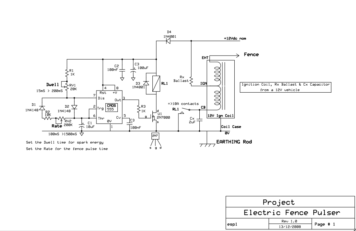

This is an example on how to control the duty cycle and frequency.
