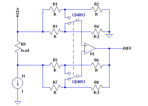

I see at least two potential problems:
1. The 4066 analog switch resistances will screw up the gain of the difference amp. I would set up two separate gain networks, with a dual 2-1 analog mux choosing one or the other of them. This will avoid passing current through the switches, so the resistance will be irrelevant.
2. The output of your Adder amp will be overdriven until VDIFF and VCAL are nearly equal. You will have to protect your ADC from this overdrive, if you haven't already done so.
Also, be aware that the common mode gain of the AMP03 (< -80dB) can cause an output offset at VDIFF of (12V/80dB) as much as ±1.2mV. This should be removed by your cal procedure, so long as it is short-term stable (it probably will be). If common mode gain varies between cal and measurement, it will cause errors.

The equal resistance of the analog switches should keep the common mode rejection high, but they introduce gain errors. Below is how I would implement gain switching.

A quick question.
Wont the unused Resistors come in parallel with the ones utilised when the mux switches one way?
I hope you get what i mean
A quick question.
The unused side of the bridge (as drawn, that would be R5-R6) only affects the gain to the extent that it adds a little more current to the load resistor. It does not affect the closed loop gain of the op amp.
Basically, R5+R6 are in parallel with R7+R8. This parallel combo creates an error current. You have to decide if you can make the resistor values large enough to make this error insignificant.

On the CD4053, what voltages are you using for VDD (pin 16), VSS (pin 8), and VEE (pin 7)?
You need to show polarities of measured voltages. VCAL should be negative.
Looking at U4 as an example, you have something wrong with either the op amp, grounding, or your measurement equipment/technique. Is this built on a PC board? Do you have a ground plane? Can you post a photo of the circuit board?
The VSS and VEE of CD4053 are tied to Ground.The VDD=+12v

CD4053 connections were correct before you changed them. CD4053 was connected correctly to supplies, and is not rated for 24V Vcc-Vee.
Ground routing techniques are critical in millivolt circuits. Even a ground plane may not be adequate. Parasitic ground resistance may have excessive voltage drop due to power supply currents or even signal currents.
