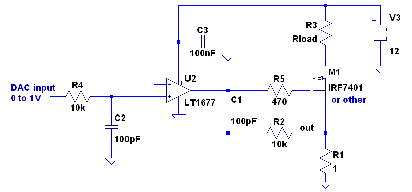

You're correct about the dual supply.
If you can get LT1677, I think will work well for you. Linear Technology says they have five in DIP8 packages for US $2.80 each.
See attachment for schematic.
Hi and thank you so much for the information Roff :)
I am checking on availability for this part here.I hope i get it.
What all precautions i need to take while designing the board for this?
Thanks and regards
EDIT: LT1677 is not available :( the supplier asked me to check with LT10xx .I am checking this.Maybe you can throw some light.

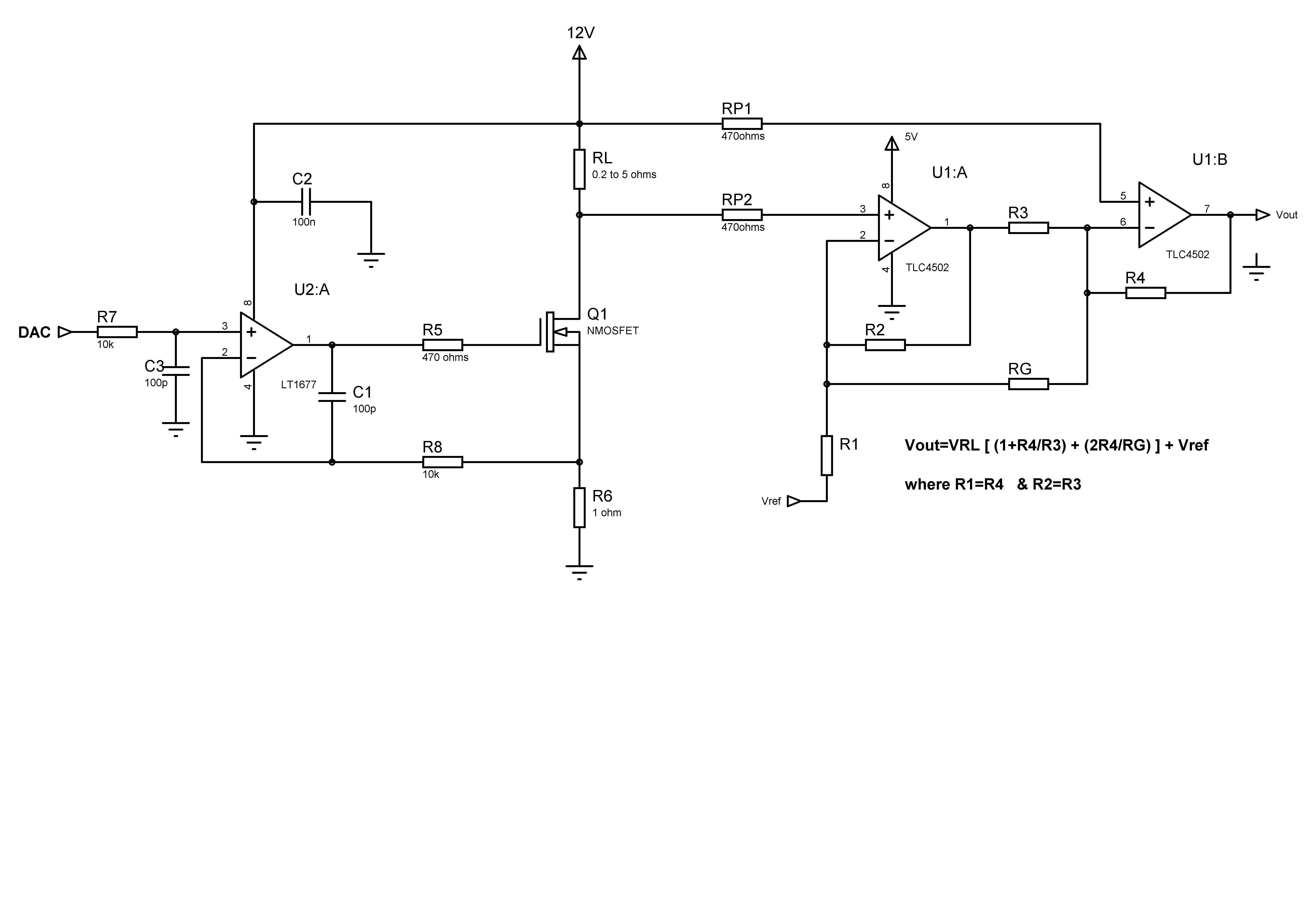

Hello again
I have added a schematic of my design here.
There are several blocks,of which i have shown two blocks.
One is the CC source as mentioned by Roff (although i am yet to decide on the op-amp part in place of LT1677) and the subsequent is the differential instrumentation amplifier using TI TLC4502 (the parts which i have).
My intention: The RL load is a resistor having a temp.coeff (50 to 180ppm/C)
Initially i have to calibrate the circuit.For this I will pass a set current for a very short duration of 10ms.I will get the differential voltage by passing it through the diff. amp.The samples will be averaged in an ADC and stored.The stored value is then converted to an analog value with a DAC (not shown in scheme)
Now during actual test, the current will be the same as used in calibration but with larger time (say 500ms).The stored analog value of calibration is set as Vref (not shown in scheme) through the DAC to another stage of op-amp (not shown).Due to larger time for which the current flows ,the temperature of the Rload and thus Resistance changes so voltage drop also changes (above the calibrated value).
This change in drop is in microvolts.Which needs to be further amplified and measured with a 12 bit ADC for 2k samples.
I have used the application circuit mentioned in the TLC4502 datasheet Page23,Fig.37
The diff.amp. in schematic has to have a gain(A) of 1 since i only need to get the differential voltage across the Rload (RL) and further amplify the difference between the set calibrated value and the time modified value (as mentioned above) to maybe A=1000.
If you check the formula for Vo then for A=1 i get nonsense values for the resistors (i only need Vo=VRL)
What is wrong?:confused: Am i doing something wrong here?
Sorry for the loooooong post :eek:
Please get back
Thanks and regards
You are trying to run the inputs to the TLC4502 at 12V, but it has a 5V supply. The input range of the TLC4502 only goes up to Vcc-2.3V=2.7V!

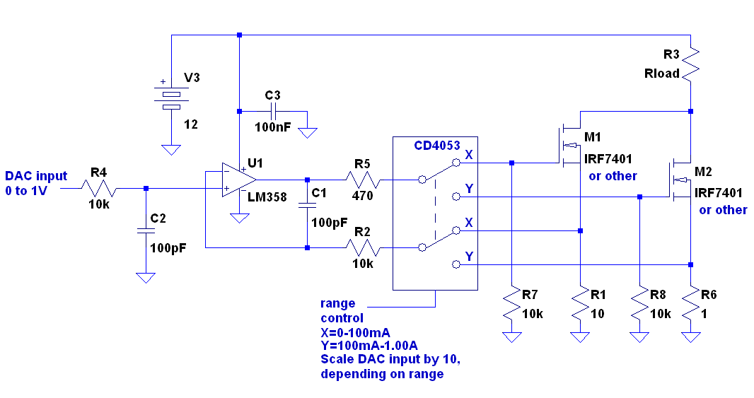

How are you controlling this circuit? Are you using a computer, or a microcontroller?
Is there dead time between current pulses?
If so, I have an idea that would allow you to use a less exotic op amp.

Here's the idea for using a less exotic op amp. Since op amp input offset voltage causes a bigger percentage current error when the current is low, we use a larger value sense resistor on the low range and scale the DAC output up by a factor of 10. This might also allow you to use a lower resolution DAC.
If the 3mV offset of the LM358 is still too high, we can probably find something that will work that is actually available.

Sorry had missed the schematic..Hard to see on a mobile phone :) Now your post makes sense.Forget my comment about DAC scaling..
But anyways i would prefer a normal approach using a low offset opamp.
Thanks Ron for replying.I dont think thats a very good idea. Since the maximum scaling i can get is 3.3v from the onchip DAC.I can use AD620 as mentioned earlier.Also this is half the problem addressed.Can u read my long post where i explained whats the bigger picture?
As I said, you scale the DAC to the range. You never need more than a volt at the op amp input.
I read your long post. I'm trying to address one problem at a time. As I read it, your calibration scheme does not eliminate the input offset voltage problem.
You r right.The calibration scheme does not eliminate offset problem.The only other thing is that i need currents till 1amp
Sorry, I was thinking you said 500mA max. The circuit with the switched sense resistors will go 0 to 1A with 0 to 1V in from the DAC. I changed the note on the schematic to reflect this.
Is 300uA max error at 50mA acceptable? If so, the LM358 will work. If not, there are other op amps available with lower offset voltage.
