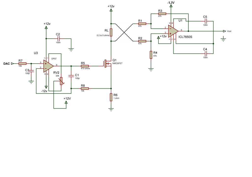

I can use a single ended supply for ICL7650S, right?
(V+=+8v , V- =0v or GND)
With the low i/p impedance circuit i don't get any voltage at pin 6 (o/p) .
(the same problem with file upload)
Ok now i changed the resistors on the ICL7650 to 4K7.
With these values i do get a linear differential voltage across the load resistor..but i have a huge offset of around 60mV at pin6 of the opamp :(
The resistors are all 1% MFR .I also tried varying the gain on the inverting terminal by replacing R3 by a multiturn preset.But that doesnt help.
As i see ,ICL7650 quotes almost zero offset voltage.
Is something wrong????

Why did you choose 8V for the second power supply? this won't work. You need to use the 12V supply here also. The input common mode range of the ICL7650 will not support the use of the 8V supply.
You need to swap the input connections for R1 and R2. As drawn, the output will have to swing negative, and you don't have a negative supply.
Also, keep in mind that the output can never get all the way to zero without a negative supply. I would probably create a low negative supply for the output amp. An LM337L running off the -12V supply could create -1.2V, which would be sufficient. Mind the minimum load current requirement of the LM337L.

Well i used OP07 for the current sink since the resolution for current is 250uA which is within limits of OP07 and its cheap.
the 7650,i read, has max supply of 8v.And you say that 12v is the correct voltage there.I dont understand!I have tried swapping inputs and i can get the change.I will try some more tomorrow.

I did some changes.
I added a -1v supply on the pin 4 of 7650.And 12v as recommended on pin 7.
With this i got negative saturation at the o/p pin 6.So i changed the gain of the inverting terminal as in figure.With this i can adjust the o/p voltage to zero at no i/p differential.
But now i can get wonderful voltage variation with the current flow.
I hope what i did is correct
Resistor tolerance causes a differential gain error, and an offset error due to the commom mode input voltage. The offset with 1% resistors and your 12V common mode input can be as much as ≈ ±240mV. It should not saturate your op amp.
You can correct for the common mode offset with the "preset" pot you added, but it will not correct for gain error.
If you want to learn something from this, I would encourage you to calculate the common mode and gain errors. If you understand op amps, you can do this yourself.

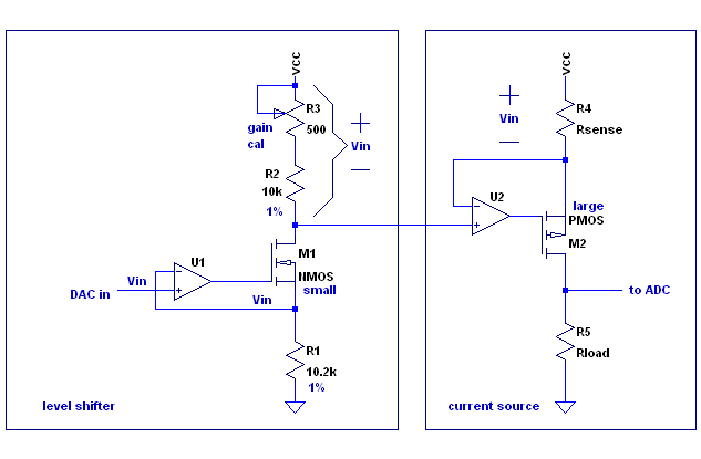

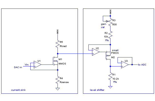

Below is a block diagram of the idea I mentioned earlier. If Rload is low (you said <5Ω, IIRC), you shouldn't need a buffer amplifier, and you definitely won't need an output level shifter.
Another idea would be to use the current sink you have now, and use a current source as a level shifter, as in the attachment.

I have to pass a current value initially for a very small time (10ms) so that there are no temperature dependent coeff. changes in the resistor load.This drop across the resistor is saved as ref.cal. value.After this,the same current ,is passed for a longer duration.The resistance change and subsequently the voltage change is noted (above the ref.cal. value).This voltage change will be in micro volts.This has to be amplified and read in a 12 bit ADC.
With my existing circuit i am proposing some more amplifier stages (my ADC is 3.3v max and the max drop across the R will be 5v) to make an auto-ranging ckt.
I am finding drift in the o/p of my 7650 over time.Maybe this is due to Differential gain error.I will look into it.

I suspect that the component most susceptible to drift is the 1 ohm current sense resistor. What type of resistor are you using there?
Pots are also suspect in my mind, especially if used as a rheostat, as in your differential amplifier.
If this were my project, I would probably use the current source version that I posted. I would avoid the differential amplifier, unless it were monolithic, like AD8276.
I would also make the actual measurement as soon as possible after the calibration procedure, which should minimize drift problems.

If I understand your calibration procedure, when you subtract the cal value, that will (I think) also subtract all offset (but not gain) errors in the measurement chain. Offsets will still show up in the initial current magnitude measurement, so if that's important, you will need to use low-offset amplifiers. For example, 50mA will give you 50mV across the 1Ω sense resistor. 1mV of offset in the input amplifier will cause 1mA of error. You can't compensate for that unless you are using a high-precision, low drift sense resistor.

In my current sink schematic, I added a frequency compensation network consisting of resistors and capacitors. I determined their values empirically, by simulations. You may need similar compensation in the current source circuits to prevent ringing or oscillation.
