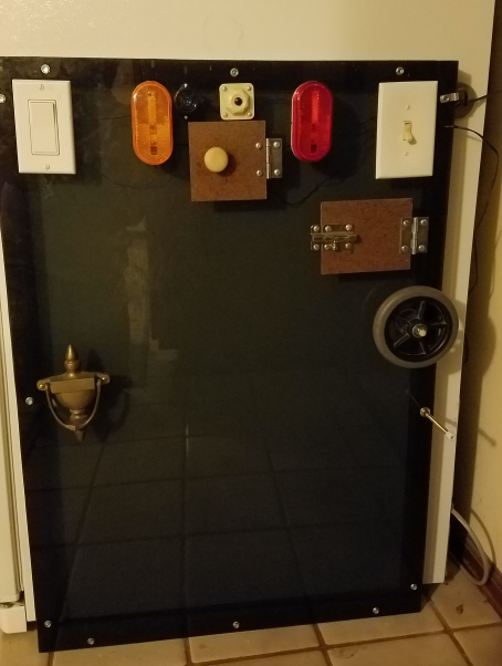

I am building an entertainment board for my niece. It will have all kinds of things for her to play with and develop her motor skills on including various types of latches and locks. I want to include an assortment of four LEDs and three small motors that spin her favorite cartoon characters each activated by a different type of switch (toggle, rocker, temporary push button, key activated, chain pull...) . I have the carpentry part down and everything is mounted but I don't know the best way to wire them to a single battery pack.

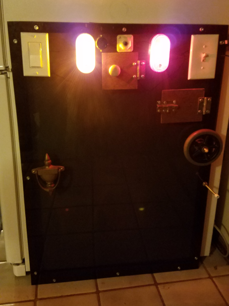

For my Grandson:
Powered form a 12 volt wall wort. (power supply form a small rechargeable drill)
Lights are for cars. Safe voltage.
Door bell. Button switch and buzzer.
Two types of switches.
Two colors of lights. Red & Yellow
Two types of doors. One has a mirror inside.
Door knocker.
Spring Door Stop, Makes a funny noise when you pull on it.
The wheel is from a walker. Fun to spin. Now he pretends to drive.
Attaches to the side of the refrigerator. Made from smoked plexiglass.
The plan is to add one thing every week. Now the weeks are 30 days long. ;)

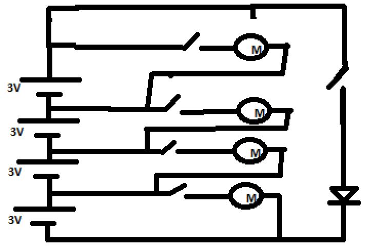

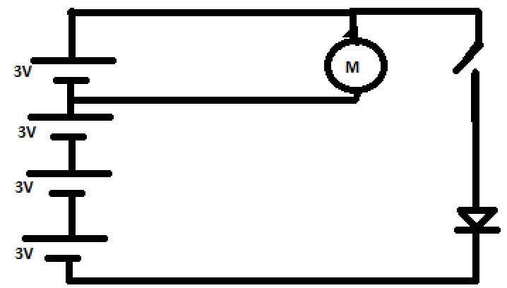

3V or 12V ?? Do what is best for you.
With 3V motors I think a 3V battery is better. (two 1.5v batteries or two 1.2V rechargeable)

You can use LEDs for lights (with 3V)
Or this,
So each motor only see 3V but its one battery per motor so they all have about the same loading and life.
The LED sees 12V as its across all 4 batteries.
