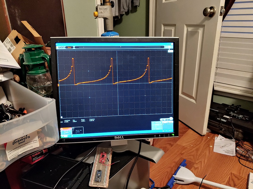

I figured that out I should get a ramp up but my scope rolls up.

Yep it works but its not a ramp it rolls up.
The FVR made it worst. So this is what going on Im sending the 32 steps but it's maybe not getting all of the bits right.

When you say "it rolls up", what do you mean? Something like exponential? Is there any capacitance involved?

It looks like there is too much load on the pin. The datasheet states that the output must be buffered.
Edit, the resistor ladder uses 5k resistors for a total of 160k.
The input of your scope should be in the Megohm range. Do you have anything else on the output?
Nope lol it was the pickit3 unhooked it and now it looks good.
that was dumb the pickit was loading it lol

Do you have a high impedance meter? If so, try setting the DAC to 15 and see if it reads half the supply voltage.
It's working now I move the output to pin RA2 I didn't think about loading cause I'm using a scope the pickit was loading RB7
I now have a nice wave 0 to 5.10 volts
