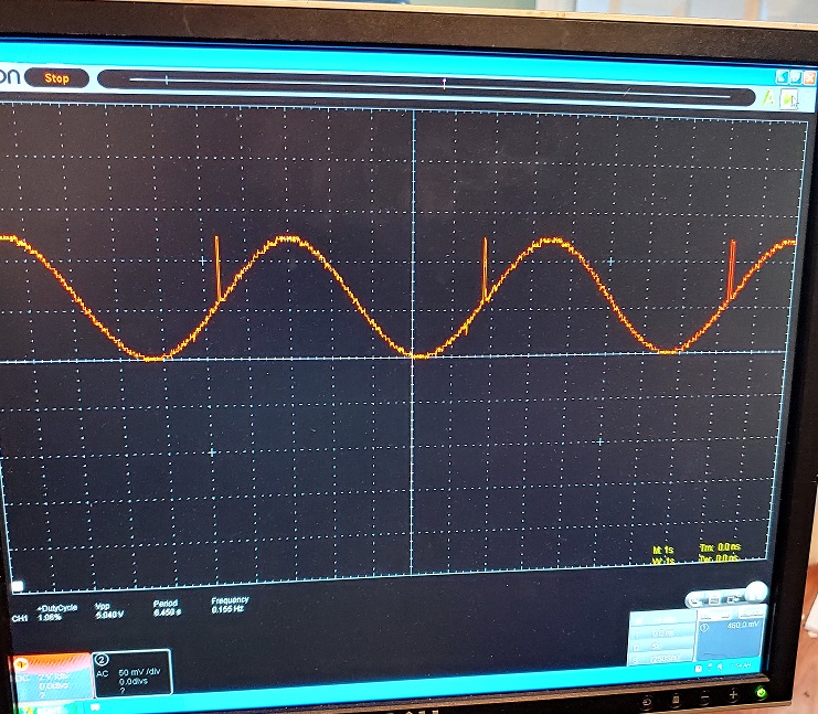

Well i got back to playing with this for some reason you can't use 0 to 128 as the count it has to be 0 to 127.
here a picture of 0 to 128 not bad.
shows the spike from count being 128
And here count is 127
You must be having a bad day :D
0-127 is a count of 128, 0-128 is a count of 129 - so exceeding the limit of the 128 bytes of data.
For a 5 bit D2A it's not looking bad though.
Yep I kind of thought of that after I posted but it really not bad for a 5 bit D2A

Note that <128 is the same as <=127 unless the variable is signed.
In the first code posted the type was byte and in the second uint8_t. So maybe byte is signed - unit8_t (which I much prefer) isn't.
