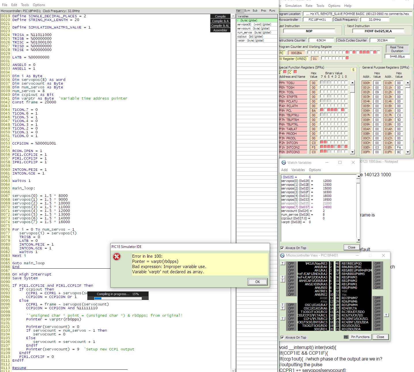

I just tried an artificial interlligence app with a section of CODE to translate. What do you think?
C

If the pointer stuff works then that translation looks pretty good.
In addition to the pointer code it gets the following two statements wrong:
            CCPR1+=FRAME-servoPos[servoCount];
and
            If(++servoCount>=NUM_SERVOS){
                servoCount=0;
and
                servoCount=0;
Hi T,
It's been busy all day, so I haven't been able to finish the resto of the CODE.
I think I can see what those 2x lines are trying to do, and I hope to correct them.
Thanks.
C
Yes, it just needs a little tweek to,
CCPR1 = CCPR1 + FRAME - servoPos(servoCount)
Weird how it got += right in other parts but wrong in this part.
I also thought that,
                servoCount=0;
was wrong. However, in the conversion the increment is done in the else part,
      If servoCount = NUM_SERVOS - 1 Then
        servoCount = 0
      Else
        servoCount = servoCount + 1
      End If
One other thing, MPLABX (spit,spit) has CCPR1 defined as a 16 bit variable (word) and treats it as one. Does Oshonsoft do the same. There are three definitions for CCPRx, CCPRxL, CCPRxH (both 8 bit) and CCPRx (16 bit).

Here is the whole translated program, including the AI explanations of both sections of CODE.
I'll have to start again in OSH and try to get it to compile, while looking through suggestions and the AI explanation.
(There may be clear errors in this post, ignore for now)
I may be a while ;)
C
I get that, but the comparison is wrong... it translates to:
 if (servoCount >= NUM_SERVOS) then
     servoCount = 0
endif
If non incremented servo count = 7 (servoCount-1) then it should go to zero else be incremented. That's what both those pieces of code do. The >= was me being lazy.
It could also do,
     servoCount = 0
endif
But it's actually less efficient as it always increments servoCount.
For A.I. I think it did pretty well.
Edit, servoCount has to go from 0 to 7 which is what it does.
Here is the full AI (Artificial intelligence) program, combined with MI (mediocre intelligence)
I have looked at how POINTERS work. Is the POINT in this program the same, so it points to updateable addresses where the timings are held?
The program compiles without the commented out line [ Pointer = varptr(rb0pps) ]
NOTE the readings so far.
I haven't added the above comments yet, or given it much thought apart from copying it parrot style.
C
I see you've defined varptr as a byte. I (think) it needs to be a word as it will point to anywhere in RAM (SFRs).
I also see you didn't correct the line, CCPR1 = CCPR1 + FRAME - servoPos(servoCount)
BTW, can you post stuff (code) as text rather than an image?
Hi M,
I changed [ varptr ] to WORD , It still shows the ERROR on #177 image.
I don't know how to correct the [ CCPR1 = frame - servopos(servocount) ] but i'll give it a try.
Is the POINT the same as OSH POINTER, where values are in set array of memory locations?
I usually post the CODE, but in this case I was showing the ERROR and the watched variables.
C
The error says it's not defined as an array.
Try,
dim varptr() as word
Edit, that won't work, It'll just be an array of words not a byte pointer. Do you have a link to somewhere that discusses pointers?
