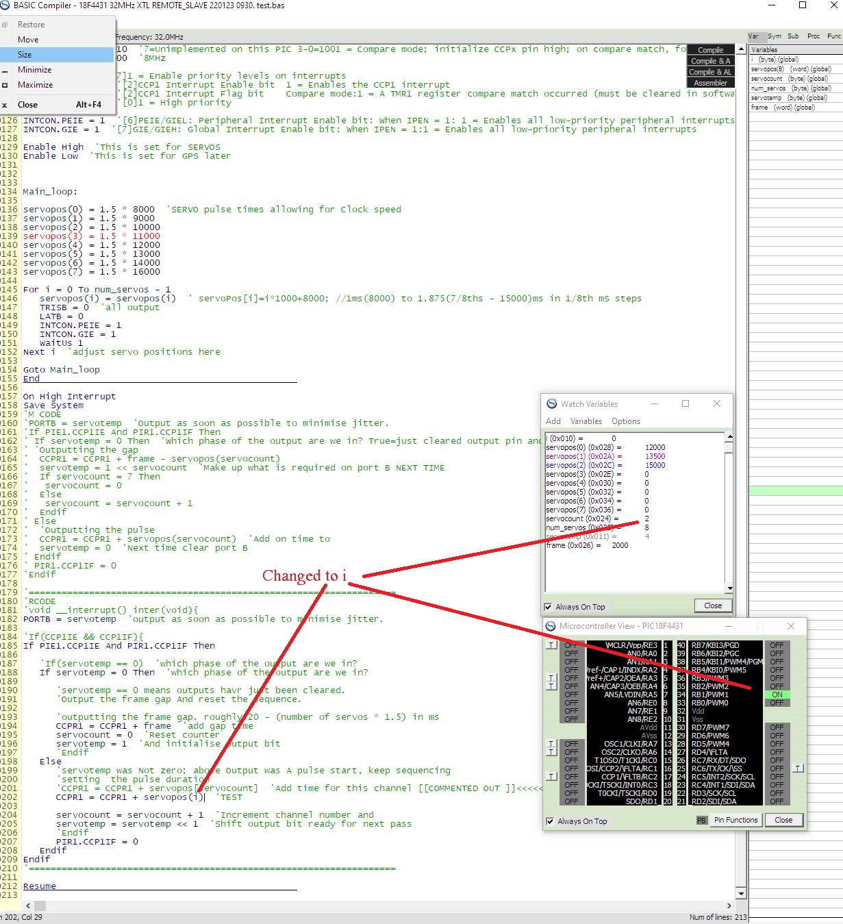

#188
Hi M,
Here:
C

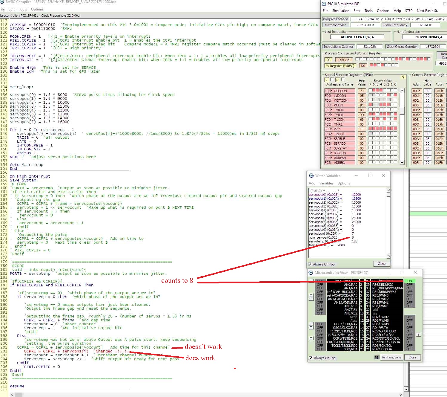

This only applies to Timers, CCP values don't increment.
OK, if the CCPs don't use the high byte latch, then order is irrelevant.
However your code from post #188 is still messed up so the "AI" translation is not going to produce working BASIC.

        CCP1IF=0;
"servoTemp" can never be zero as you are constraining the left shift to 0-7 rather than letting it shift endlessly after initialisation.
servoCount is being incremented during initialisation rather than the pulse sequence.
servoTemp is being forced to zero every time it hits the "}else{" section.
An attempted fix:
C:
void __interrupt() inter(void){
    PORTB = servoTemp;        //output as soon as possible to minimise jitter.
    if(CCP1IE && CCP1IF){
        if(servoTemp==0){    //which phase of the output are we in?
            // servoTemp == 0 means outputs havr just been cleared.
            // Output the frame gap and reset the sequence.
            // outputting the frame gap. roughly 20 - (number of servos * 1.5) in mS
            CCPR1 = CCPR1 + FRAME;                     // add gap time
            servoCount = 0;                         // Reset counter
            servoTemp = 1;                          // And initialise output bit
        else {
            // Servotemp was not zero; Above output was a pulse start, keep sequencing
            // Setting  the pulse duration
            CCPR1=CCPR1+servoPos[servoCount];       // Add time for this channel
            servoCount = servoCount + 1;            // Increment channel number and
            servoTemp = servoTemp << 1;             // Shift output bit ready for next pass
        CCP1IF=0;

Hi R,
Here is my OSH translation:
Check IF---ENDIFs
NOTE: [ ' ] = commented out.
This line doesn't compile, otherwise the CODE attached compiles:

I changed SERVOCOUNT to [ i ] and now it compiles and runs.
It now can count to [ 2 ] so that's an improvement :) then it stops counting.
C

Hi R,
With "Dim servopos(10) As Word" (no [ ] ) it now counts to "8" as the image shows. then resets to "0"
This line doesn't compile, so I changed it to CCPR1 = CCPR1 + servopos(i), which works.
It appears to be working, in the SIM, I'll now try it "live"
C
