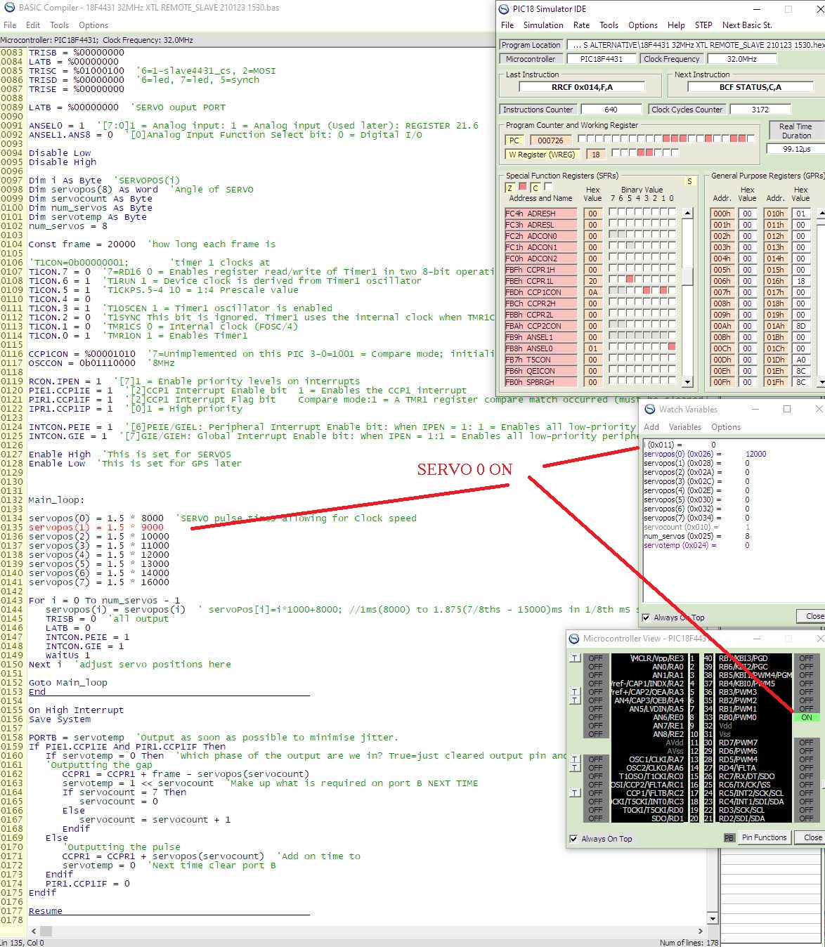

Hardware ESC 8xSERVO CONTROL on PIC (Oshonsoft BASIC)
The error says it's not defined as an array.
Try,
dim varptr() as word

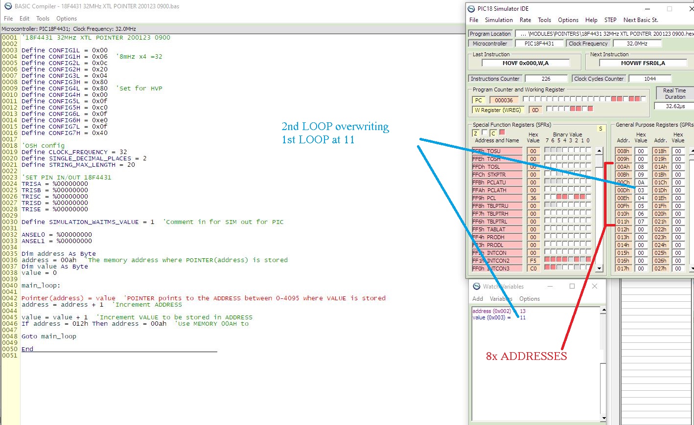

Edit, that won't work, It'll just be an array of words not a byte pointer. Do you have a link to somewhere that discusses pointers?
Hi M,
Here's where the original #INCUDES would be handy ;)
I couldn't find any reference to POINT, but in OSH it has POINTER.
I wrote a program that appears to work using POINTER.
NOTE: Even though I wrote it, It will take me a while to understand how it works, especially in the SERVO program o_O
C.
I've updated the program and commented it the best I can.
I'll have to go through it a few times, while getting used to POINTERS, and try to check the comments are correct.
It compiles, so now I can watch it in the SIM :)
I can see errors e,g [ ccp1out ] plus others, but that's it for today.
Here's the program:
C
  • 18F4431 32MHz XTL REMOTE_SLAVE POMMIE BASIC 200123 1300.bas

I thought the chip you're using didn't have PPS so this code can never work. Does your chip have RB0PPS?
I had some time today so rewrote the code using a similar chip to the one you're using. I only had an 18F2620 available but that is from a similar time to the one you're using and, most importantly, doesn't have PPS and seems to have similar SFRs.
Here it is,

The interrupt has the main changes. It precalculates what is output and immediately outputs that to port B to minimise jitter. The maximum jitter should be 1 clock cycle (125uS). I also avoided using += etc. so hopefully the A.I. you used might produce working code.
Edit, and NO pointers too.

Here's the compiled program today:
It switches the first SERVO on then doesn't INTERRUPT again.
There maybe mistakes!
C
  • 18F4431 32MHz XTL REMOTE_SLAVE 210123 1530.bas

Hi R,
This is the first run through of P's CODE after A.I., and I've only copied it, and not looked at it, so I can compare it with yours yet. I think it is supposed to be a faster version, so as to not jitter. The one I tried previously, which I think was your, jittered once I added it inot the FULL program, so I'm interested to see if this one is different.
I'm looking at 'C' and it's more difficult for me, as I'm not a CODER, although some rubs off each time.
As for editable text, Iposted that along side the SIM view in #196.

Hi R,
If this is the same as #68, then as mentioned earlier, it jitters once it is added into the FULL program, so I am now trying M's just to see if works without jitter, once added into the FULL program, which will take me a while.
Yes, it needs SAVE SYSTEM, as mentioned I only copied it as best as I could till it compiled, then posted it to see if M tells me it's as he intended. Then I'll add it into the FULL program, as I did yours, and see what happens.
If It looks like your program, then it's quite possible that I copied a section of yours by mistake, so this is why I have to wait for M's feedback.
Once it's been tried, and if it jitters, then perhaps you could re-look at it, and see if we can get it to stop jittering.
You posted your CODE, thanks, but I can only deal with one program at a time, and for me that's difficult.
C.
