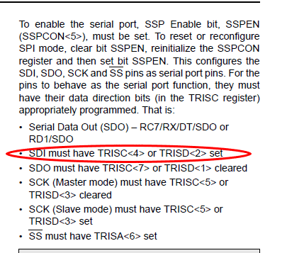

I'm sure I was advised to set TRISD to all OUT, can someone let me know if this is correct, and why, please?
I'm trying to add the SPI setting, and think they are clashing.
C
This seems to be the relevant bit in the datasheet,
