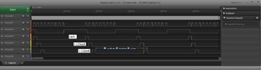

Hi M,
Quick test, no reset, back to bed.
C
That looks very promising.

As you can see it's working on the HW, but it no longer works on the simulator.

The logic trace looks correct but I don't understand why channel 5 is 1.122 mS when it should be 1.25mS.
I'm assuming channel 1 is the CCP1 output and that looks good. Can you check the timings of the pulses?
Each positive pulse should be 0.5mS long and the zero part should be the rest so servo 0 is 500uS, servo 1 is 625uS servo 2 is 750uS etc. This would give a time for servo 2 of 1.25mS (500+750uS) as noted in the first sentence.

I'm trying to sedn you the Analyser output so you can check anyhting.

I've emailed the analyser DATA
