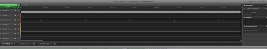

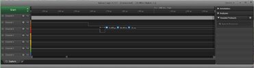

Hi M,
I swapped the 2x wires from my CODE over, and the wires themselves, and it shows the same as #435.
I tried your translated CODE from #389, and it produces this:
No CLK.
You were going to send your C CODE HEX, but I haven't received it.
C

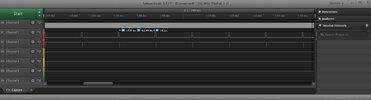

I've now got the logic analyser to work but don't understand it,
What does this mean,
The scale at the top suggests that the 0.235mS is correct but what is the 20mS and the 49.99Hz????
And how can channel 0 be the 8MHz clock, it looks more like 1.5kHz.
Hi M,
Is the 20mS and 49.99mHz the FRAME?
I looked again at an early anaysis #408, and there's both CLK and DATA, so the error appears to be my end.

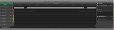

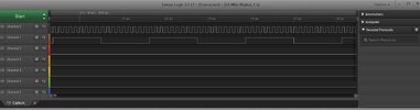

Hi M,
I had a few goes, and this produced this:
I changed 2x'wordtemp' to 'tempword' is this correct?
C

Assuming that channel 1 is the output, it appears to be something like 900kHz.
What happens if you keep the original code I.E.

The above is different to #444 as I edited that but didn't think it mattered as it (the BBS) said you'd not visited since the previous day. I added T1CON=1 which your code doesn't have so I guess you visited but weren't logged in.
Does the above make a 1kHz output on RC2? Note, the order of instructions is important. In this case it's important that CCPR1H is written before CCPR1L.
Generating a frame time will not work as it can be as long as 12mS (20-8*1mS) or 96,000 clock cycles and the maximum time that can be added in one go is 65,535 cycles. It could be done by dividing by two and adding it twice but the timer 2 interrupt shouldn't cause any problems.
Edit, I've corrected the typos. I.E. wordTemp.
Alternatively, timer 1 can have a prescaler of 4 which would give a frame time of 40,000 and servo times from 2000 to 4000. This would enable calculating a frame time.
We can try this if you like.
However, I would still like to know if the above code gives a 1kHz signal.

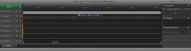

Hi M,
Here's #447
I posted #444 in #445 plus my edits
C

Hi M,
Yes, try which ever looks best.
EDIT: Ignore the gaps in 'CH0' for now.
C
Is channel one 1kHz, it looks to have an on time of 0.5mS which would be 1kHz but it's too zoomed in to tell.

Hi M,
Here it is zoomed out.
C

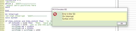

Here's my first attempt at an Oshonsoft version without priority interrupts.
'18F4431 32MHz XTL REMOTE_SLAVE 164 389 030223 1200
Define CONFIG1L = 0x00
Define CONFIG1H = 0x06  '8mHz XTL x4 =32mHz
Define CONFIG2L = 0x0c
Define CONFIG2H = 0x20
Define CONFIG3L = 0x04
Define CONFIG3H = 0x80
Define CONFIG4L = 0x80  'Set for HVP
Define CONFIG4H = 0x00
Define CONFIG5L = 0x0f
Define CONFIG5H = 0xc0
Define CONFIG6L = 0x0f
Define CONFIG6H = 0xe0
Define CONFIG7L = 0x0f
Define CONFIG7H = 0x40
Define CLOCK_FREQUENCY = 32
'Define SIMULATION_WAITMS_VALUE = 1  'Comment in for SIM out for PIC
dim servoCount as byte
Dim wordTemp As Word
dim servoPos(8) as word
dim frame as word
OSCCON = %01110000  '& h70
TRISA = %11000000   '7=OSC, 6=OSC,
TRISC = %11111010   '6=1-slave4431_cs, 2=74HC164 CLK, 0=74HC164 DATA
for i=0 to 7
  servoPos(i)=i*250+2000; '1ms(2000) to 1.875(7/8ths - 3750)ms in 1/8th mS steps
next
TRISC=0b11111010          'CCP0 (RC2) & RC0 output
servoCount=8
T1CON=0b00100000
T1CON.0=1
CCP1CON=0b1000            'will go low on interrupt
PIE1.CCP1IE=1
frame=1000                'start everything in 4000 cycles
INTCON.PEIE=1
INTCON.GIE=1
while(1)
                          'adjust servo positions here
wend
End
On Interrupt
Save System
If PIE1.CCP1IE And PIR1.CCP1IF Then  'Is it a CCP1 interrupt
  If CCP1CON = 0x08 Then  '& h8 Then  'have we started the 4000 cycle pulse
    CCP1CON = 0x09  '& h9  'yes so end the pulse after 0.5mS
    wordtemp.HB = CCPR1H
    wordtemp.LB = CCPR1L
    wordtemp = wordtemp + 1000
    CCPR1H = wordtemp,HB
    CCPR1L = wordtemp.LB
  Else
    LATC.0=0;
    CCP1CON = 0x08  '& h8  'No so output the timed gap
    if servoCount=8 then
      wordtemp = wordtemp - 1000 + servoPos(servocount)
      frame=frame-servoPos(servoCount)
      servocount = servocount + 1
    else
      wordtemp = wordtemp +frame
      frame=31000           '40,000-9,000
      servoCount=0
      LATC.0=1
    endif
  Endif
  PIR1.CCP1IF = 0
Endif
Resume
Note that in order to move a servo disable interrupts around it, I.E.

Hi M,
A few minor edits, shown 'EDIT<<<<<<<<<<<<
Here's FRAME and SERVO 1.
As a 1st attempt at OSH, you've overtaken me, after 4million ish attempts:)
C

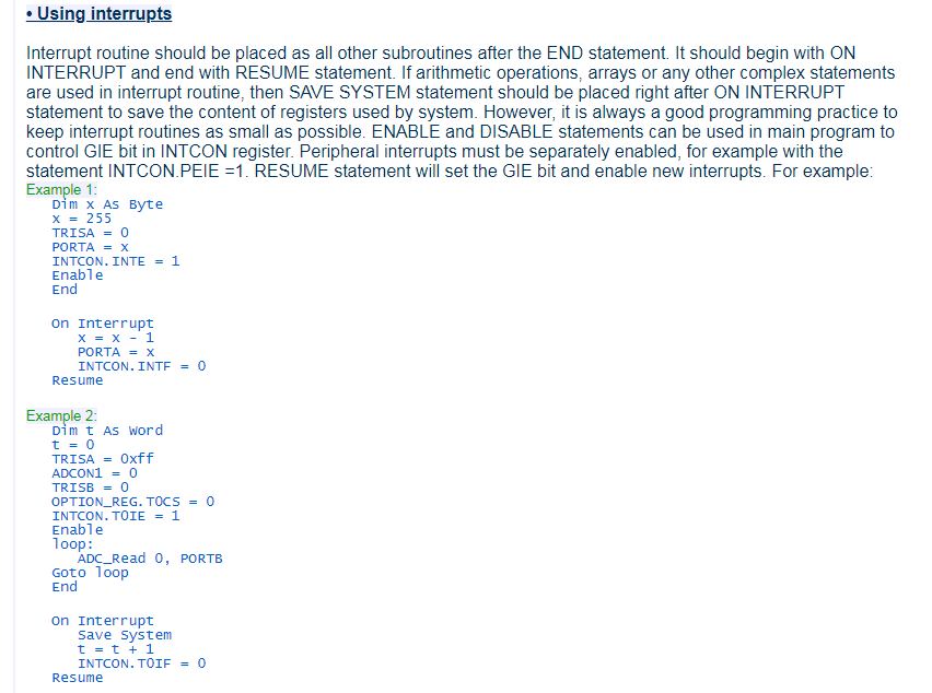

That looks pretty good except for the traces. The corrections to the code appear to mainly typos except for the line,
On High Interrupt
Why does it need to be on high interrupt, the manual suggests that normal interrupts can be used.
As there's only one interrupt it seems silly to use priority when there's no need.
Can you explain what the traces are in the diagrams? They look to be completely wrong.
On High Interrupt
Hi M,
Yes, the errors were mostly [ . ; ( ) ]
I don't understand the ON INTERRUPT error, but this CODE will be added to larger CODE, where a GPS INTERRUPT will be, which could be LOW INTERRUPT, so this is why I chose it.
The analyser traces:
CH0 is connected to the 8mHz XTL on the PCB.
CH1 is connected to PORTC.2 on the PIC
CH2 is connected to PORTC.0 on the PIC.
CH3 Shift register 1
CH4 Shift register 2
CH5 Shift register 3
C
