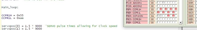

I've been busy, so didn't get an answer to your "can you confirm that doing CCPR1 = 0x55AA writes 0x55 to CCPR1H and 0xaa CCPR1L?" question.
The PLL is set in "'Define CONFIG1H = 0x06 '8mHzXTL x4=32: fcmen = off: ieso = off" (Comments can be checked in the #217 program)

'live' test of #226:
The SERVO goes to the CCW endstop and jitters wildly.
Comparing #226 with #217, I can see:
T1CON has changed
PIR1.CCP1IF = 1 Has been removed.
There are no SERVOPOS in the MAIN-LOOP
OSCCON is used, which is an internal oscillator (I'm not sure if this is needed for TMR1) In CONFIG1 it is set to Crystalx4.
C
