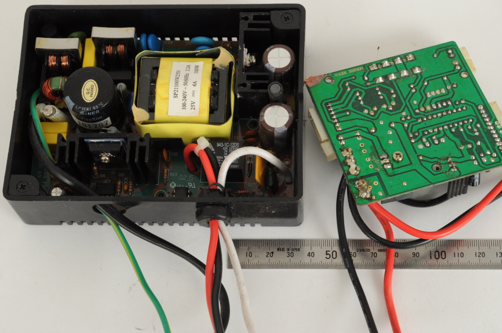

I recently bought a Hakko 933 soldering iron on ebay as I needed to be able to solder some large power supply wires and I only had an Antex 18 watt iron. As it is 50 watts I thought it should be man enough for the job. However, it would barely melt the solder. After downloading the instruction manual I realised that the little button on the side with 390 on it, controls the temperature at 390 degrees so it wasn't hot enough for the job. The manual shows they do a whole set of buttons for different temperatures but searching on-line, I have not been able to find anyone that sells them. The 933 has now been replaced by a new model with adjustable temperature. Does anyone know where I can get these temperature buttons? Thanks in advance, Steve.

This is what I am trying to solder/de-solder. First I need to de-solder the red and black wires from the power supply on the bottom left corner of the circuit board, then solder them to a connector. I couldn't seem to get enough heat into it as the solder was just re-solidifying before I could pull the wire out.

Your tip is probably too small from the photos. You need a large tip with large thermal mass to store more thermal energy since it gets sucked into the workpiece and drops the temperature of the tip because the heating element can't pump heat in fast enough. A really hot, small tip with a lot of wattage behind it either won't heat up a large workpiece, or will damage things before the entire piece comes to temperature.
Also, use rosin flux.
Thanks for the replies, that's really useful. I will get a bigger tip and some rosin flux and give that a go.
