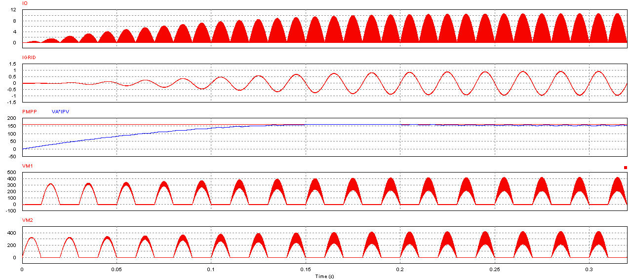

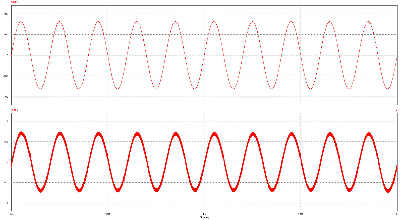

Grid Tie Inverter idea
Hi all,
I've followed this and the first one long thread about Grid Tie Inverter, because I'm a power electronic lover I've read a lot of IEEE paper on the subject in order to gain some detailed knowledge on this type of DC-AC conversion system.
As a first attempt I've simulated a simple schematic based on a single stage conversion system able to work with a single PV panel (my goal will be build a low power inverter and mount it directly on the back side of the solar panel).
This first schematic I've sketched is a full bridge topology with a line frequency transformer for safety reason, actually I'm try to build a didactical prototype, is not my interest to go into the commercial field, anyway is not difficult avoid the line transformer by using a boost stage between the PV panel and the output Full Bridge (this also avoid the core saturation issue detailed below into this post).
Here in attachement the converter schematic as I've draw and simulated inside P S I M and the image taken from the signal waveform.
The two block named MPPT and MONITOR implement respectively the MPPT algorith and the starting and functional sequence of the inverter operation from the power on to the steady state behaviour (this block was written in C language).
The panel choosed and modeled was a Inventux X3-115 (115 W, VMPP=125 V, IMPP=0.92 A, datasheet attached), the reason to use a high-voltage panel is to keep the current on the DC side of the inverter at a reasonable level, with this setup at the nominal 230 V grid voltage (rms value) the peak of the current trough the filter inductor was approximatevely equal to 3 A.
Actually this schematic is working correctly trough the simulation stage, may be into the future I'll build a real prototype.
The Power Factor from the simulation is equal to 0.967, this is due to the current loop control (the modeled sensor is a ACS712ELCTR-05B-T from Allegro). By using the current control approach the output current can track the sinusoidal reference which came directly by the PLL (in this way we can be sure about the grid current synchronization) and multiplied by a factor which came from the output of the MPPT algorithm. The used MPPT algorithm is a P&O and is able to track the MPP point from 200 W/m^2 to 1000 W/m^2 irradiation into the valid grid voltage range (here assumed from 195 V up to 264 V, all value is intended as RMS).

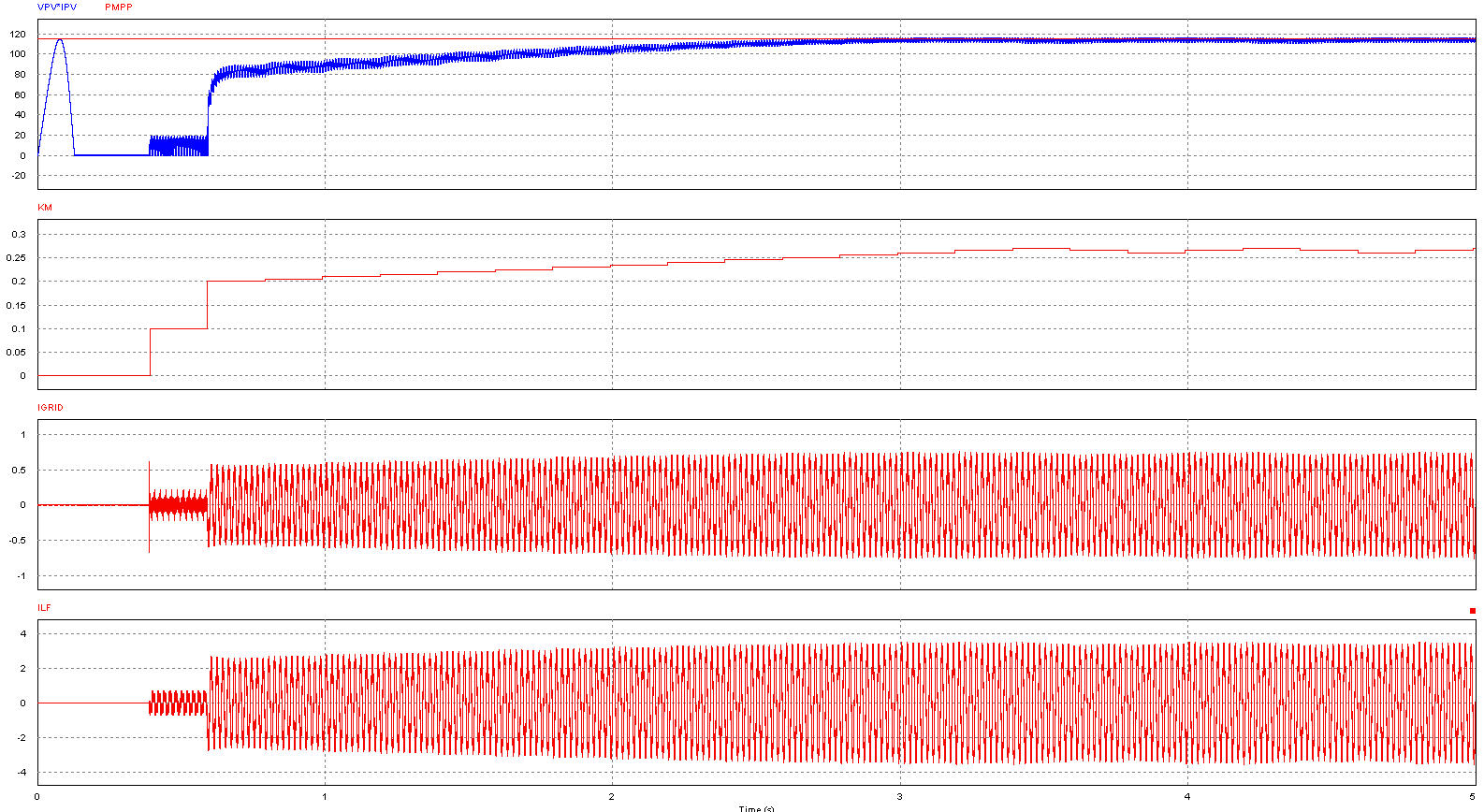

Back Panel Mount Grid Tie Inverter (may be the future ?)
Dear all,
here below I like to present another topology well suited for single panel mounting and able to manage small power up to 200 - 300 W, this type of solution is usually classified as micro-inverter grid connected solution.
Advantage of a such type of solution is that the low-cost inverter will be mount directly on the back side of the solar panel. This short the cable length needed to connect the panel with the inverter compared to a centralized solution.
Also using the local inverter on the solar panel allow some flexibility because I've just to put the power cord of the inverter into one home plug to inject power as needed without the need to install a fixed plant on the roof.
Of course everyone have different need and request but I like to present also this solution for people that need to inject small power into the house grid in order to save some money, e.g. when in summer we start to use refrigerator. Of course the solution is convenient only if the overall cost of the single microinverter is small compared the number of inverter we need respect a centralized solution.
Anyway a part of particulary use I think that also study small inverter is useful to gain some knowledge on this very amazing field of power electronics. I love power electronics!!!!
As usual you can find in attachement the schematic that I've drawn to perform the numerical simulation (P S I M) and the most significative waveform taken from the simulation output, also I've attached the reference paper where interesting people can study in a more deeper way the presented topology. Into the original paper simulation was carried on by PSPICE programs but there is no reference about the simulation schematic then I've rewritten it for P S I M, another simulation tool in order to check if my result was in agreement with the ones into the original paper.
Also into the schematic I've set some detail about the analog circuitry used to sense the grid voltage and to sense the solar panel voltage and current (this last trough a low cost shunt but to save some power loss we can also use Hall sensor like the ACS family from Allegro which is also a low cost solution). Grid voltage sensing is did in a not isolated way (PAY ATTENTION TO THIS) with a low cost operational amplifier. Regarding the control (see the section PWM Generator into the bottom side of the attched PDF schematic) there is a subcractor of 2.5 V (to avoid the 2.5V continuos introduced by the Grid Sensing circuitry) then there is a block that make the full wave rectification of the input waveform (may be build with a couple of simple operational amplifier) and then there is a multiplier. Regarding the multiplier there is several low cost analog multiplier into the market (SO8 package), the other input of the multiplier into the simulation was set as a fixed value of 2V, into the real life this input should be connected to the MPPT stage in order to modulate the peak value of the rectified sinewave and the achieve the desired output power level from the inverter. Again, interesting reader can study the attached paper to gain lot of useful information on this topology.
Main difference of this setup compared the previous one that I've posted (Post#47) is that there is no need to sense the output current of the converter, the only current sensor is on the solar panel side (I've also to say that literature have been proposed also sensorless solution to avoid the PV current sensor or the PV voltage measurement, but I think that this issues are more attractive just for accademic talking than practical approach, this is of course my personal thinking).
The behaviour of the converter is then more simple and well described into the attached paper, the most important things is that the Flyback have to work always in DCM (Discontinuous Conduction Mode fixed switching frequency) or in BCM (Border mode, at the boundary between DCM and CCM with variable switching frequency) and never goes into the CCM (Continuous Conduction Mode).

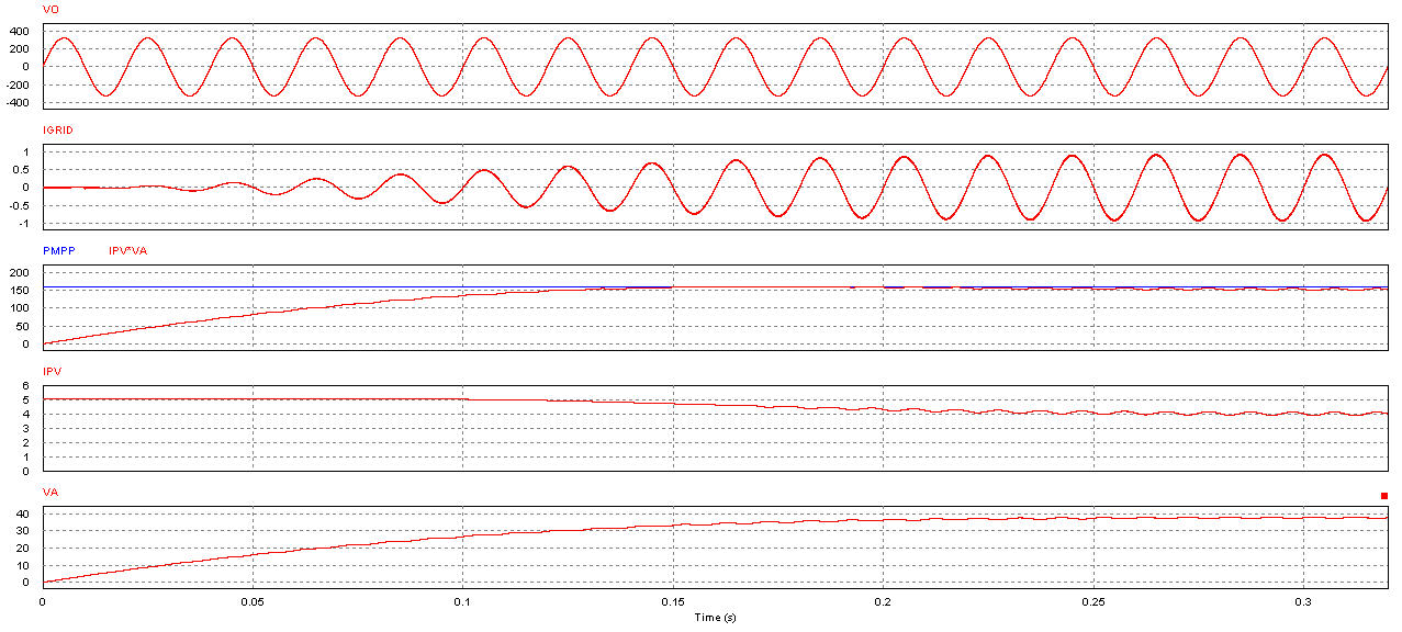

Flyback Grid-Tie design for 160W 35V solar panel module
Regarding a solar panel with PMP=160W and VMP=35 V I've recalculated the inverter parameter, into the attached schematic I've also drawn the circutry used to shape the rectified main reference voltage before feed this voltage to the analog multiplier used to set the output power.
Parameters for the solar module used into the simulation are reported below:
- VOC=42.80 V
- ISC = 5.15 A
- VMP = 34.9 V
- IMP = 4.60 A
Parameter for main is 230 V rms with frequency of 50 Hz.
As usual simulation schematic and signal waveform is attached.

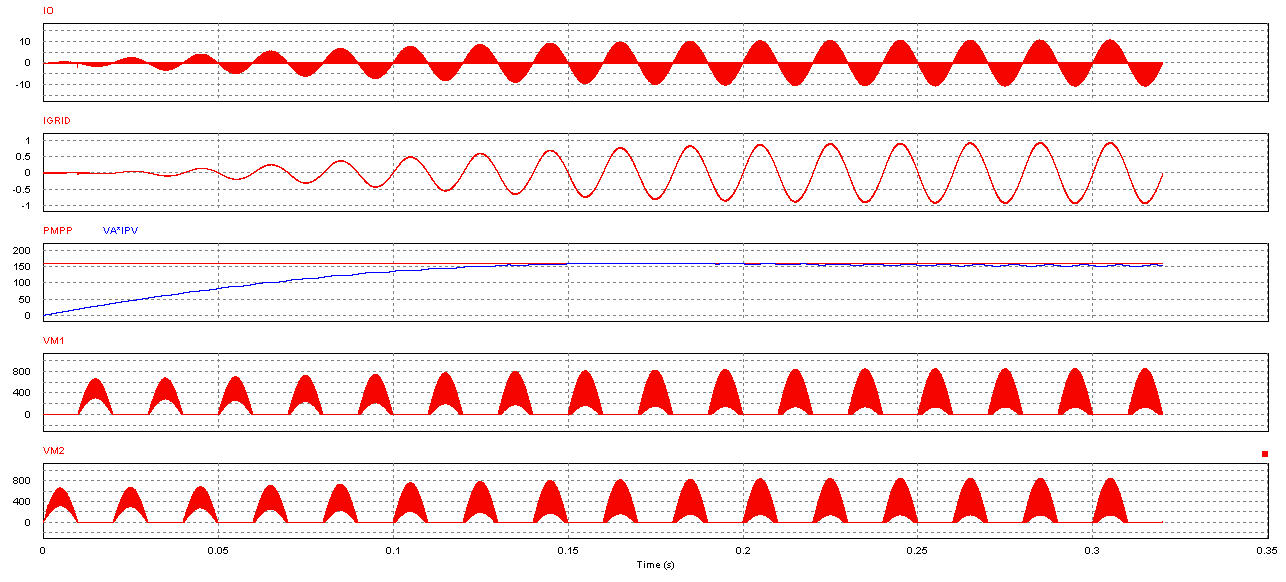

Flyback Grid-Tie design for 160W 35V solar panel module - a personal revisitation
Dear all,
basing on previous post topology we can understand that the diode and MOSFET build on every secondary of the Flyback coupled inductor act as a simple unfolding stage then we can change it to another equivalent one based on the full bridge topology. Reason to did this change is to reduce the voltage stress on the secondary MOSFET and also to simplify the building of the Flyback transformer. In this way the transformer is a standard one with one primary winding and one secondary winding, this also have a goal to reduce the leakage inductance between the secondary winding and the primary winding and this is more simple to build in a home made fashion than a double secondary windings type.
Voltage stress in each MOSFET of the full bridge is the half of the previous section then a lower BVDSS voltage MOSFET can be used with the advantage that also the rdson is lower than a MOSFET rated for a greater BVDSS voltage.
I've to admit that this is a my personal elaboration of the IEEE paper schematic and may be useful to make a semplification into the prototype without the need to ask manufacturer for a custom wirewound transfomer that may be expensive.
As usual in attachement you can find the new schematic and the simulation result which is identical to the previous schematic based on the center tapped windings.
