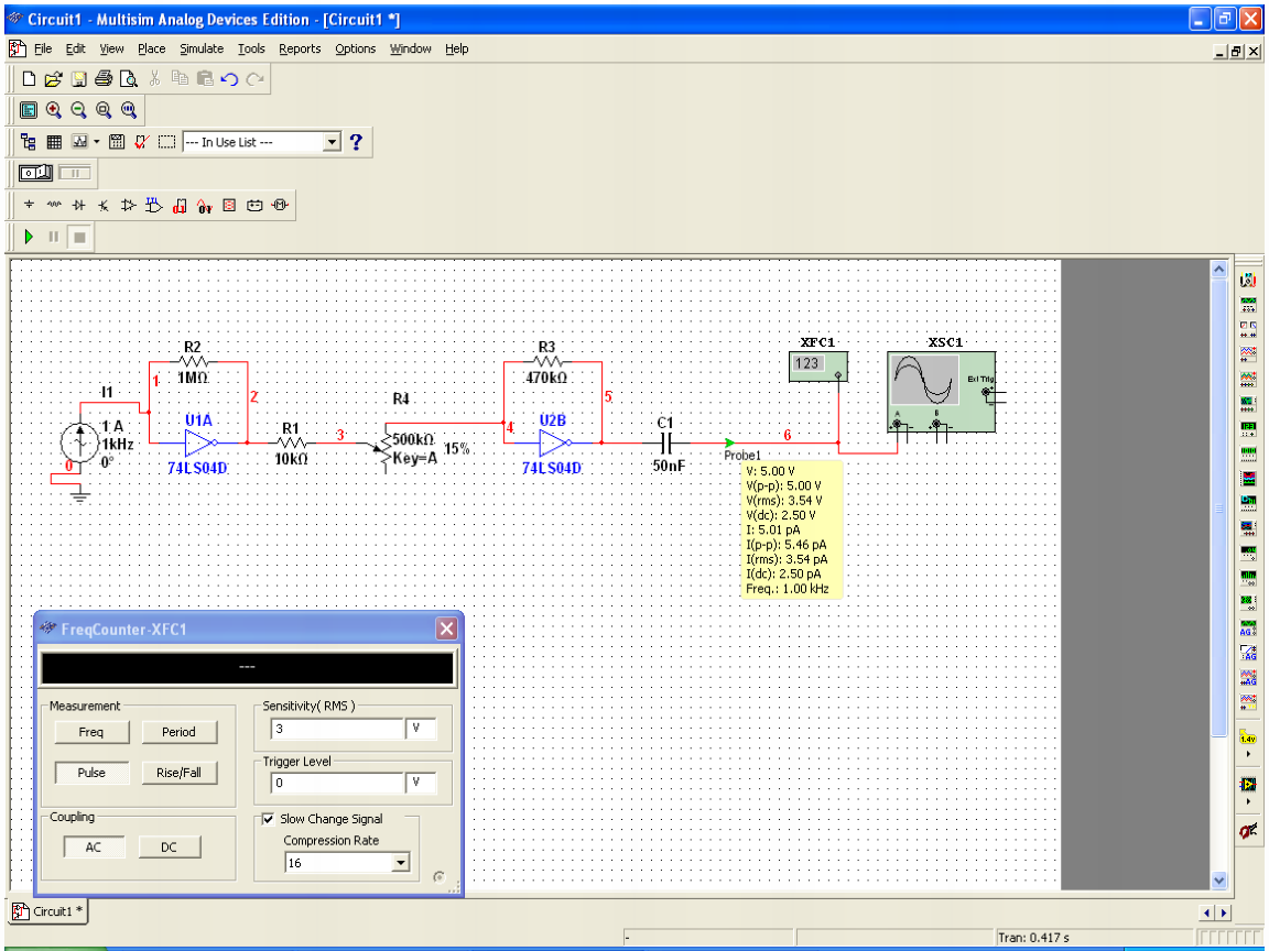

If adding two more occilators as Audioguru suggested (using the leftover 4069 hex inverters) what componet values suggested.
I can't get a simulation to work to determine the frequency output and forget using any math on this end (I just don't get the hang of math)

attempting to sim the oscillator section to see what values to order but ??

I found this example
have no clue what values to use etc.
original schematic was for a guitar pedal?
R2 was 5M changed to 1 M witl little difference in frequency output but then I may have wrong type of input etc??
someone who knows about filters may have some thoughts??

R2 was 5M changed to 1 M with little difference in frequency output
Your last circuit uses TTL logic ICs that have a very low input impedance. The original circuit uses Cmos logic ICs that have an extremely high input impedance.
Your circuit with the TTL ICs will not work the same as the Cmos oscillator and is not an oscillator.
Multisim dosn't have a 4069
used what it has for description purposes=sorry for misinformation mistake.
just go with what I have then??
just contemplating the leftover 4069 sections??
