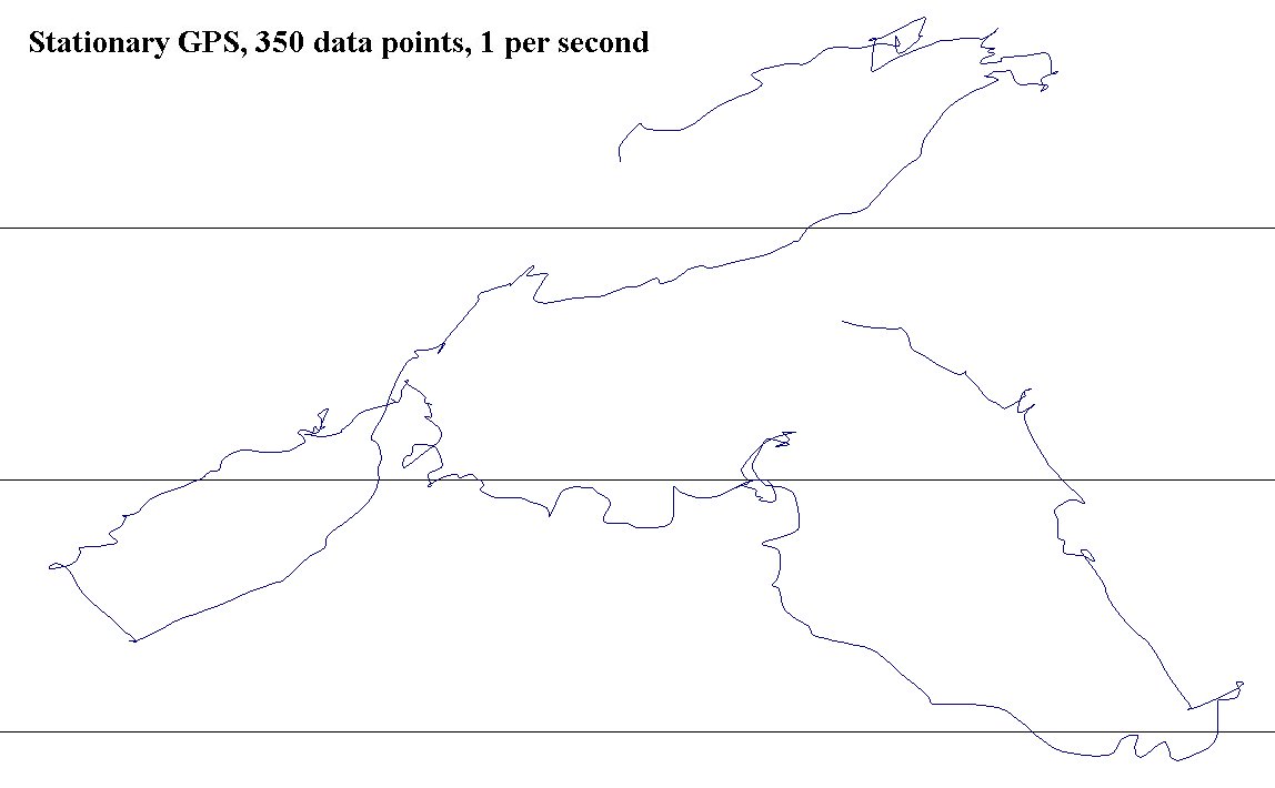

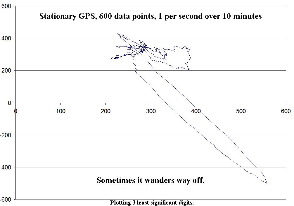

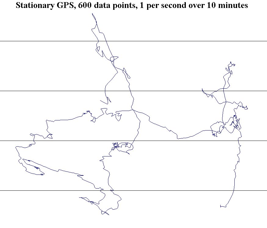

Just out of curiosity, I tested this GPS Module with Ceramic Antenna for DIY Handheld Positioning System for $7.86
https://www.dx.com/p/open-smart-gps...ino-apm2-5-flight-control-480918#.WiDKElWnH4Y because without moving, the Latitude & Longitude numbers go up and down independently. It seems like it is wandering around but stays within a 25 feet diameter circle for the most part. I guess that is pretty good trying to triangulate my location from 3 or more moving objects in space.
That is not good enough for a GPS controlled lawn mower.
I took a few sets of data with a Stationary GPS sampling once per second then plotted the 3 least significant digits in Excel.

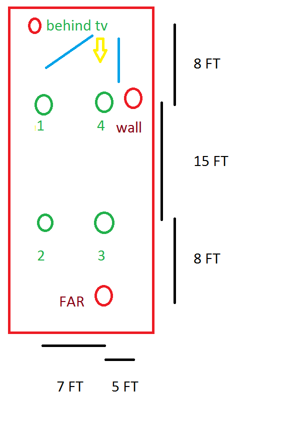

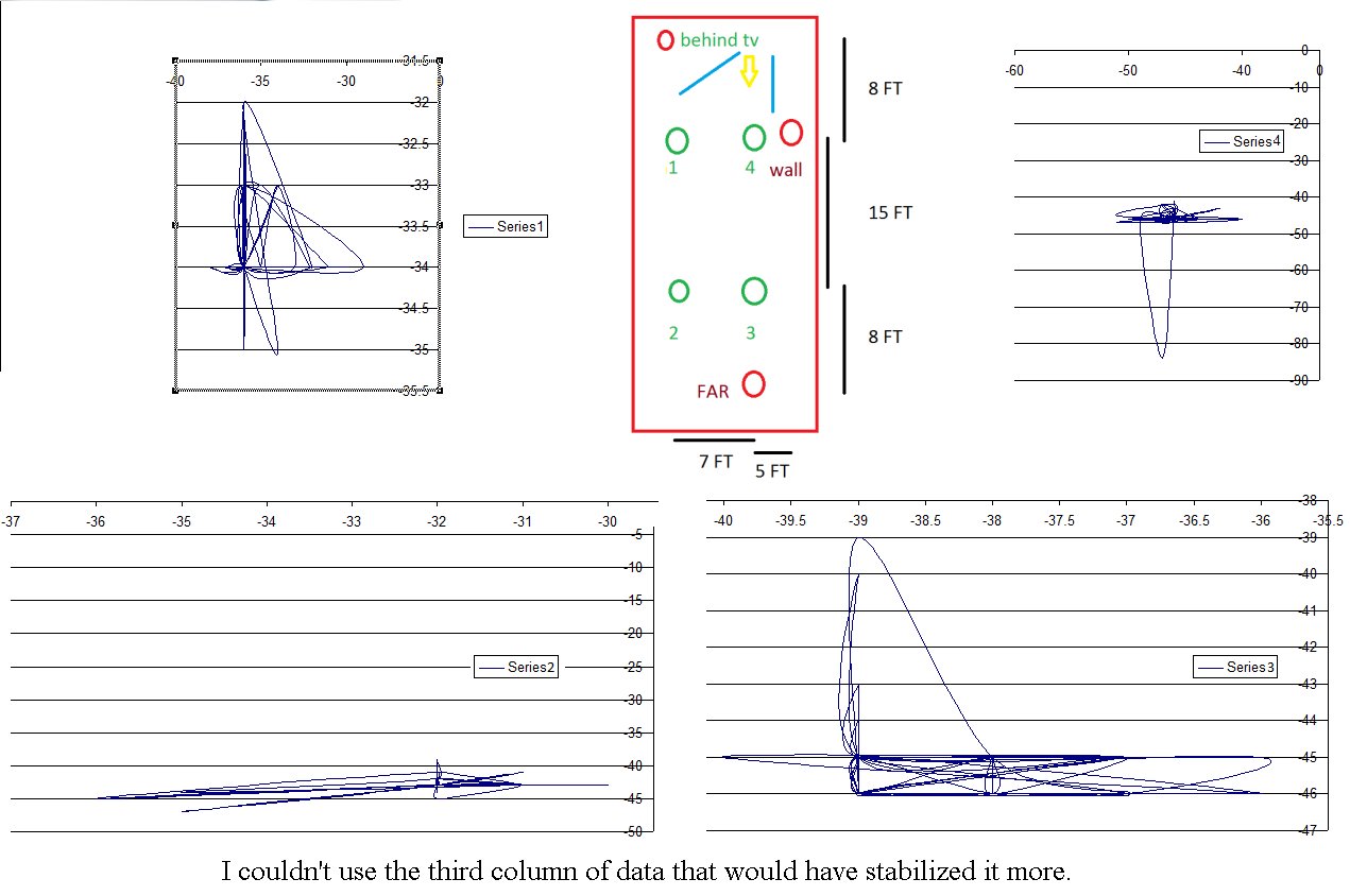

So i wrote an app to pole the RSSI from 3 extenders at the same time ... running unpaired to any network. I would like to mention that due to the limitation of the android SDK my samples were taken at every 5 seconds ... however I think a faster polling from arduino would yield the same results.....
1)The first test was a linear test on a single extender done on a concrete floor with lots of objects all around to cast noise and reflections .... the phone was in a stationary position for the polling.
2)The second test underneath the first one was also a linear test on a single extender but elevated about 3ft from the floor ... notice at the 3ft mark was a coat rack which caused an offset at that point. also there may be bouncing from my unsteady hand holding it.
3) the following 4 tests to the right of the first two is a 20 sample triangulation between 3 extenders with a stationary device at 4 different points. The map illustrates the positions and distances involved.
The forced columns are just random numbers I wrote in.
The rar file is a spreadsheet with the results.
THe red are the extenders .
the green are testpoints
the blue are tv
the yellow is me!
tests were conducted at the same height within themselves
SO..... still think it would not work well enough??
That might work if you map it to the lawn and average it. The third column of data that I couldn't use would have stabilized it a lot.

Dual GPS readings wandered independently by 0.00420 minutes or more of longitude, which I calculate to about 25 feet.
That was fun setting up one GPS, Arduino, wireless transmitter combo to send position info to a GPS, Arduino, wireless receiver combo that sent both GPS positions to the PC.
Its not close enough to work with so I won't bother plotting the difference.
Are you going to try dead reckoning with wheels odometry + GPS next? Seems that would stop the GPS from running wild. How badly do lawmower idler wheels slip?
I think that is beyond me right now. I have rotary encoders, ultrasonic, accelerometer, magnetometer and other sensors. You never know. Seeds planted in my head tend to grow. Maybe I will watch for a better GPS. It looks like GNSS is better but way expensive.
