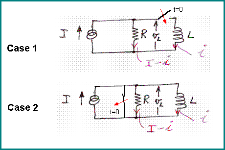

Because of the current cource, which cannot be open circuited, I drafted two cases for an initial condition.
The diffficulties only occurs when t=0.
There is no need to open or short the current source.
The current source is a step function that goes from 0 to I at t = 0.
I(t) = I u(t)

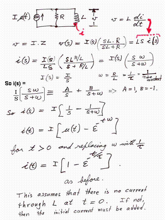

This is clearer if you solve the problem using Laplace Transforms. See attachment.
Len
