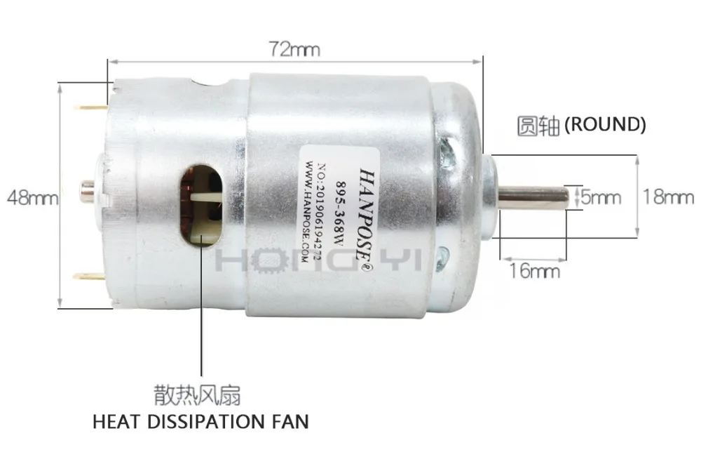

thanks for replies. No sorry that title was for another post. I corrected it. I got 12 of these to make a 6s2p 24v battery pack for a e-bike with a 24v 895 dc motor, which draws 1A with no load, but it's rated for 10-20A. It's quite a small motor, but it should have a maximum torque of 10kg.cm
