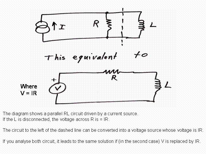

okay len,so if u have current source in parallel RL we convert it to equivalent voltage source in series with R.
So we have 2 resistors and an L in parallel with one of them.
Yup?am i getting it right?
See the diagram
Len

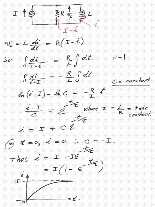

looks like my doubts never end,eh?am sorry abt that really..
:roll:
so when i write
for a parallel ckt with current source
I=Ir+IL
I=Vs/R + 1/L int V dt
(int is integral)
but int V dt is a ramp that means current is going to infinity.
so how do jot it in equation form then?
Your maths is wrong. See below
At t = 0, all of the current goes through the resistor.
But as t -> infinity, all of the current goes through the inductor. (we have assumed that it is a pure inductance, ie. it has no resistance). Therefore, as t -> infinity, the inductor represents a short circuit acroos the resistor.
Len
