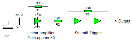

Here's how I would do it.

Hi, which type of a single-input opamp is that?
Also BTW I modified the circuit so now I have a dedicated +6.7V rail (for V+) and a dedicated -9V(for V-) rail supply.
I'm using the CA3130 opamp which has a maximum voltage rating at 16V p-p.
I'm using it in the non-inverting amplifier configuration with R2 at 2K and R1 at 330 Ohm, giving me a gain of about 7.

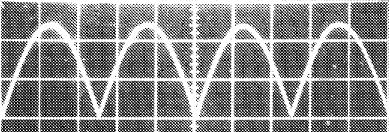

I remember getting for this Vin as 0.68, thus Vout is at 4.76V. And it does show this voltage across the Vout pin on the opamp however when I hook up this output and the ground to the oscilloscope I get a waveform similar to this: untitled.JPG
It has V p-p that fluctuates somewhat between 8-11V. The frequency the receiver is picking up is just over 1MHz, with a period of around 800ns. When I move my hand up and down the waveform does not respond at all.
if I don't have the ultrasonic receiver connected to any opamp at all but simply via clips directly to the oscilloscope, when I move it I can clearly see the amplitude change in relation to the distance from the transmitter. Also it shows fluctuations from 40KHz A(above it and below). *But* when this is connected to the opamp I don't see these results (the waveform doesnt respond when I move my hands up and down - it just stays still) even though amplification has been made.
So what might be happening here?? :confused:

The extremely old CA3130 opamp oscillates at about 1MHz when it has negative feedback and no phase compensation capacitor.
Maybe your wires at the inverting pin are too long and they pickup an AM radio station.
