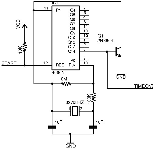

I'm trying to make a fairly accurate external timer to use with my microcontroller that expires 1/2 second later using low-priced parts. I have come up with the following schematic:
would this schematic cause the crystal oscillator section to stop working when output Q14 is high? or do I need to instead connect the NPN collector to /PO or the xtal?
